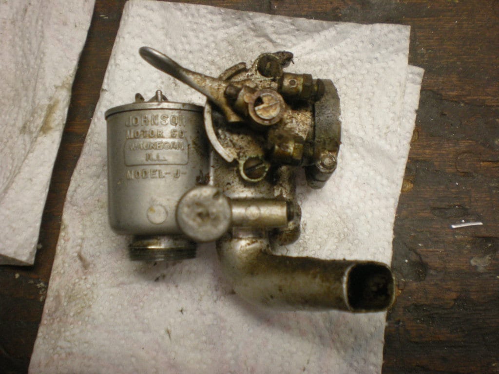

      Does anyone have any information on the Johnson model J carb float height? This one is on a 1936 model 100.
      #201381
        If there’s not notches on the float pin that fix the cork in place,
        then I guess I’d just adjust the float on the pin so it has about
        a 1/4″ of travel and doesn’t hit the top cover.
        Had mine apart, but can’t remember more than that!
        DSCN6399
        #201400
        Steve Martin
          I found another needle that has a groove so all is good.
