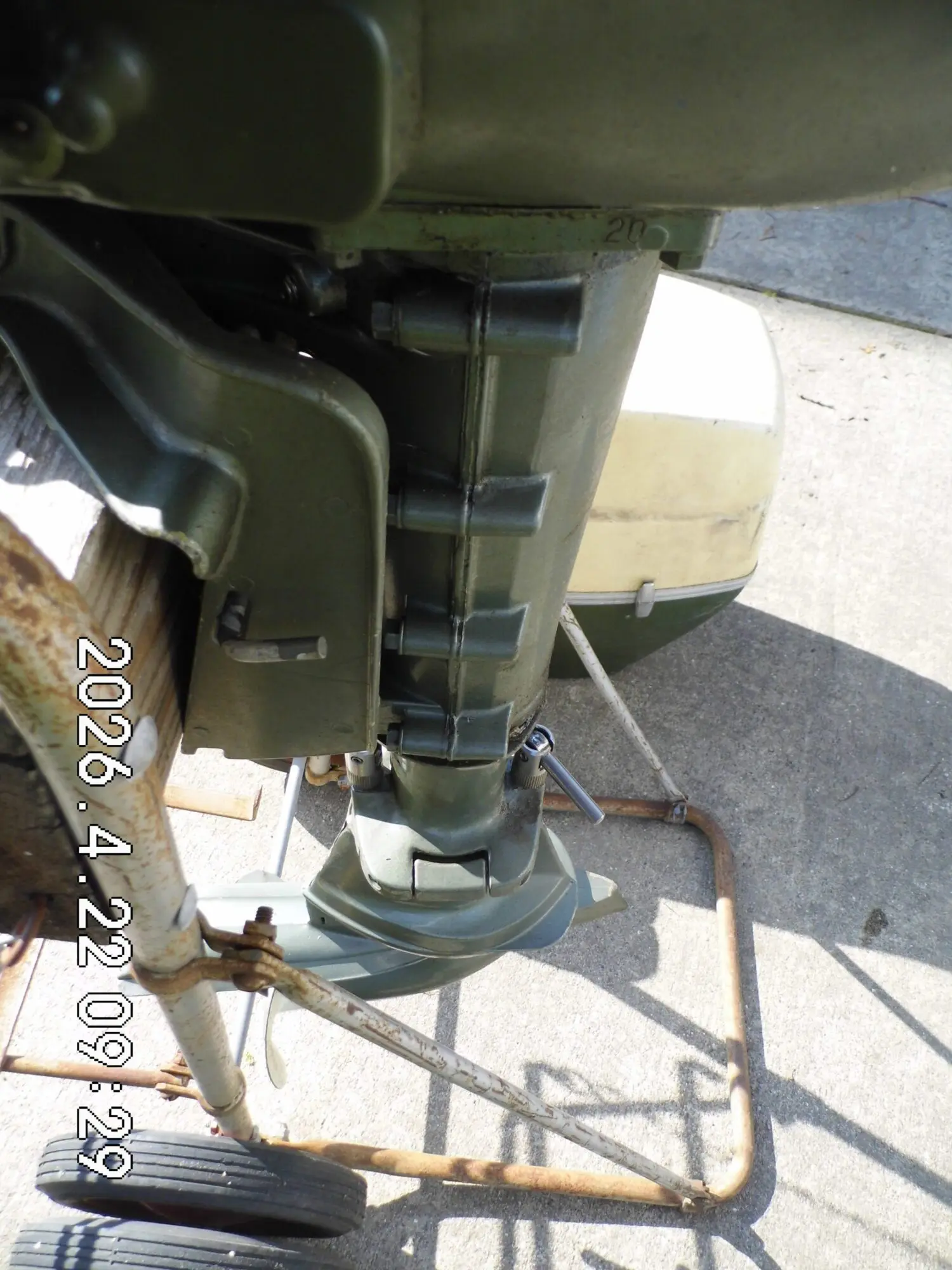

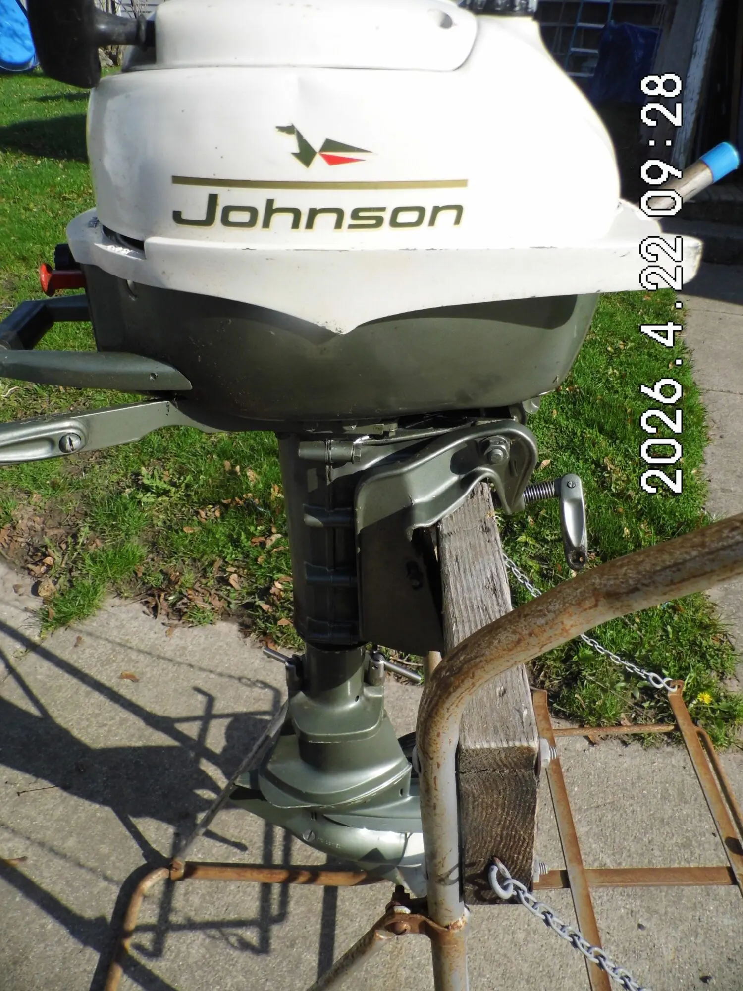

    I picked up a Johnson model MJWF22C with the case and was wondering how to change the spark plug it looks like I have to take the whole thing apart to get to it.is there an easy way to change it? Thank for your timeSANY0003

      Just remove those 4 flat head screws below the white band, under the tank….that will let you take off the lower cowl… Nice motor
          Is there a screw in the carrying handle that must come out also in order to split the lower cover apart??
          #316330
            And yes indeed, this is a nice motor….  Please be very careful with the case, they are delicate and will break/crack easily, especially with age.  You must be very careful about how you pick it up/set it down as well.  That little tip at the bottom of the gearcase skeg can be very delicate, very easy to snap it off.  Once that piece gets snapped off, the gearcase will no longer clamp in the folded position….
