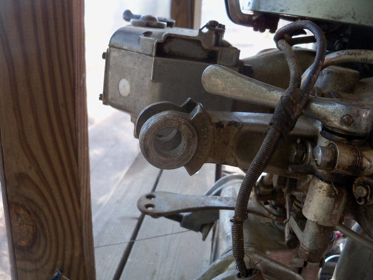

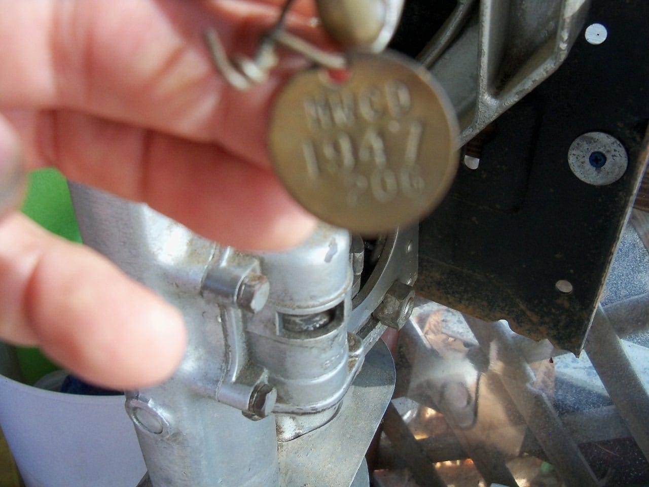

      There are 2 wires coming out from under the flywheel. What are they for? It also had a tag on it that says MWCD, 1947, 206.

        The two wires would have gone to a plug connection to hook to the kill button
        in the tiller handle.

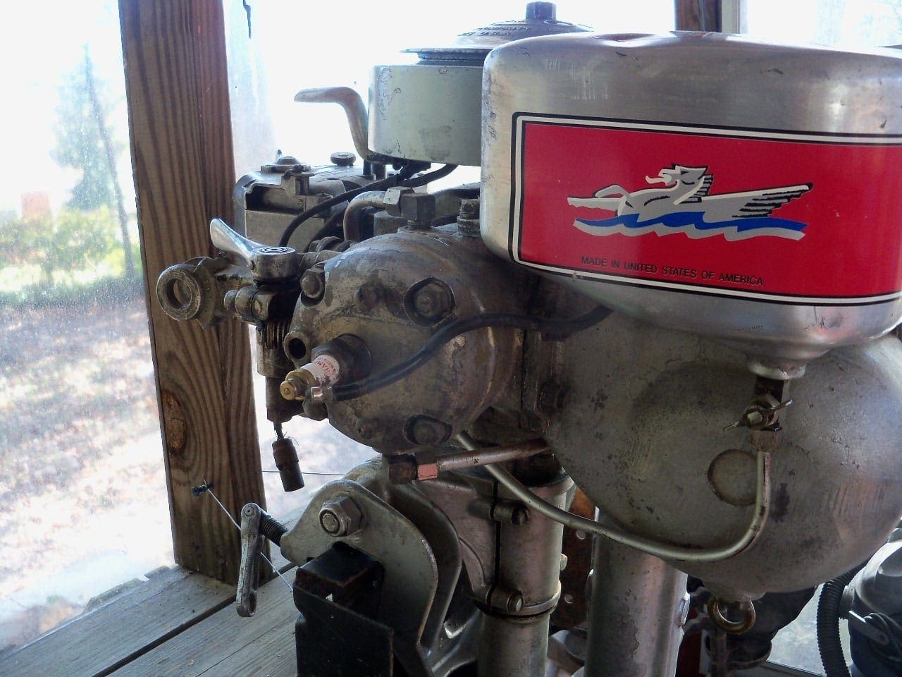

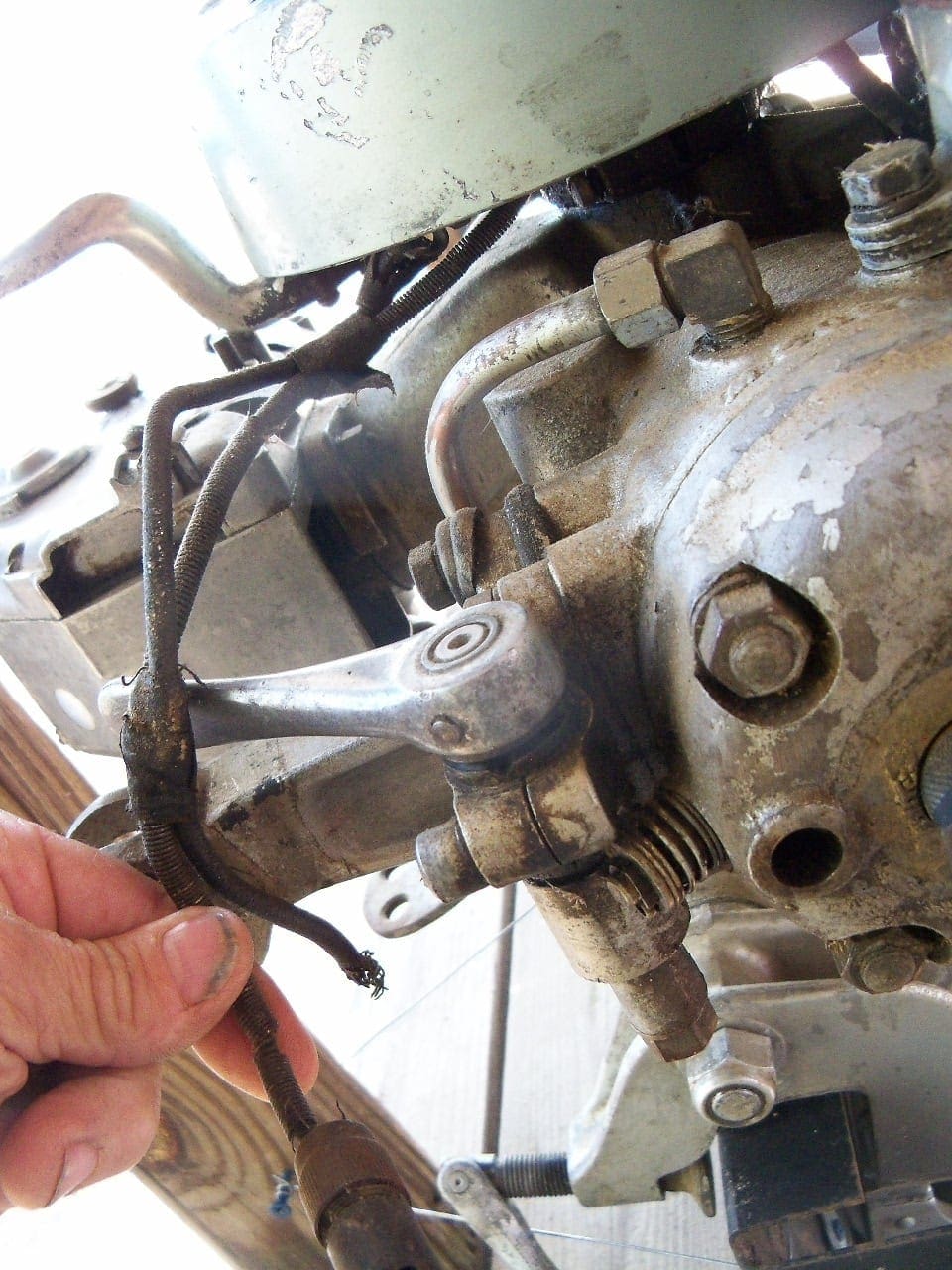

            There is no tiller handle and I am missing one of the covers for spark plug.

            #187389
              The disconnect plug for the kill switch was like an “old time” extension cord plug.
              Mine was missing, but I found a NOS antique plug online.
              There should be a tiller handle “out there”. Did you try a free want ad on this site?

                  If you’’re running it with out a tiller,just wire it to any simple on off switch.Completing the circuit grounds the points and kills the motor.
                  #187397
                  TOM GOEPFRICH
                    The tiller handle has a push button on end of it. To kill motor just hold button in until flywheel stops turning.

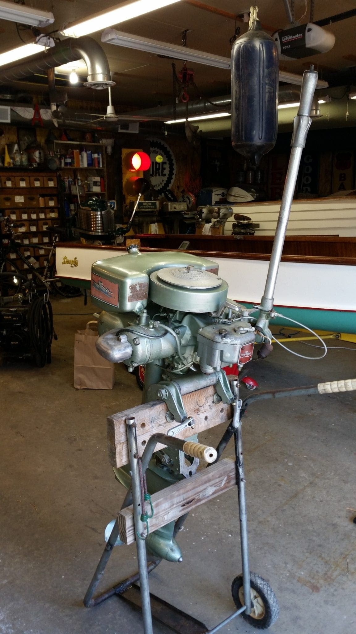

                      20160414_171621
                      Here’s someone else’s PO-15 with an original looking plug
                      and tiller kill switch. My kill switch was broken, so I made
                      one with a new button switch and a piece of brass threaded
                      in the lathe.
