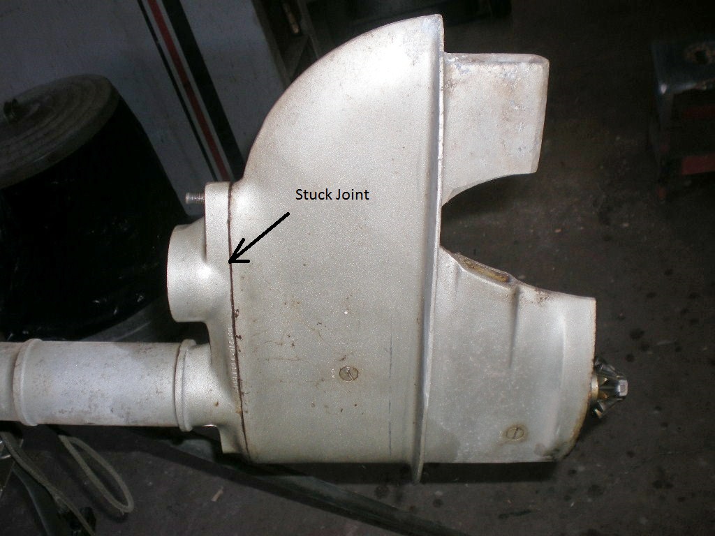

      Decided today to take the lower unit off the PO-15 for
      inspection. I removed the three nuts and was able to
      get the gear case off, but not the piece above it,
      that contains the lower drive shaft, bearings, etc.
      Am I missing something?
      In looking at info, it appears that it has a two piece drive shaft,
      therefore I shouldn’t have to remove the pinion gear & nut
      to get the housing off, correct?
      I assumed it’s just gasket cement sticking it together. I’ve
      tried heating the gasket seam with a little propane bottle
      torch, tapping at the seam with a putty knife, and tiny
      chisel. Also tried a brass punch and hammer on the one
      remaining stud, as well as a block of wood and a hammer
      on the nose of the housing.
      I didn’t want to break anything, so thought I’d ask for advice!
      Thanks!

        Your gasket probably has shellac or something holding it together so it should come apart. Don’t lose the little thrust washer on top of the pinion shaft when it separates!

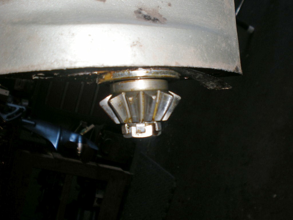

          My prop shaft is tight and turns smooth so things might not be too bad inside.
          I can see tapering / wear on the pinion gear, but think it’s got
          a few more miles left in it.
          May have to get "more" heat on it to loosen the old shellac sealant!

            Also, when you do get the lower unit off, be sure not to loose the short 2 inch water tube that connects the cooling line to the lower unit. They can fall out while carrying around the gear housing. Maybe try a small plastic coated dead blow mallet to knock the gear housing loose.

              I fired up the Oxy / Propane torch and heated up the seam.
              Didn’t take long and the shellac gave up the fight.
