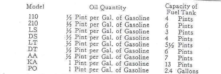

April 13, 2023 at 2:33 pm #275125Thank you all! Very helpful. Last weekend I acquired a PO-10, and after sitting for who knows how long after about 3-4 pulls it fired right up. I knew about the 16:1 fuel mix for the 1950’s engines, but this 8:1 is really good to know.
