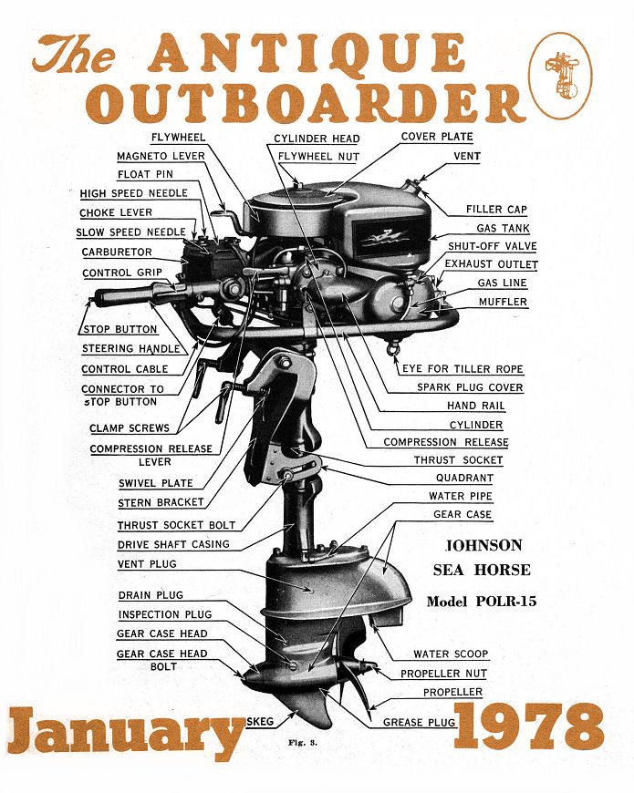

October 11, 2016 at 7:43 pm #45628The PO Johnson built for the Army/Navy during WW2 was a longshaft reversing model that was used to push barges and maneuver pontoon bridge sections. Official model designation was POLR 15. Many were sold in 1945/46 as Army Surplus…
October 11, 2016 at 8:20 pm #45633October 11, 2016 at 10:26 pm #45643Thanks Mumbles. I see I’m missing the "stop button", as
well as the carb and prop.
I checked compression this AM, after a shot of WD-40
in each cylinder, and had about 95 psi on each cylinder.
Is that okay for this engine?Prepare to be boarded!
