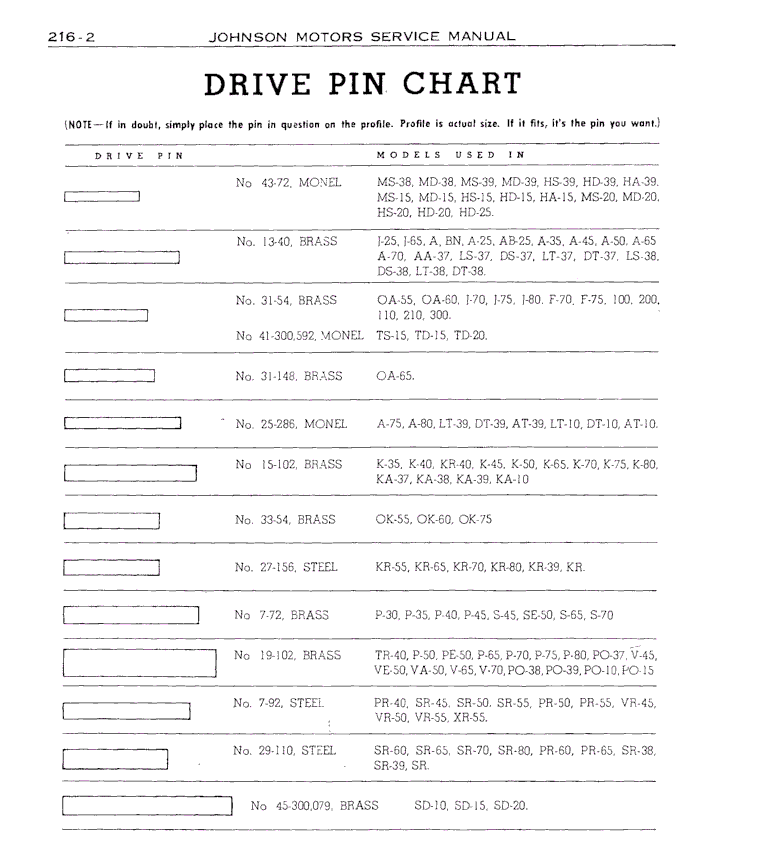

      What metal is best to use for sheer pin for these engines ?? Stainless steel or brass ??
      #41665
        The original 19-102 pin was made of brass.
        #41682
        1957evinrude
          Okay my buddy sheared a pin made with brasss maybe better we go with brass .
          Thannks Mumbles I appreciate that !!! 🙂
