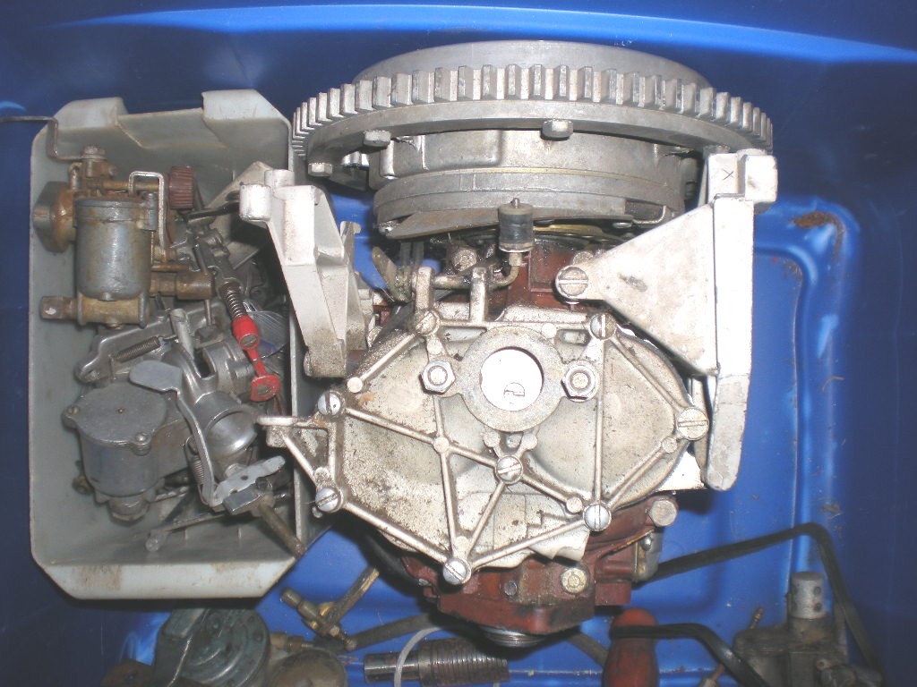

      In a box of outboard parts I bought there is a
      twin cylinder, maroon Johnson power head. Guessing it’s
      in the 18 hp + range.

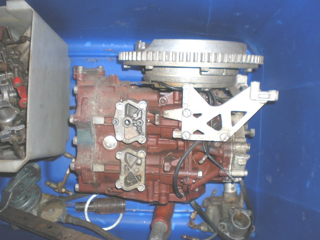

            #27515
              I check out the Johnson power head. It must be
              an 18 hp as the headbolts 5/16", and the top
              two are 2" apart.
              The core plug has the letter "M" and RPH on it.
              On parts diagrams, for 1956 I see (4) versions of 15 hp FD10 models listed.
              For 1957 there are (4) 18 hp FD11 versions.
              For 1958 there are (4) FD12 18 hp versions.
              Any easy way to narrow it down with the photos?
              Thanks.
              #27520
                OK, what you have there is either an replacement powerhead, or a replacement crankcase, the color is close to the colors used from 56-58, but this is a 60s model FD 18hp. The thermostat and lack of pressure nipple on the intake manifold. So, I’m thinking this was used on a 1960-66 FD 18hp. I’m basing this year range by the white paint on the parts swapped over from the original powerhead.
                #27521

                    quote ede:
                    Paint looks like red primer
                    Yes, you are right, that is the primer not a coat of paint.
                    #27523
                    chris-p
                      yeah, I would say that is a factory replacement powerhead that never got painted, 60s vintage. cool score. Might have low hours on it.

                        Thanks for the replies. It looked maroon to me in the
                        garage, but will have to take it outside in the natural
                        light to tell if it’s red primer.
                        I guess the impulse port on the upper by-pass cover
                        normally dates a Johnson after 19 __?
                        Looks like a touch of blue on the head…… perhaps
                        a true morphadite?
                        I’ll try looking at some of the 60’s diagrams.
