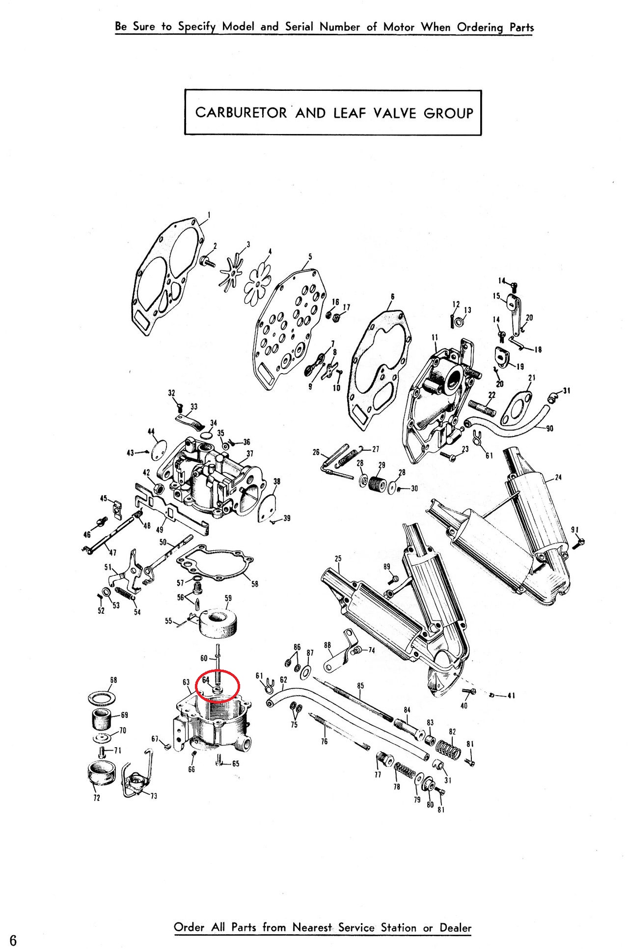

        Is the nozzle gasket in place and in good shape?

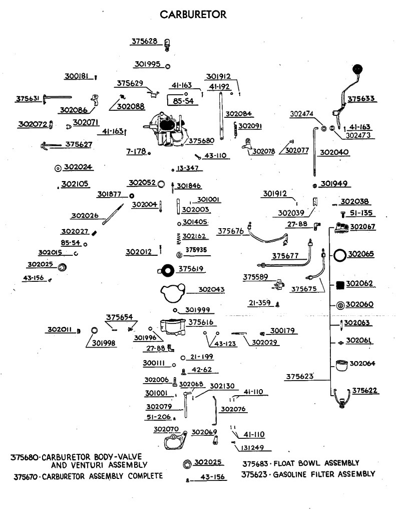

              Buccaneer, the early QD’s are a little different setup than your picture. I’m going to drop the bowl and check everything again today. All new gaskets, when I did the rebuild. I also put the carb into my Ultrasonic cleaner.
