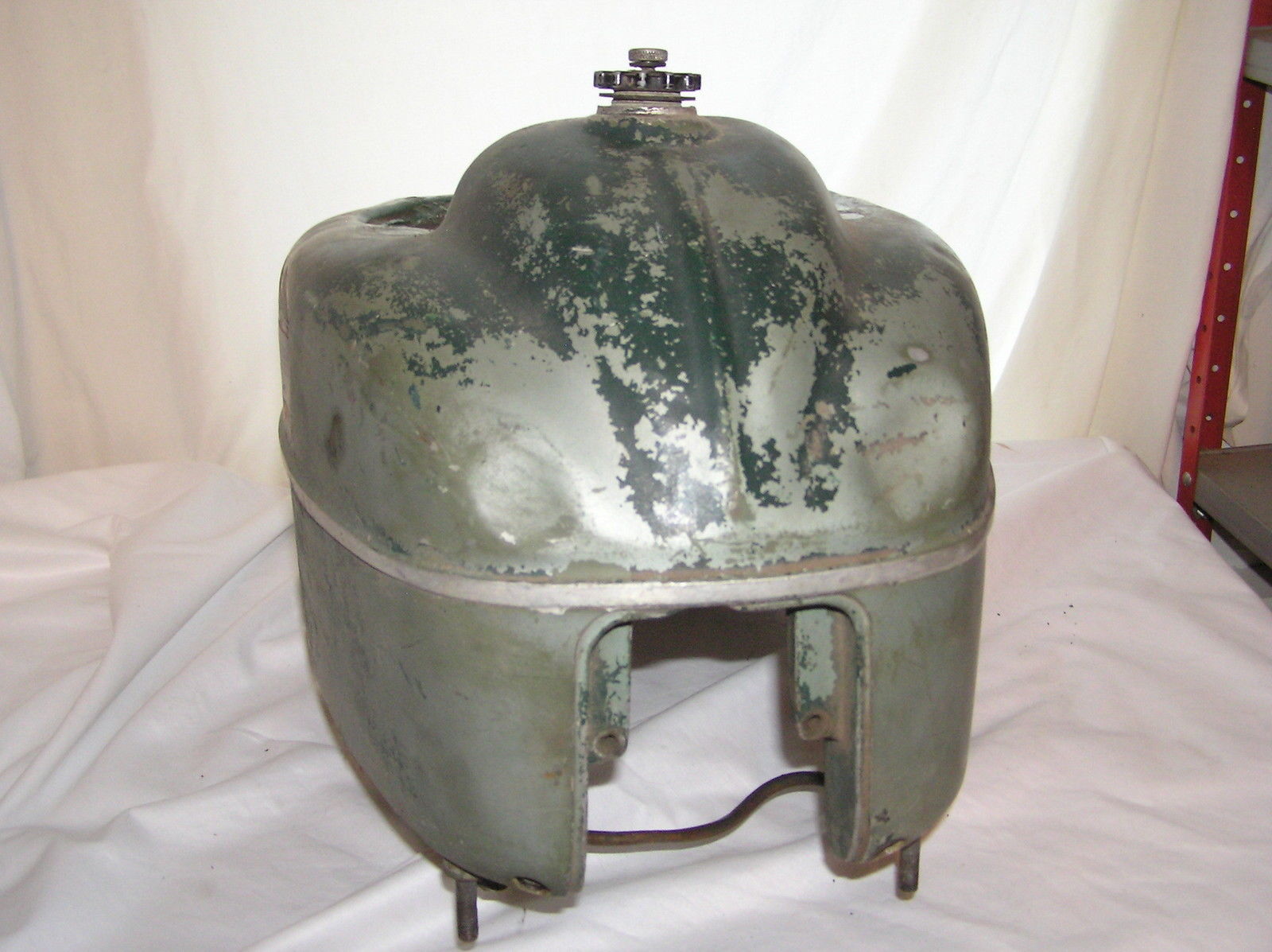

              Thanks for the replies. From you Youtube videos I could not see the
              carburetor, nor where the bottom of the tank was. Make sense now.
              Found a tank on EBay. They do indeed look "deeper" than normal,
              and see how the tank bottom could be below the carb.
              Funny about the "back side" pressure Garry!
              #54060
              CHUCK
                Well….what do you know! I saw one of those at Tomahawk this past summer and was puzzling over what motor it was from. Different enough to stand out….and I don’t think the seller knew what it was either.
                Thanks for the picture.

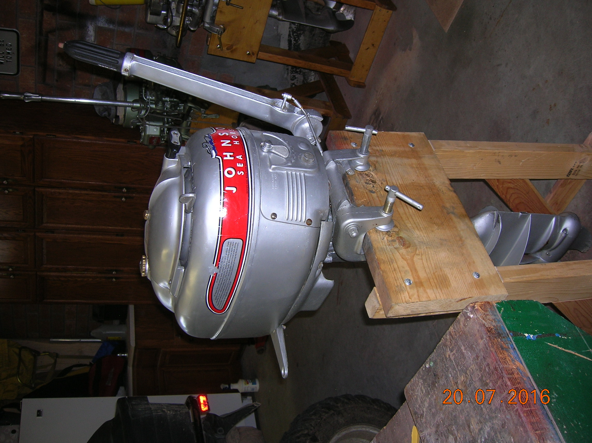

                #54061
                jerry-ahrens
                  I have an SD10 if I can find a picture… here you go..
                  #54062

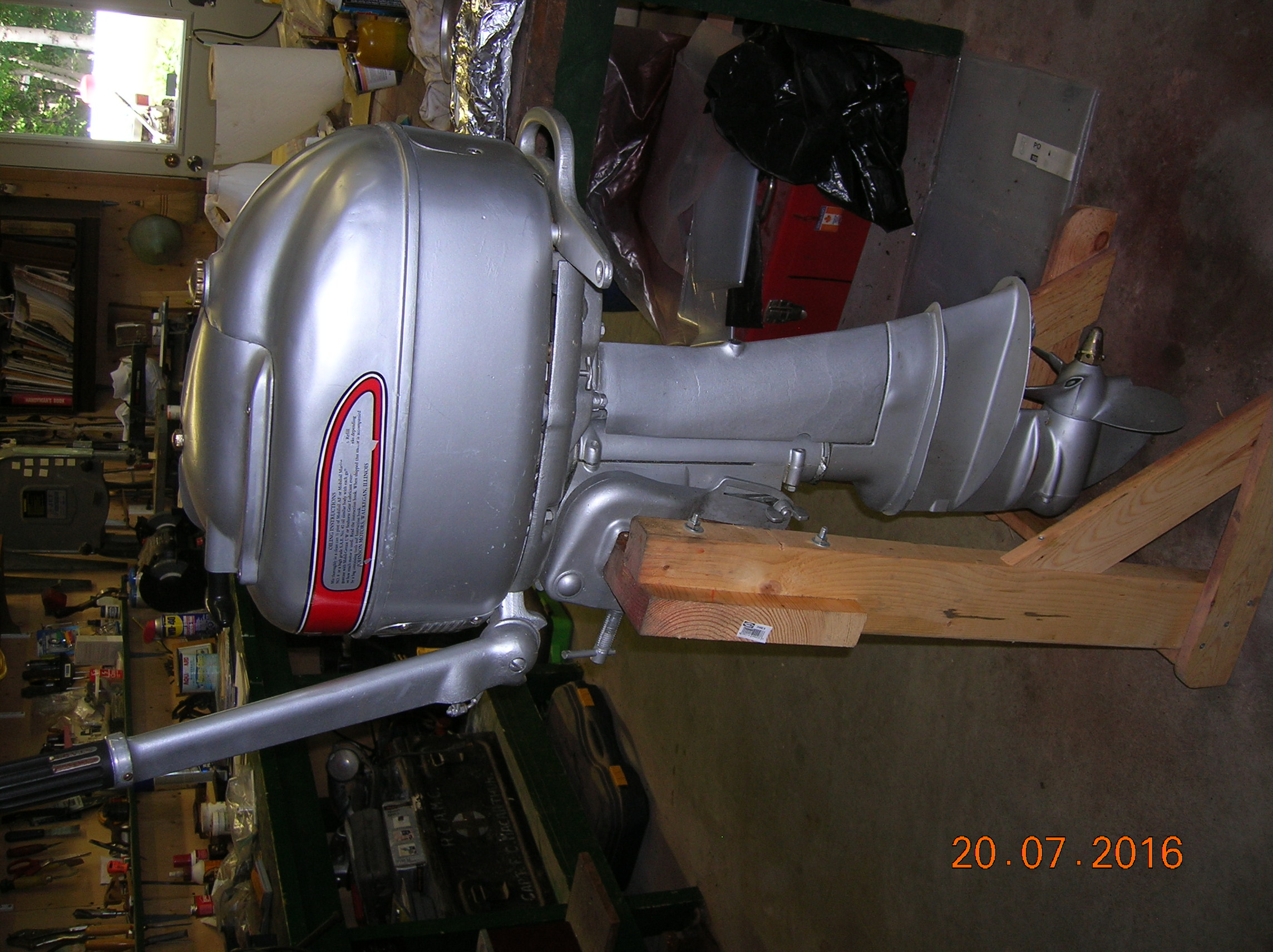

                  jerry-ahrens
                    You can make out the ”ventless fuel cap in this picture.
                    #54063

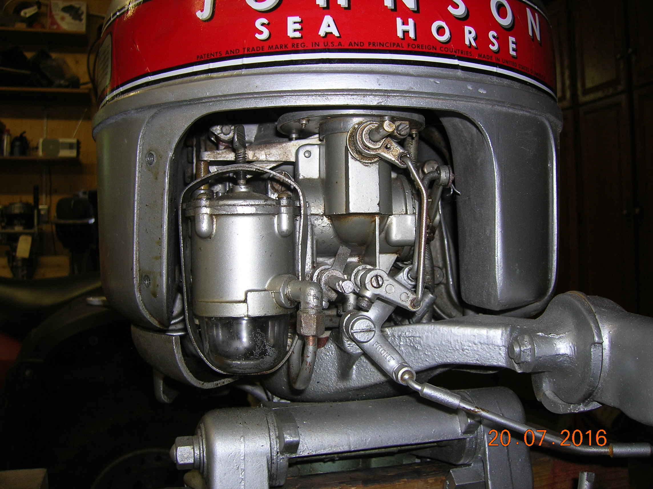

                    jerry-ahrens
                      One more of the carburetor..
