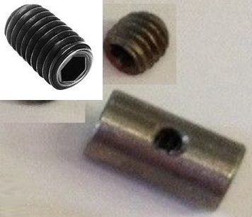

            Can’t see the detail – is it a Allen socket? Can you make one out of a screw and saw a screwdriver slot? Just wondering.
            #28785
            johnny-infl
              it is a 1/16" hex allen screw. It is so small, I would not
              cut a slot for a screw driver as you need a LOT of torque
              to hold the wire in place so it won’t slip. Plus, it is recessed about 1/32" into the barrel.
              Just buy the proper tool for the job – thus eliminating the frustration factor.
