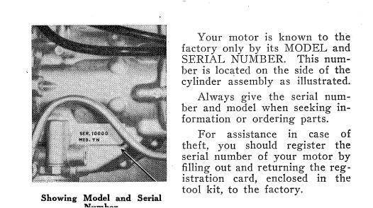

July 29, 2015 at 9:29 pm #21195You’ll find the ID when you pull off the side covers. Just look for a small rectangular area, maybe even raised..
July 29, 2015 at 9:55 pm #21197On the port side of the powerhead, very near the bottom there is a flat rectangular region (On the TD20, the arched water line passes above this area).
The model ID is stamped there, along with the serial no.
July 29, 2015 at 11:29 pm #21204quote legendre:On the port side of the powerhead, very near the bottom there is a flat rectangular region (On the TD20, the arched water line passes above this area).The model ID is stamped there, along with the serial no.
The Model/Serial No. stamp would be the defining feature. No need to remove the lower cowl to see that. Almost all of the parts are identical to the TD-20, so who knows what has been mixed and matched over the years.

July 31, 2015 at 12:35 am #21294I looked for a number and found on the lower port side of the powerhead,
41E-350. Is this just a serial number? Does the "41" mean 1941 ?
I didn’t see TD-15 or TD-20. Perhaps it’s under paint.
