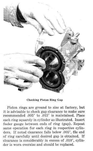

          I have been looking for rings and you are correct they are hard to find, seems they come in a pair , so I would need three of them, Marine Engine wants $75 for a pair, I am not doing that. Since this is a parts motor I may just hone the cylinders and try the old rings, do you know what the end gap should be on the TD15 rings?
          RJ
          #243657
            0.005 to 0.010 would be ideal.
            TD-TN-Rings
