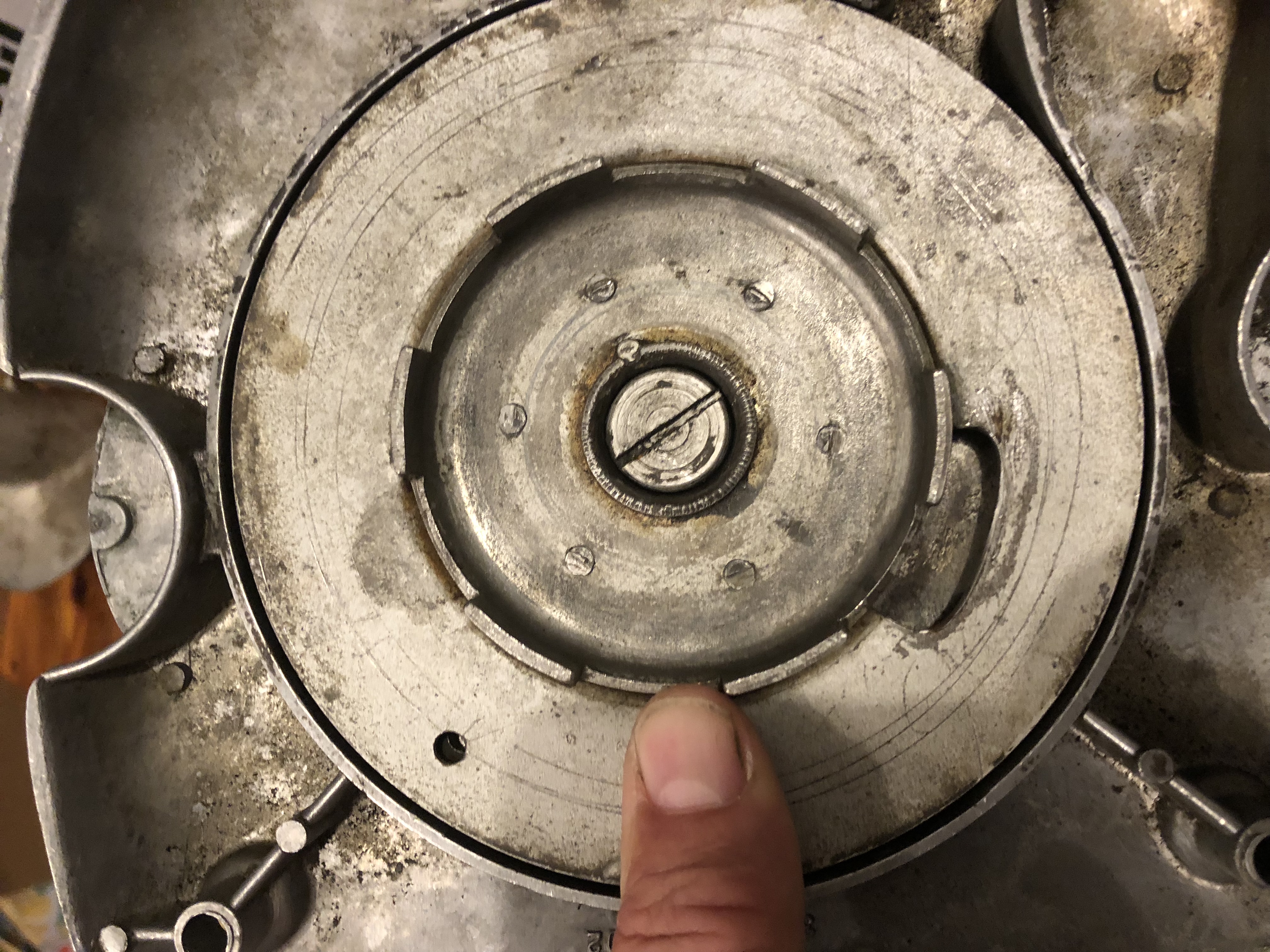

      I have replaced the rope and after a few pulls the knot pulls all the way through. Are there any tricks to keep that from happening?

        Same happened to me. I just tied a two knots so it was larger. Working so far.
        #81337
          Drill a round hole in another location. Then never pull the rope all the way to the end. To do so will cut the knot off quicker than you can blink.
          #81341
            The original starter cord would have had a wire core and a hook, or anchor on the end to grab that slot.
            #81344
              make a not and fire up the loose end about a half inch of cord into a flaming glob
              then flatten the molten nylon with a flat blade

                    I use the roll pin method shown in Garry’s post paired with the mashed flaming glob crosbyman posted when I replace my wire core starter ropes in these motors. Also, as Frank R said, do not pull to the end of the rope. The roll pin helps take a good amount of the load off the knot, but it does not prevent the knot from being cut off if the rope is pulled all the way to the end.
