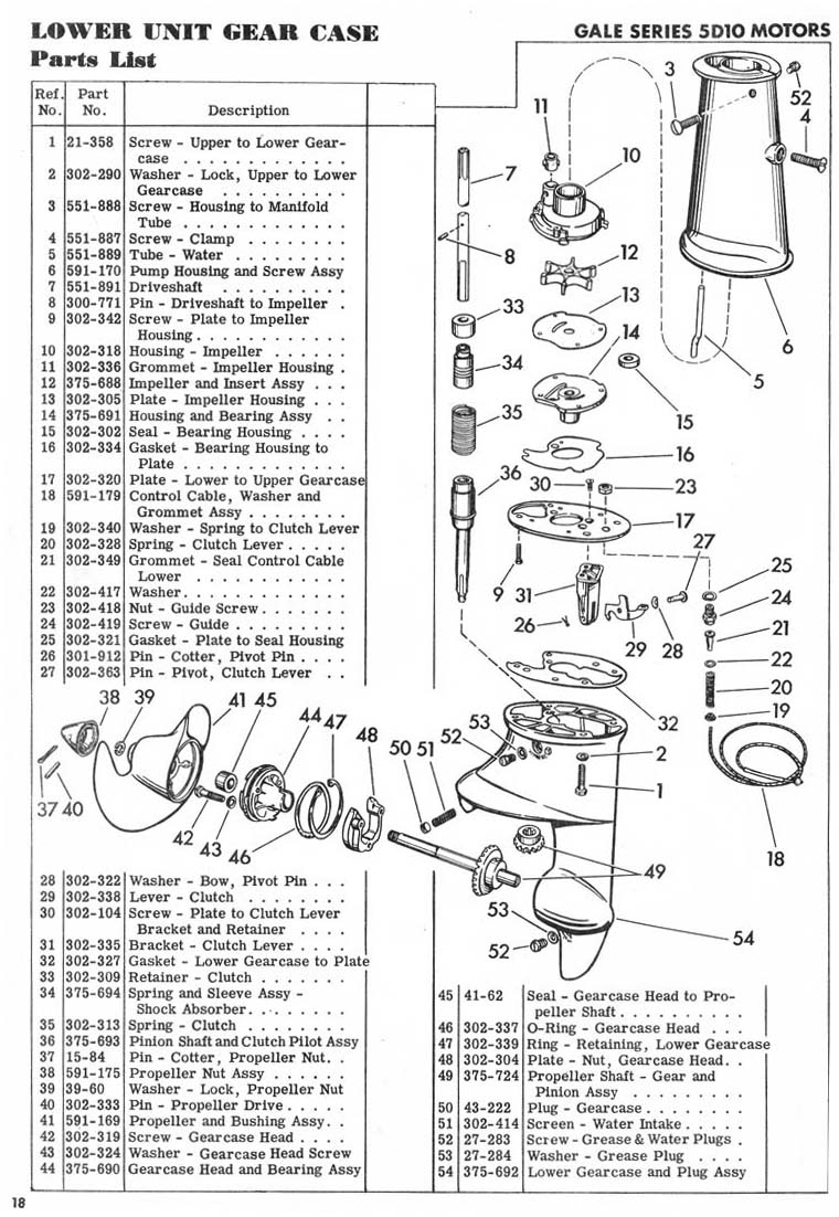

      I’ve hunted and hunted the forum, but no luck…Does anyone know where I can source the two seals for the lower unit of a Johnson TN? I own a TN26 and TN28 and I would like to re-seal the lower units. The TN26 is getting water in at a fairly fast rate.
      Original part numbers should be: Prop Shaft Seal: 41-62; Upper Drive Shaft Seal: 302302. Am I missing any other seals?
      I was able to source the large o-ring, P/N 302337 for the gearcase head, so I am good there. Thank you MarineEngine.com!
      I did find an old post where I member had seal kits made-up for the Johnson TN, so I’ve sent him a message.
      Thank you very much for any help.
      Steve
      Pg-18-Lower-Unit-Gearcase-4

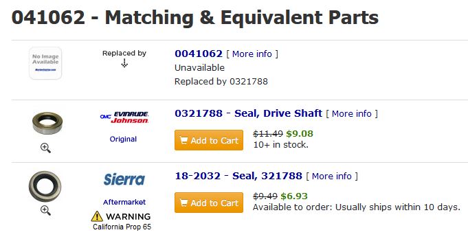

        The 41-62 according to my notes is equiv to Sierra 18-2032 or OMC 0307563 or 0321788 or National #471442
        https://www.ebay.com/sch/i.html?_from=R40&_trksid=p2047675.m570.l1313&_nkw=18-2032&_sacat=0
        Verify for yourself before ordering.

                Again looking back on my notes I remember that there may be a formula for converting those old 41-62 type numbers into current stuff.
                First; replace the dash with a zero=41062
                Then, Add another Zero at the beginning to get a 6 digit number 041062
                Then….enter that into a site like marineengine.com and see what you get:
                41-62

                  Your existing Prop Shaft Seal is a CR-30059?
                  That’s different from the 41-62 shown in your Gale diagram.
                  A CR-30059 is equiv to a Sierra 18-2035
                  182032
                  #246873

                      My mistake! I’m working on my 1952 Johnson TN28, my 1950 Johnson TN26 (the one that needs the seals) and my 1952 Evinrude Lightwin simultaneously. I mixed up the CR seal number from the Lightwin. . . Thank you for correcting me!
                      182032
