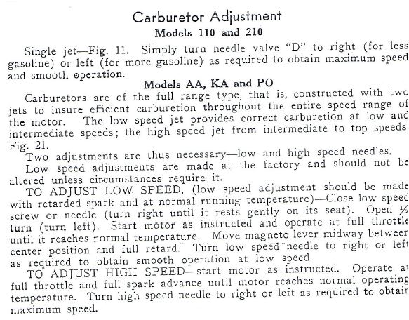

I just got my KA-38 running for the first time in probably 40 years! I’ve been trying to tune it for about an hour or so now, but I can’t seem to get it dialed in. Any suggestions about some baselines I can start with? I’m pretty new and none of my other motors have had a high and low speed adjustment, only a single one. Also, should I check out the water pump? I haven’t taken anything apart, but not sure if it’s a rubber impeller or what.
May 12, 2016 at 9:06 pm #36478When I had my KA 37 running on a stand once, I think the high speed needle on top was only out about a quarter turn or so for it to run right and it was very sensitive to any adjustment. I can’t remember how much the low speed needle was out. These motors don’t have a water pump but rely on the boats forward motion and propeller wash to force water thru the motor. It’s a pressure-vacuum system but the motor can be run on a stand if a garden hose is adapted to the pipe fitting on the bottom of the cylinders. Since they have a large rotary valve with sealing rings on the crankshaft, they need an 8:1 fuel mix. That’s one pint of oil to one gallon of gas.
May 12, 2016 at 9:31 pm #36480Thanks, I was running it on 8:1 leftover from my PO. I’ll see if I can get it running well with that setting on the high speed adjustment
May 14, 2016 at 3:39 pm #36541Just fiddled with the carb some more and I can’t seem to get it to run right for very long no matter what I do to the screws.

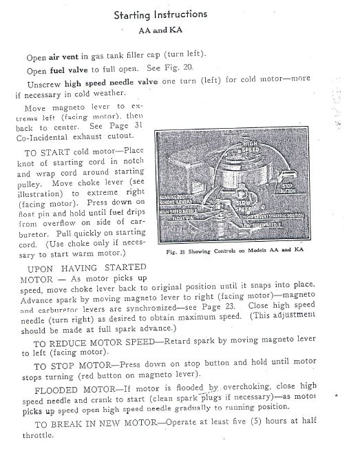

May 14, 2016 at 4:05 pm #36542May 14, 2016 at 5:12 pm #36551Not sure about the condensors, I just left everything alone except the plug wires since it gets good spark. That manual is exactly what I needed, thanks
May 19, 2016 at 12:40 am #36742Got it all tuned up. Heade up to the lake next weekend to put it to the test, just needs a new cotter pin
