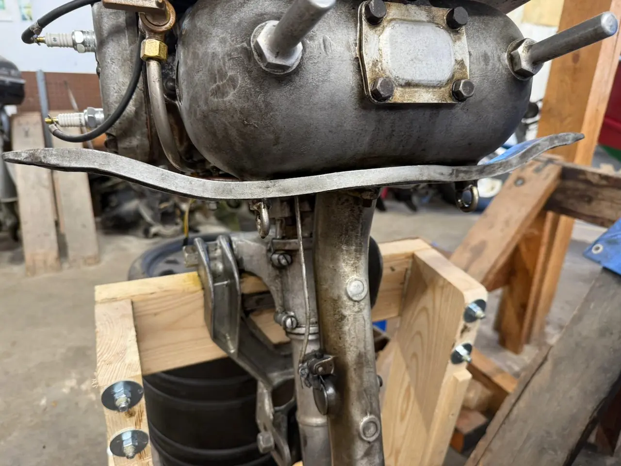

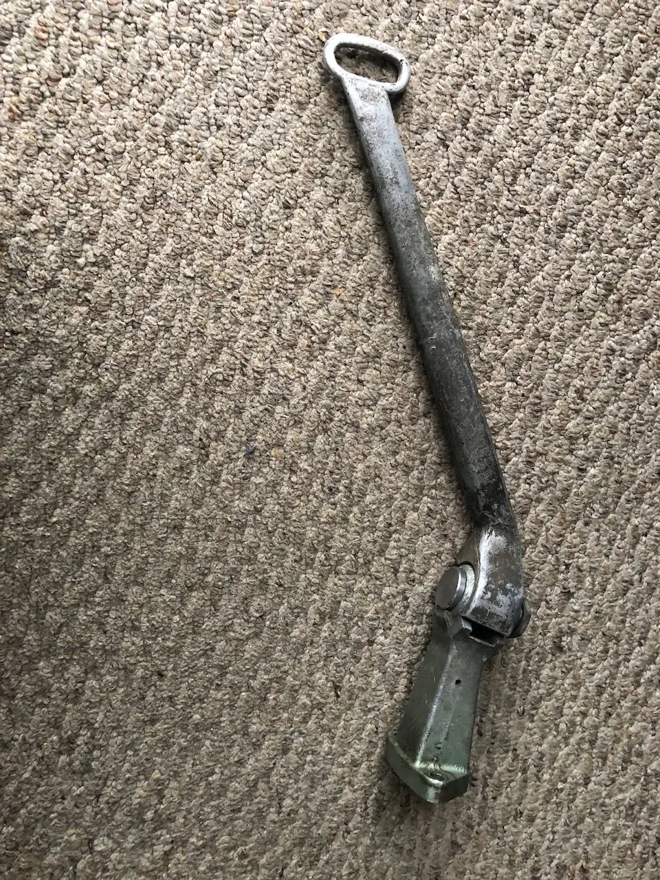

      DAVID KELLEY
        My friend, Lincoln, has this bar on his V45.  We couldn’t find it in the parts manual.  He thinks it may have been fabricated rather than original.  IMG_4646

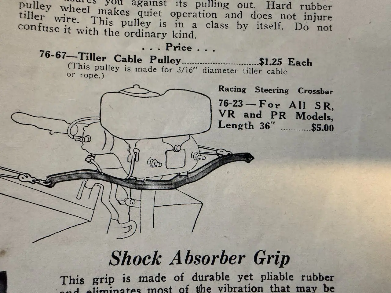

        DAVID KELLEY
          I found this in an old “Useful Accessories” brochure.
          IMG_4650
          IMG_4651

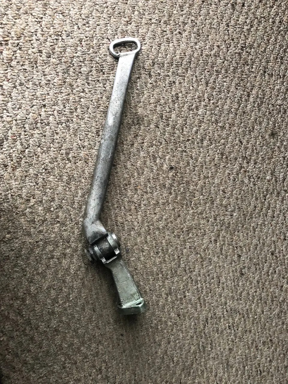

              George Emmanuel
                The boat I use to run my antiques is also the boat I use to run my classics, a 1958 Crestliner. I have the steering set up for OMC type quick connector. So I make my own steering bars for my V-45/S45 and PO, and a different one for my Speedifour. This allows me to use various motors including my Johnson 1957 35hp and make changes quickly.
                The picture is the bar for my V/S/PO. It is designed so it hangs below the carburetor and the OMC connector connects easily. The one for the Evinrude Speedifour is very similar but the difference is where the bar is attached to the motor. The V/S fits in between the mount whereas the Speedifour mounts to the side of the mount. You will notice the round piece is at an angle. This is due to the way the mount is at an angle. When connected, the bar is perfectly in line with the front of the motor.

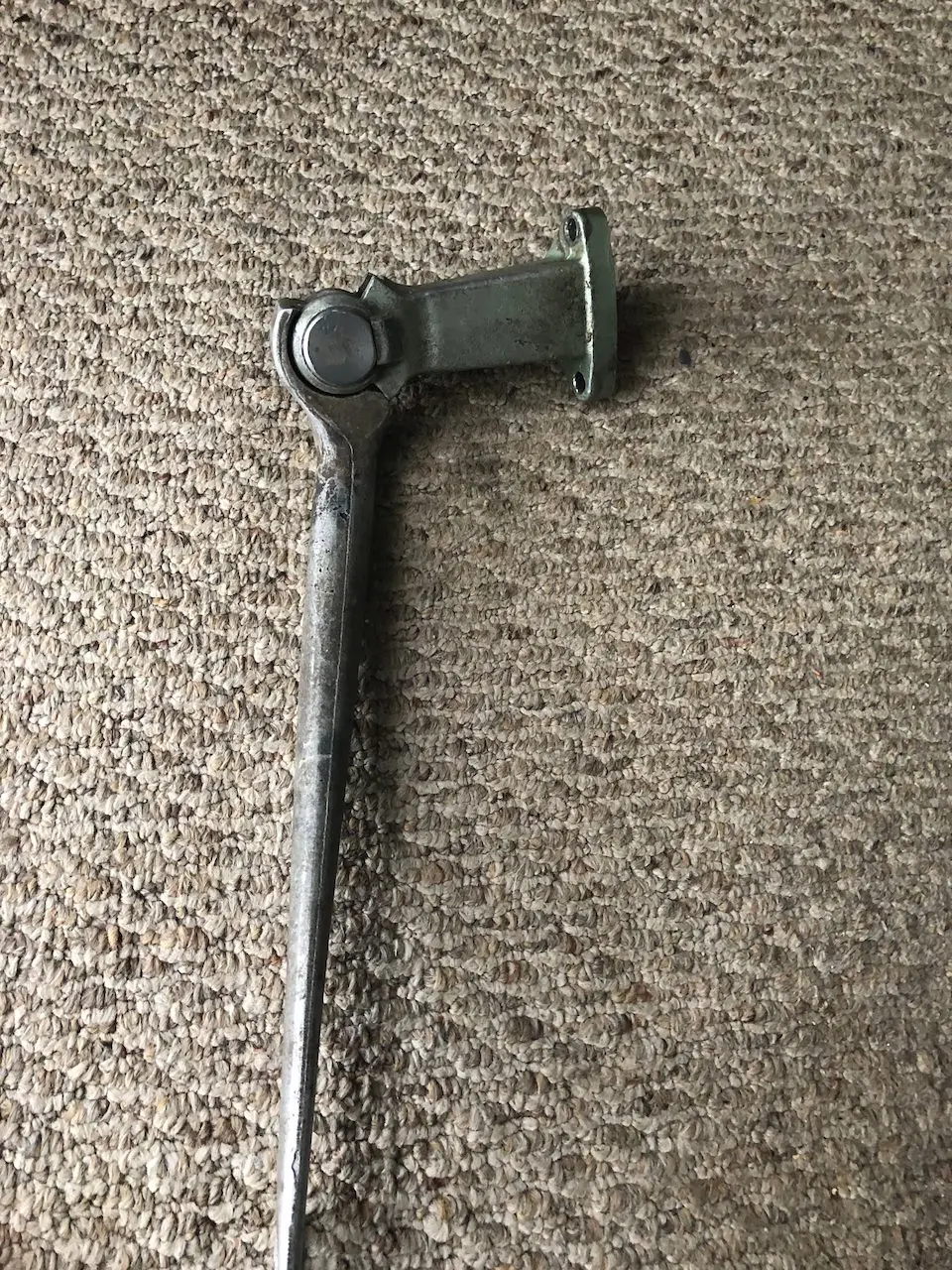

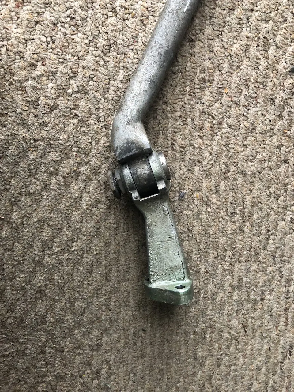

                DAVID KELLEY
                  Thanks for the post of you steering bar, George.  I have to relook at my motor to see how that would mount.  Here are photos of a steering bar that mounts to the engine where the tiller bolts on, sent to me by Fred Truntz.  Several ways to skin a cat.  : )
