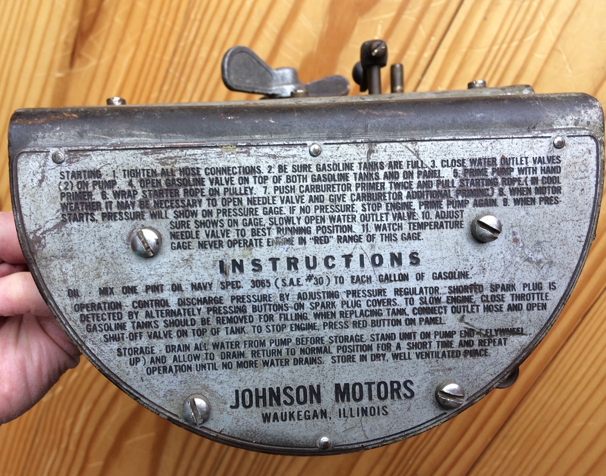

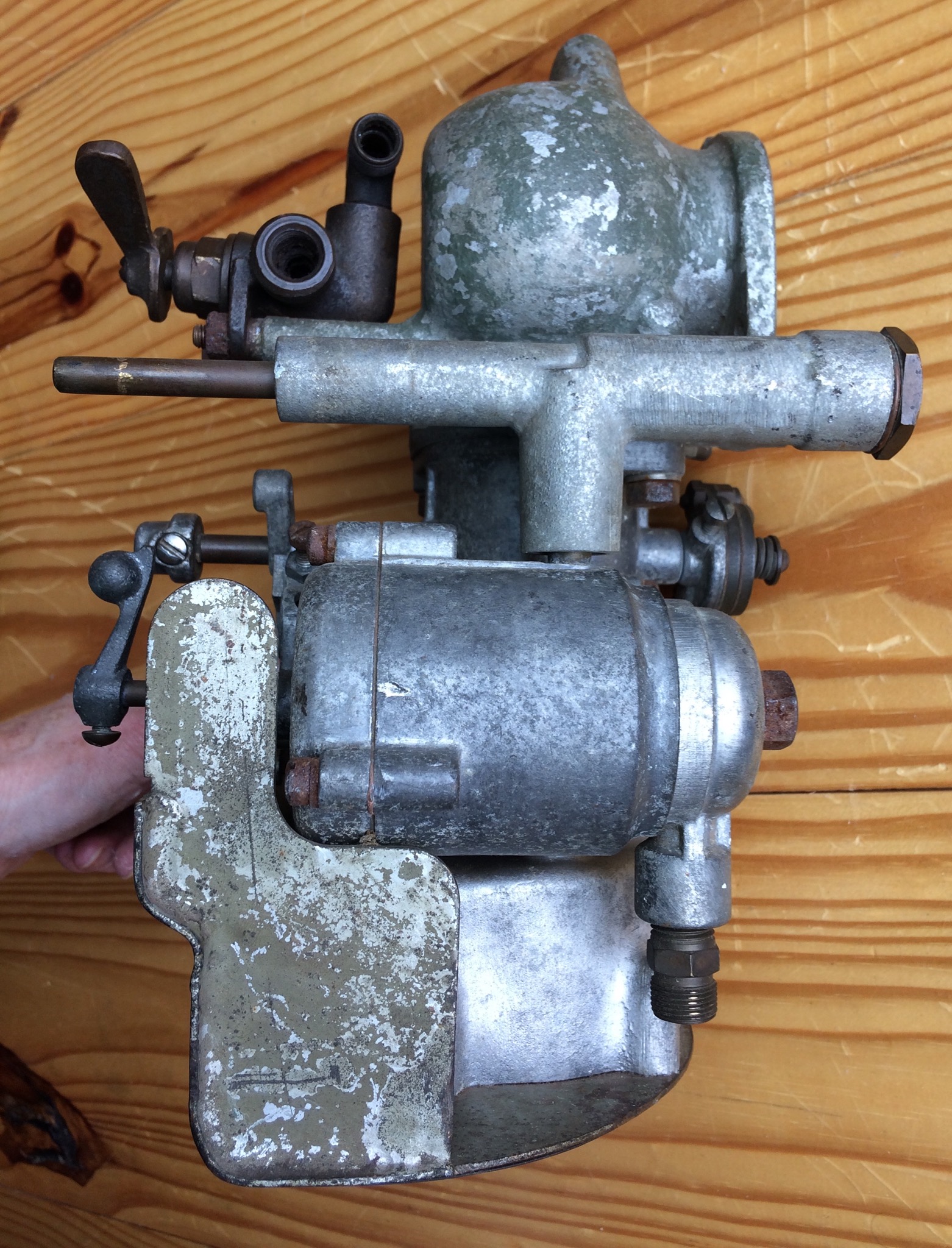

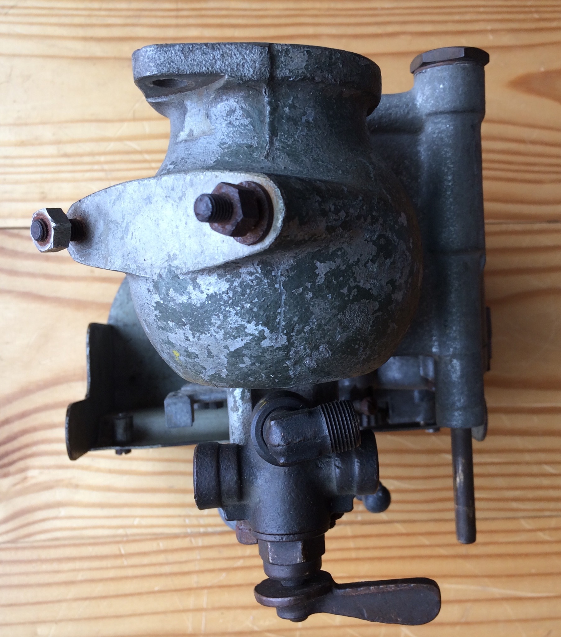

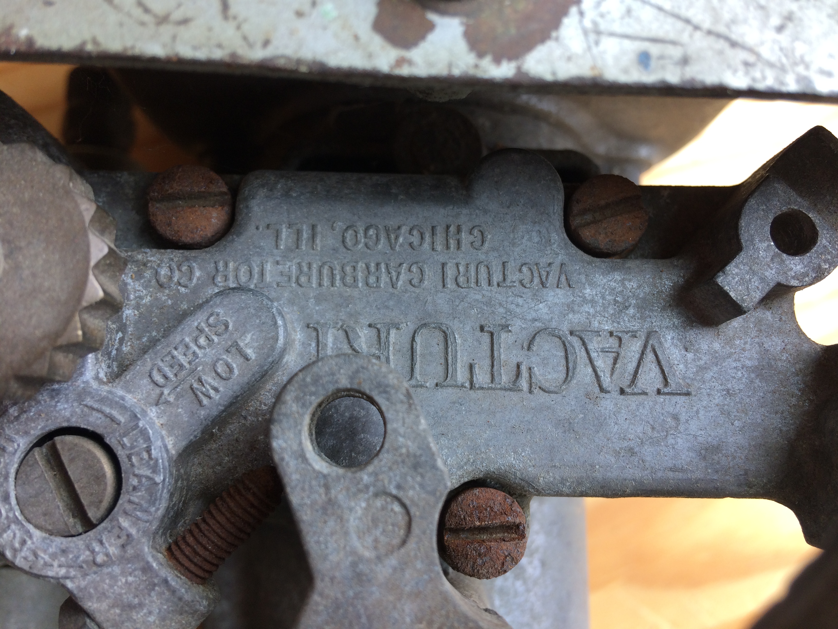

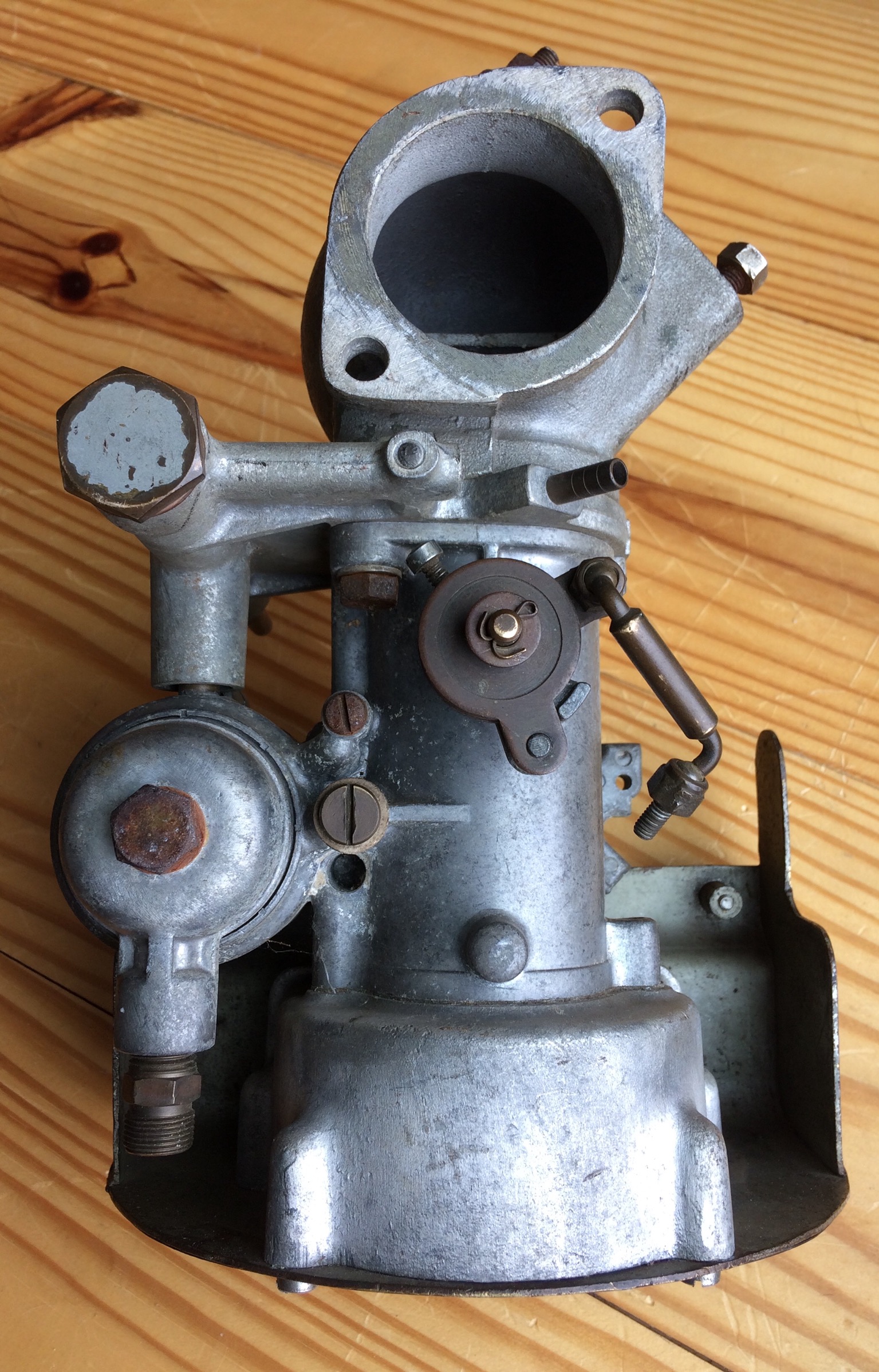

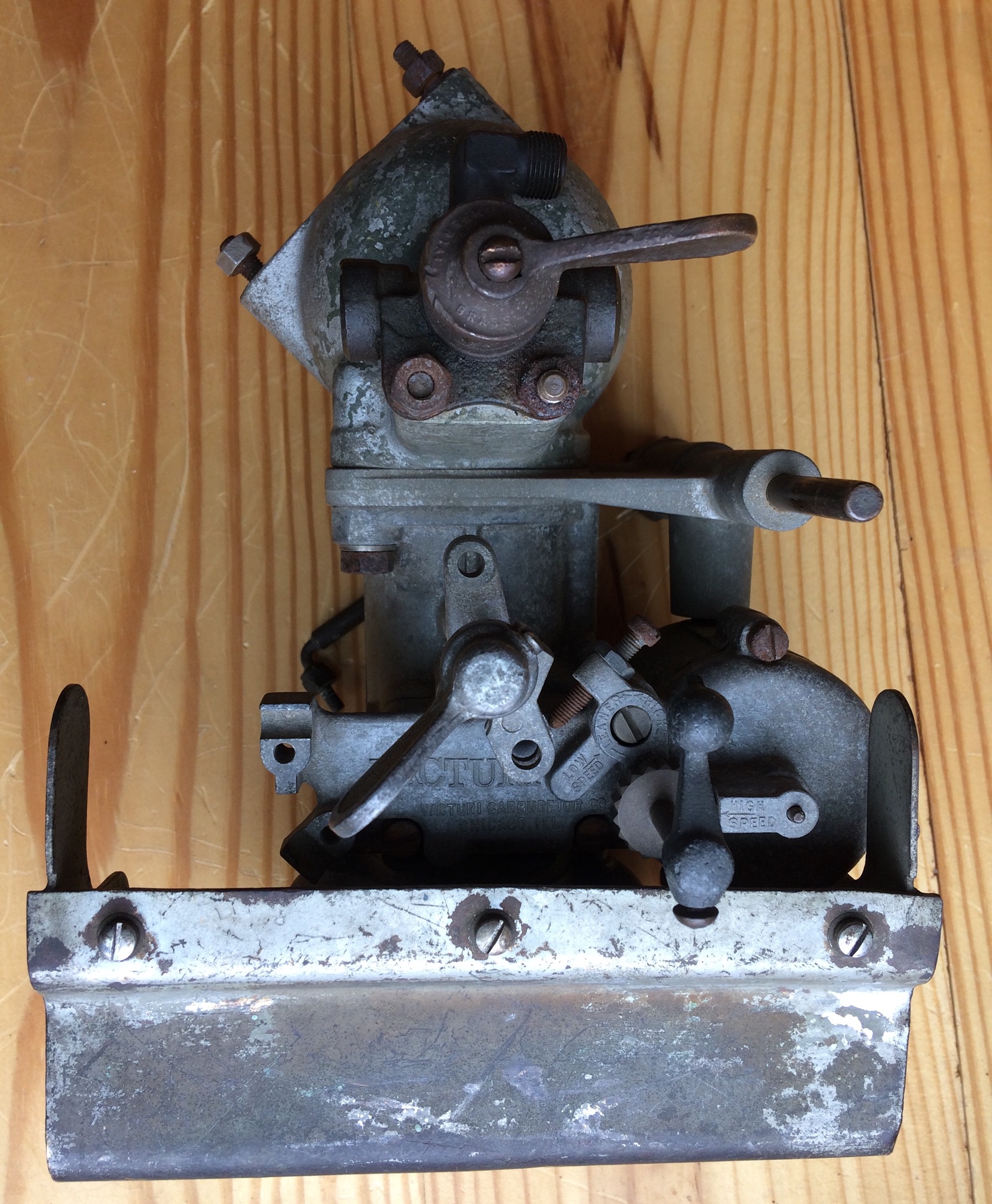

      Does anyone know what the story is with this?
      #72829
      ADAM GIBB
        I believe that this carb is from a WW2 era water pump produced by Johnson. That is why it has the right angle intake manifold.
        #72873
          Yes – it is the carburetor for the Johnson P500 high pressure pump. Since the powerhead is mounted horizontally, the carburetor is on top with the 90 degree adaptor, as seen in this (poor Quality) picture. . . 😎
