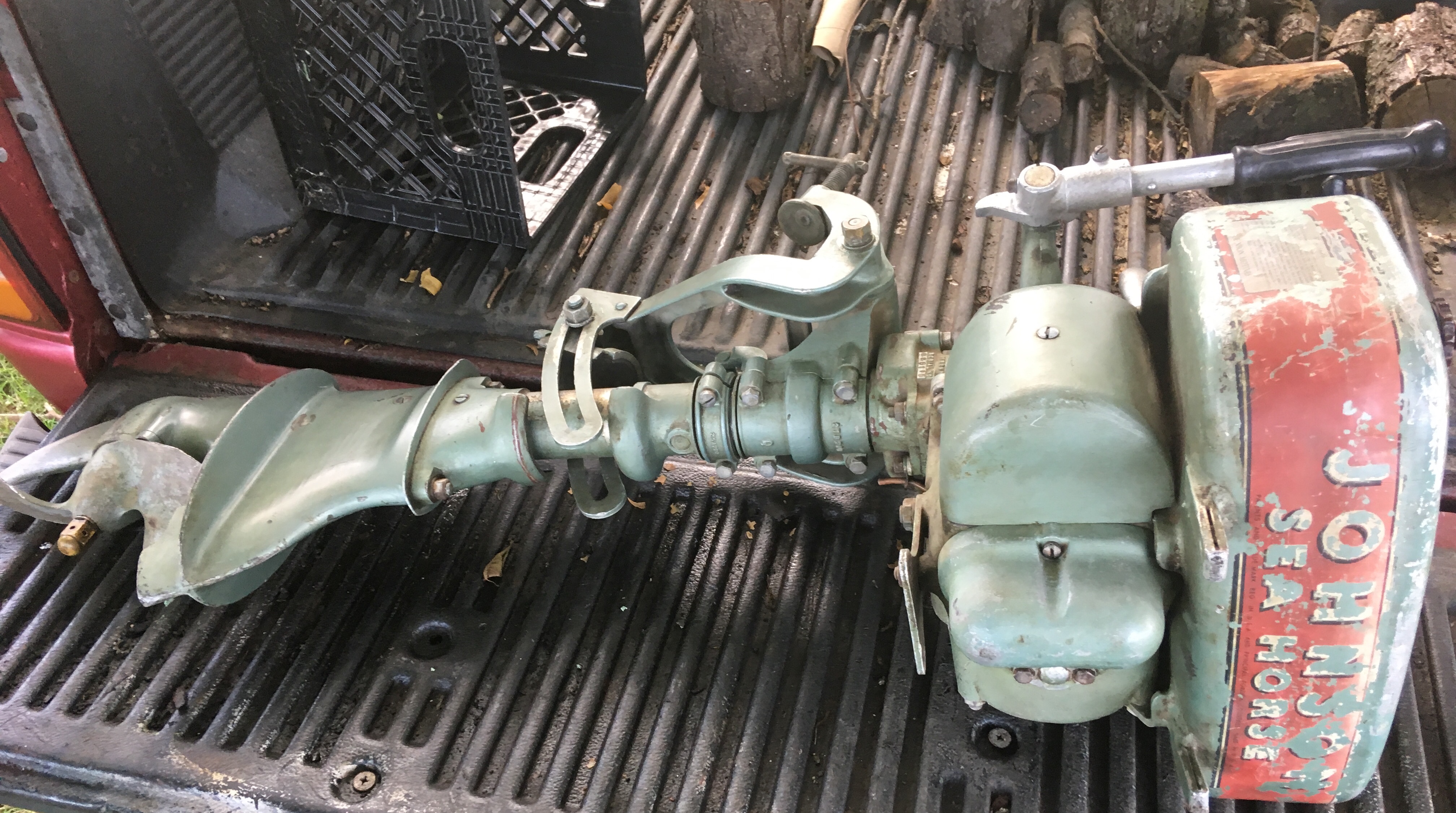

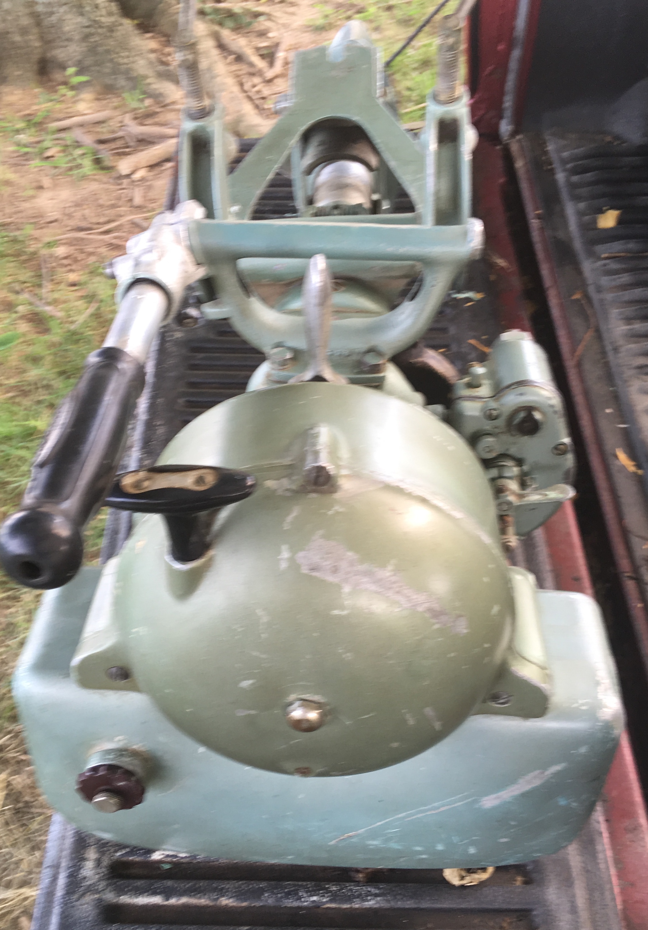

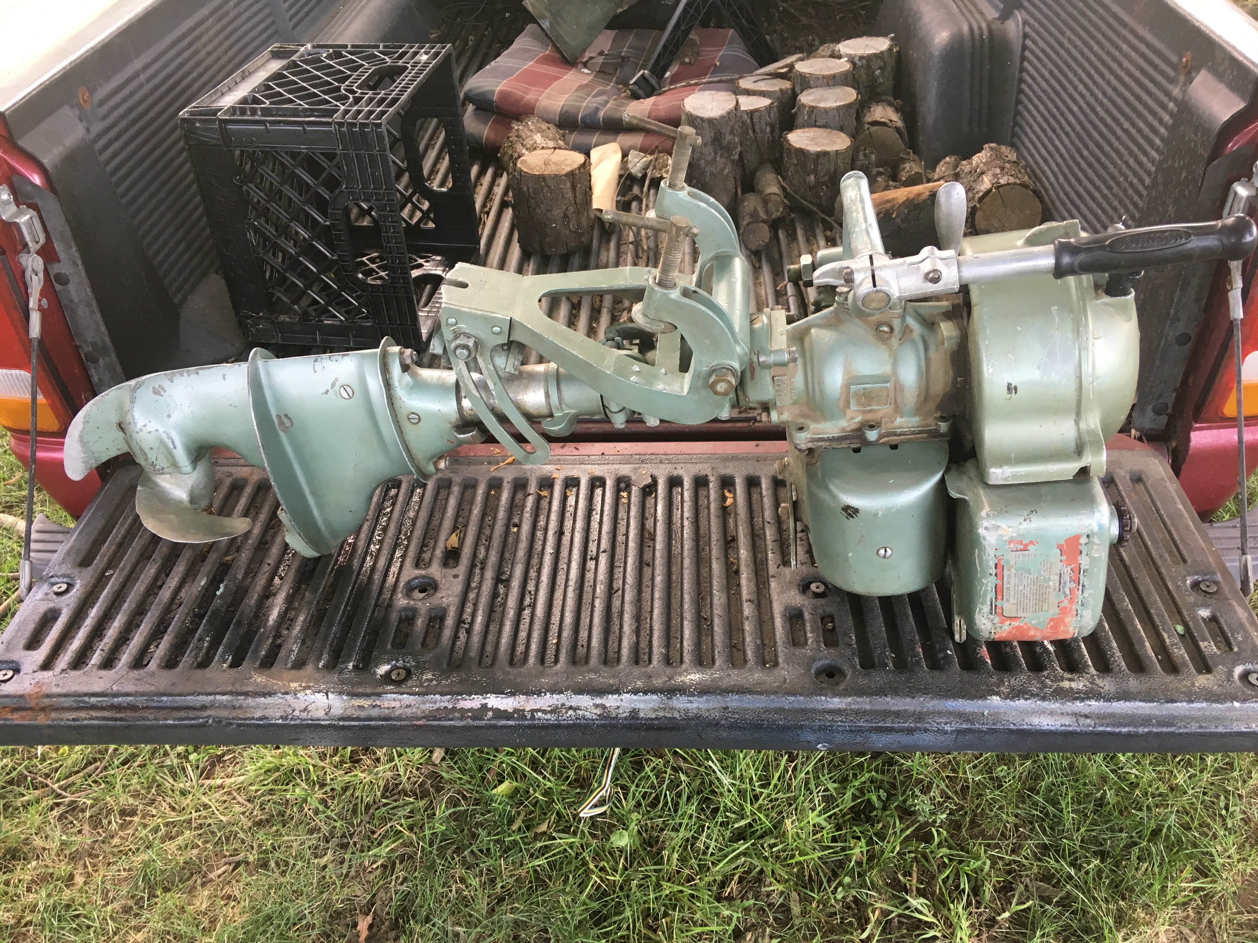

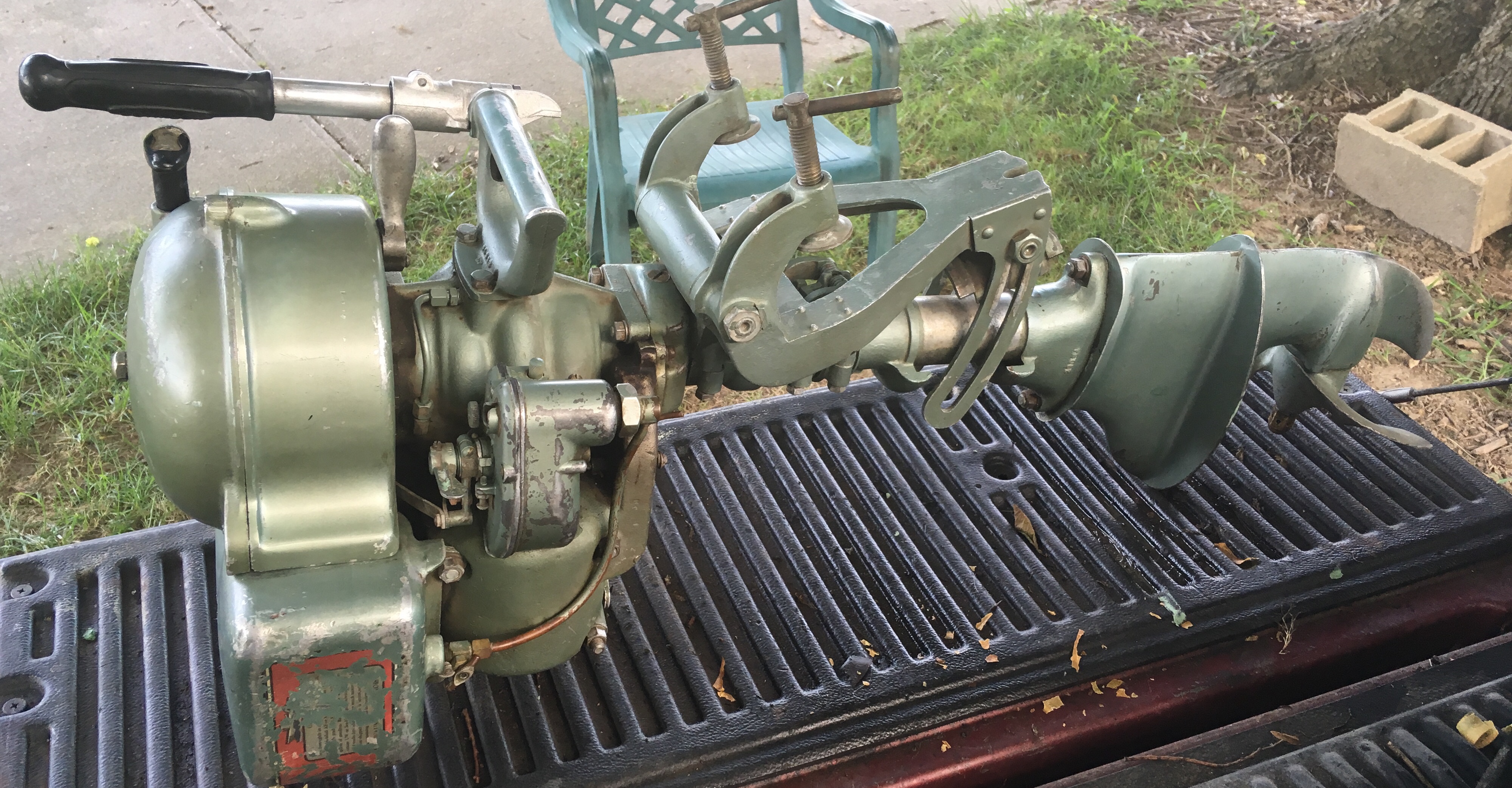

      I just bought a 1948 Johnson KD 15 it felt like it had a pretty good bounce when I pulled the recoil. I knew the coils were bad bot it looked pretty good with all parts there. Long story short I paid $100.00 for it , got home checked compression dry 80 lbs. upper cyl. zero compression lower cyl. pulled plug looked in bottom cyl. piston didn’t move when motor turned over. Do you think it is the connecting rod ? I have a connecting rod and camshaft that will fit it from another old KD 15 I will enclose pictures of motor do you think it is worth fixing or shall I use it for a parts motor. I will need coils also.

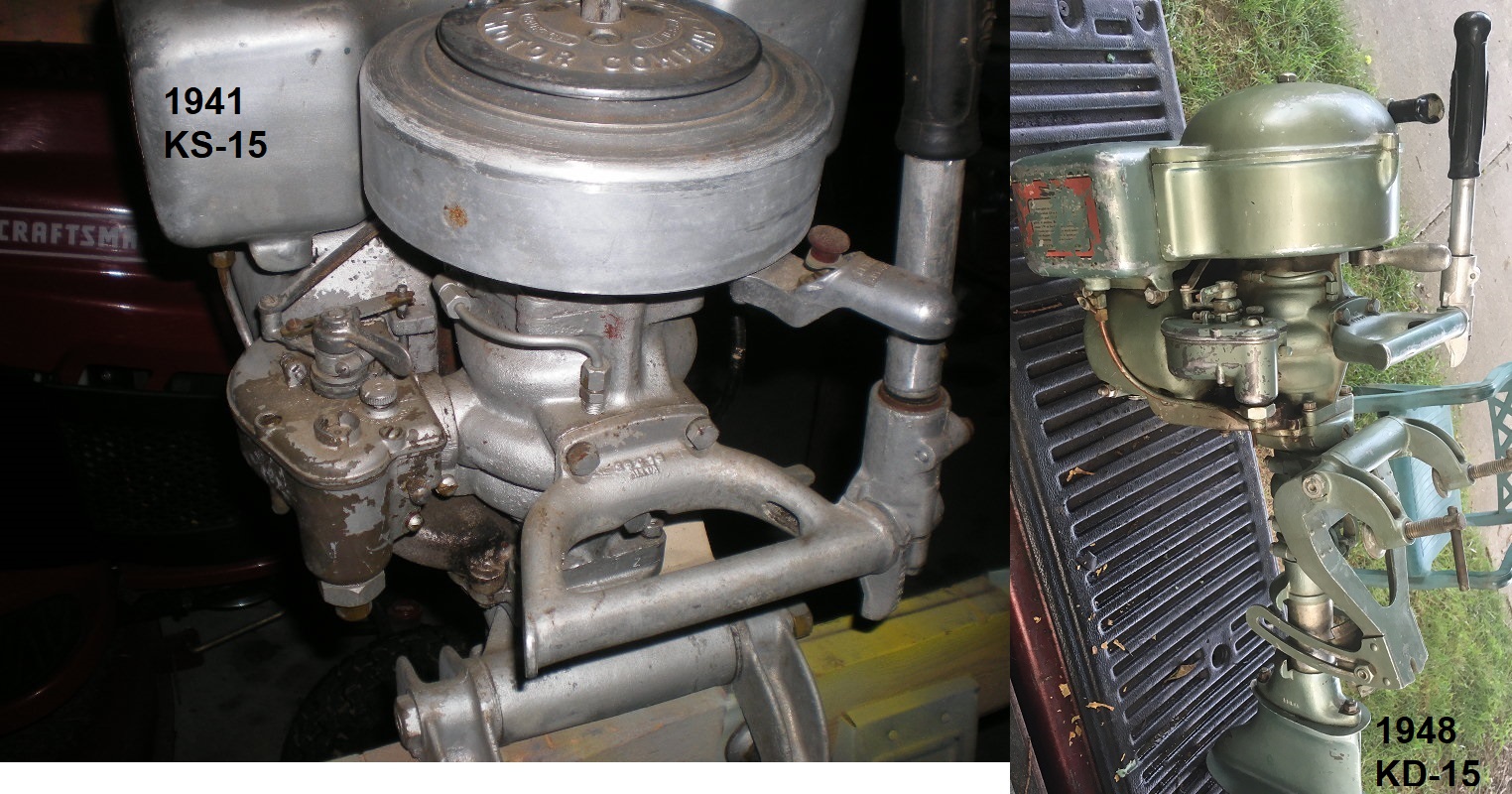

          I do have a 1941 KS-15, and see it looks to be the same basic motor,
          less the rewind.
          I’m curious as to "how" the rewind base bolts to the power head,
          and if at KS can be converted to a KD? I have no plans to do so,
          but just wondering if the blocks are different.

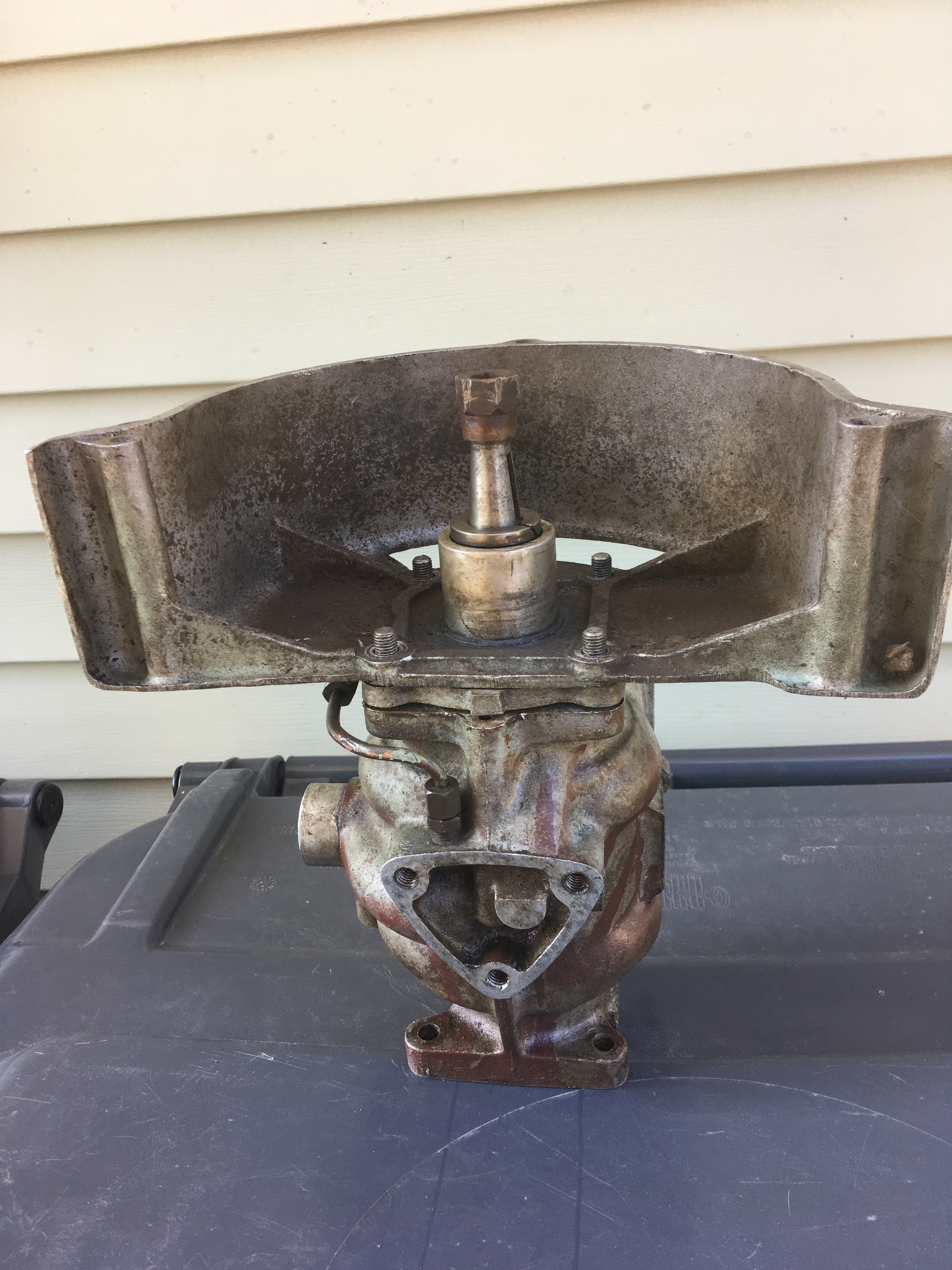

              Buccaneer , I will post a picture of the recoil base so you can see , it is bolted on to the powerhead . The picture is from a KD that I have that is just a pile of parts .

                  Thanks for the photo. Looks like it would be easy to convert one
                  to a "rewind" model, assuming the parts from the flywheels
                  were interchangeable as well.
