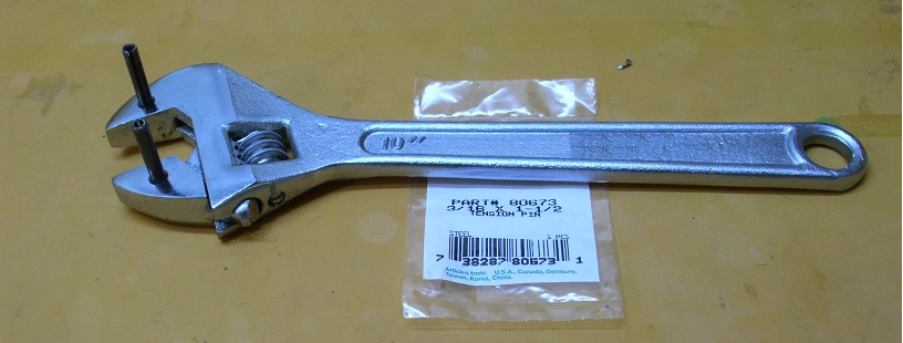

                I made this tool to remove those pump covers.
                Another tip that came from
                jw in Dixie.

                  I made a tool like JW’s, but the cover had elongated holes from when someone in the past used a punch to remove it. I tried several times with a punch and a heavy hammer before being successful…..I thought I was going to ruin the cover….it’s a good thing that it is thick.

                    Jim, if you’re REAL careful, you can use a bottom drill bit and make new dimples. A drill press is best so you can set the stop. (Stop just before it goes thru the cover!! ) Cheers, JW
