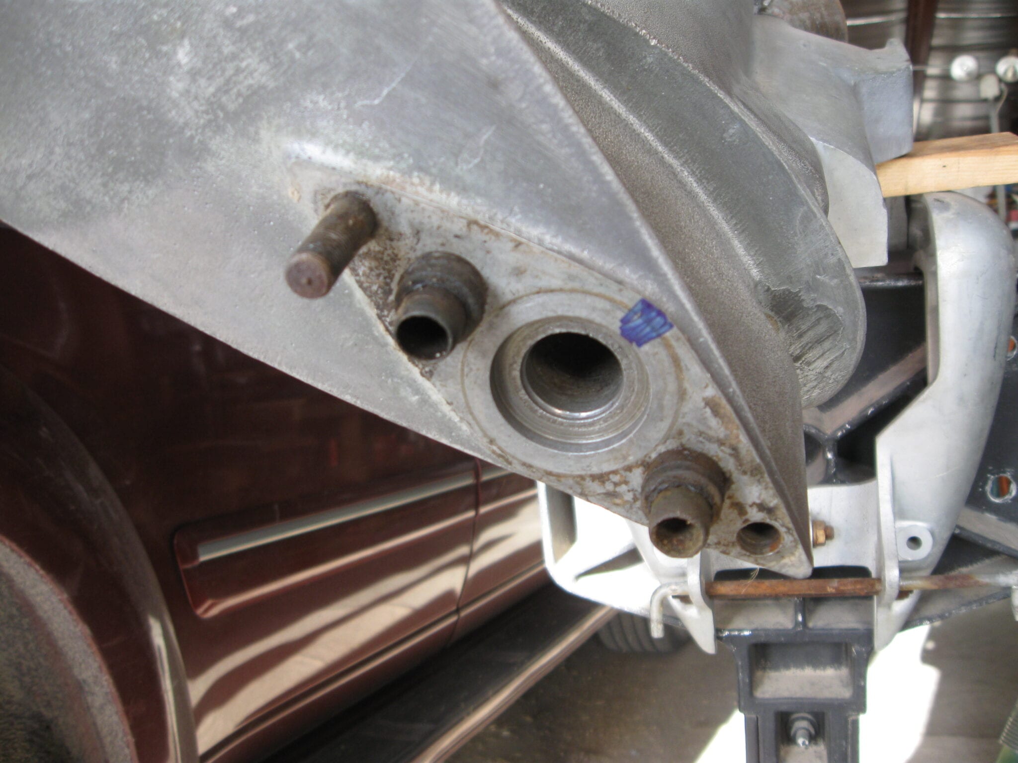

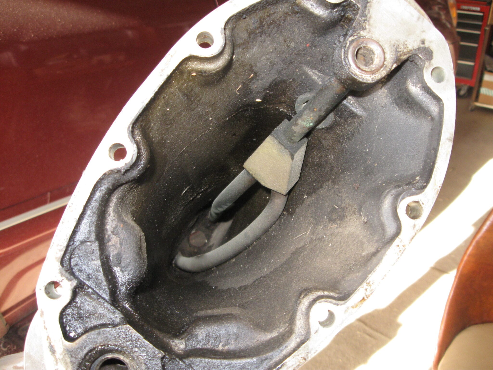

    Quinton Huxoll
      What purpose does the front water tube serve?
      IMG_0161
      IMG_0159

      #235776
        is it a pressure feed when under way
        #235952
        Quinton Huxoll
          Thanks for the info. It does make sense. Now to see if the passage way to allow that to happen can be reopened if indeed possible. From the top, the hole into the lower unit appears as a blind hole.

          70fgs700
            Hi, Quinton:
            Gary Orloff addresses your question rather well in a write-up through the Western Reserve Chapter. Here’s the link to the PDF:
            https://wrcoutboards.org/wp-content/uploads/2020/04/KF9_The-MercuryMystery-Motor.pdf
            The KF9 gearcase could be used in the conventional way, or flipped for use as a tractor (with a different prop). Basically, rotating the gearcase allowed you to use either of the “Y” pipes to supply water to the powerhead. Only one branch of the pipe would be used at a time. This is all according to Orloff.
            He also mentions Charlie Strang’s input on the tractor style. Apparently the KF9 was rather “unruly” with the prop set-up in tractor fashion…
            -70FGS700

            geary
              Quinton,  Here are a couple pics of it in tractor position !
              Geary
