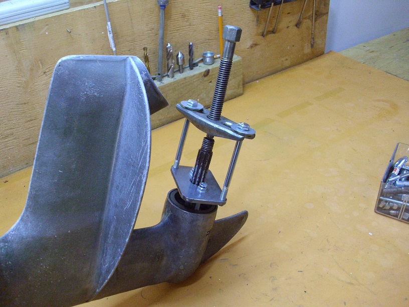

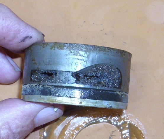

          #67066
            I got one out with a 2 bolt puller
            and a piece of flat stock. Mine
            was almost packed full but I
            never understood what that
            stuff was,
