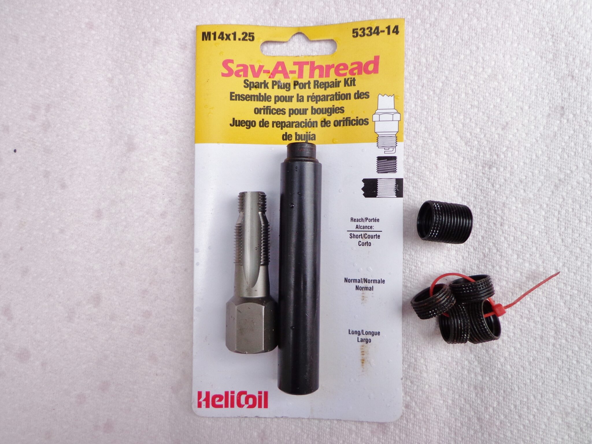

            These steel spark plug inserts are what you want to use, not the regular wire inserts used for thread repair.
            DSC00834

                The Sav-A-Thread inserts can be used with both tapered and gasket style seats. They lock into the head, don’t leak, and have better heat transfer characteristics than the regular wire inserts which can wind out of the head, leak, and require a change in the spark plugs heat range. All in all, they are a better mouse trap!
                #260546
                  I see serrations on the inserts you show but please explain how those “lock.” We used to use solid inserts with gasketed plugs for awhile. Almost every time, when you removed the plug, the insert came out with it. It was maddening so we went to wire inserts.
                  #260552
                    the installation requires the insert  to be punched to lock it in place. ..if I remember ok   I installed one years ago on a cyl head  on a 7.5  AD   it   worked great
                    #260554
                      To install these inserts, new threads are cut in the head with the provided tap, red hi temp silicone is applied to the threads on the insert before screwing it in, then the serrated part of the insert is expanded by using the large punch which is included in the kit. The punch has a taper on it which does the expanding.  I find one or two good blows with a two pound hammer does the job. After the insert has been set, clean up any excess silicone and allow it to set up before installing the spark plugs or running the motor and you are done.
                      For the record, I’ve never had one of these inserts back out when removing the plug but I have had the wire inserts come out with the plug. That can be a pain as now the wire insert is tight on the plug and can be a bear to remove.
