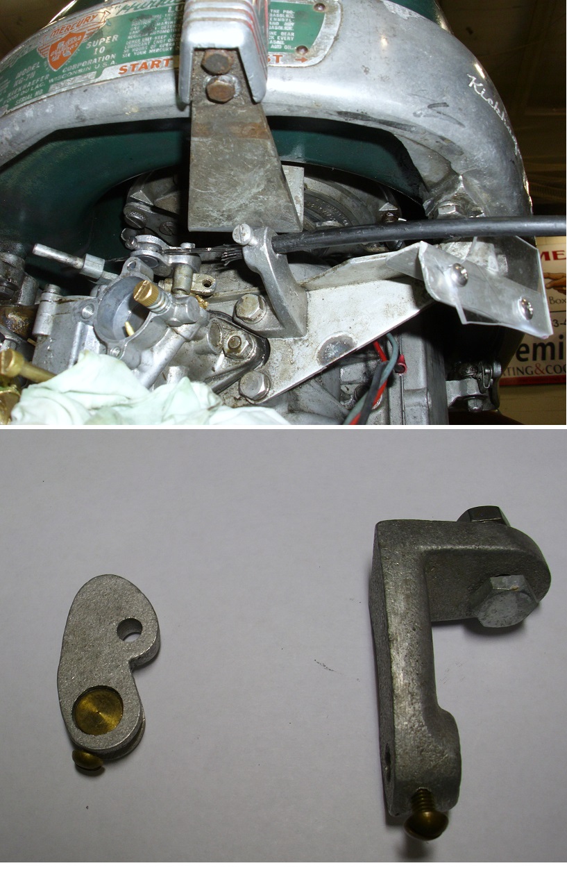

        John Schubert
          Contact Frank Erion, in the directory, he has the throttle pieces that you need. They are reproduction Mercury factory style. One piece fits in the bottom of the throttle shaft & the other, an "L" bracket attachews to the port side tank mount with holder for the outside bowden cable.

                  I have the kit to hook up the cable to the
                  throttle plate. Its new/never been used. If
                  you would be interested send me a PM.
                  #63822
                  squierka39
                    The above set being offered is what you want. I have the same setup on my KF-7 on a mini max and it works perfectly.
