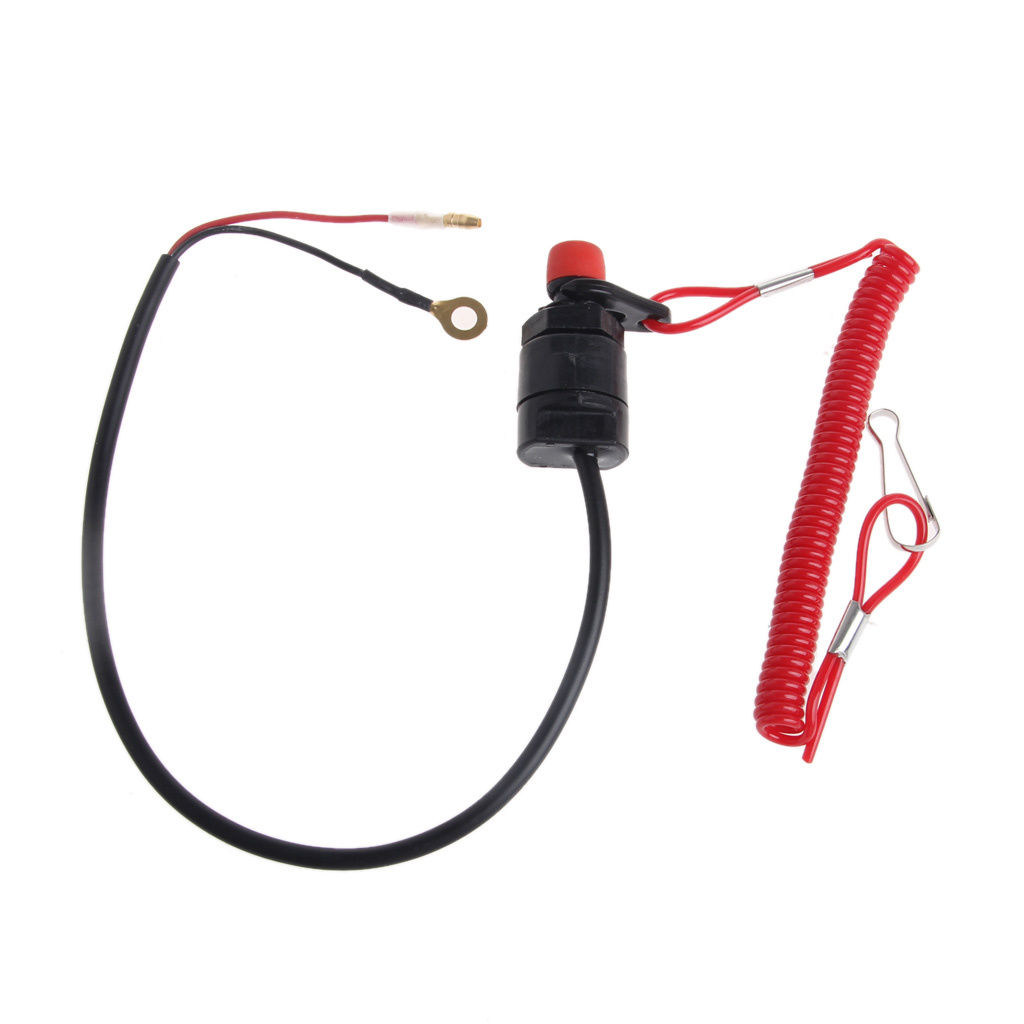

              #69214
                I think these are what you want. Less than four bucks each CDN while avoiding the middleman and with free shipping to your door! You just gotta wait a while longer for them to arrive.
                If you shop Ebay for them, study the photos and description carefully as some of them are designed to mount on round handlebars instead of poking thru a hole in your motors cowl.
                https://www.ebay.ca/itm/Safety-Tether-L … 1a2d2a5d27

                  #69216
                    quote Mumbles:
                    I agree safety wise but this for my 6r74 & it will likely become just a kicker along side my Etec I won’t be hooking myself up to it and I want something solid and un-obstructive

                      PugetSoundBoater
                        I ordered a few of the switches Mumbles shows in his response. They work great, and when you take the lanyard with you when you leave the boat at the dock overnight, the switch becomes an anti theft device ,motor won’t start.
                        Placed my switch on the bottom of the cowl below the carb,can’t really see it down there. I’m real happy with these switches.
