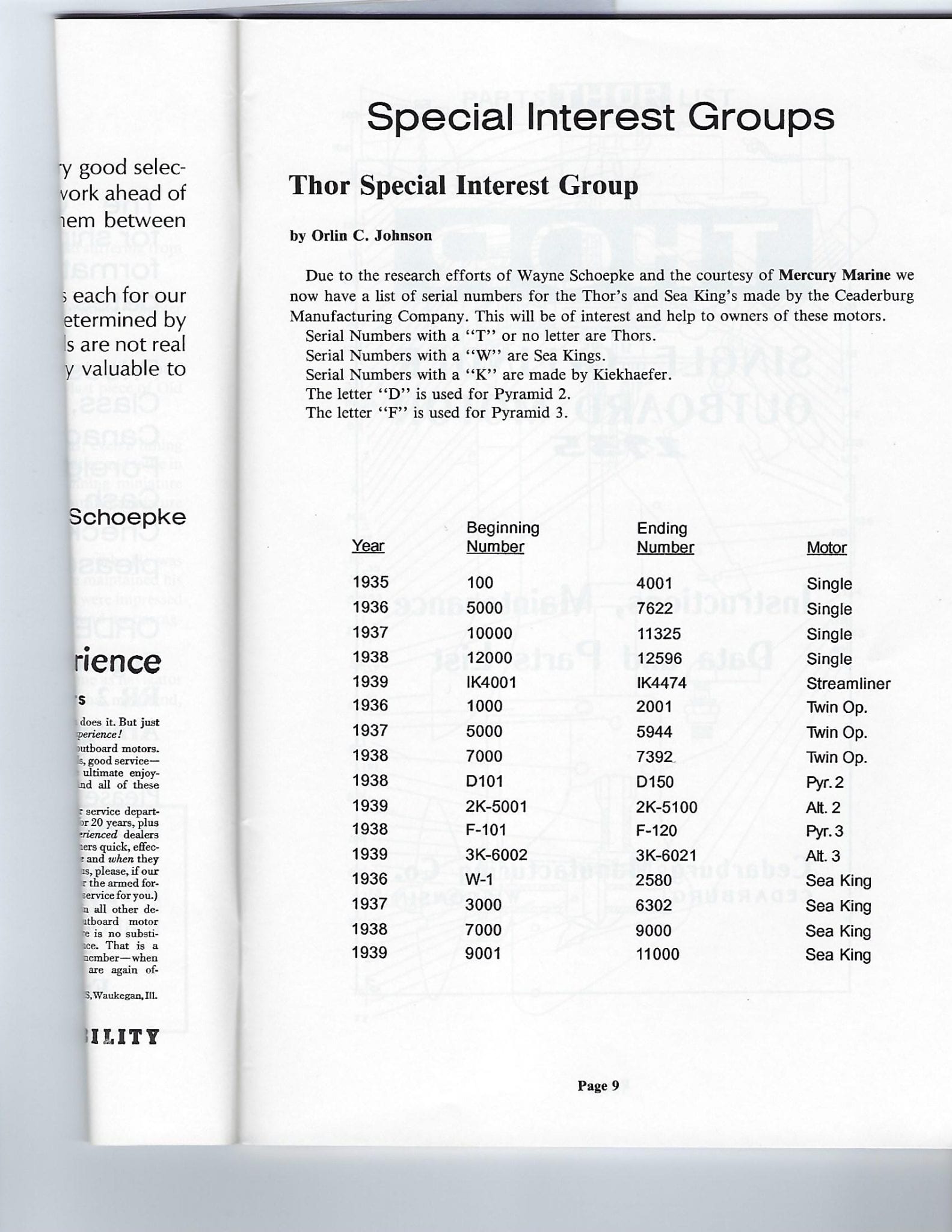

                With a great many thanks to “ART DEKALB” and using his AO magazine index, I was able to look up
                More info on THOR Motors. I will see what issues I have and scan them & post to this site.
                I wish more members would take the time to scan the information they have and post it for all to use
                And learn from! The club also needs a place or person to send information to be scanned to be
                Cataloged and posted to this site, as it is much lacking in this regard!
                AO Articles on THOR Motors can be found in the following issues.
                Jan 1966
                Jan 1970
                Jan 1996
                Jan 1997
                April 1980
                April 1985
                April 1989
                April 1994
                April 1999
                July 1967
                July 1980
                July 1984
                July 1994
                Oct 1983
                Oct 1986
                Oct 1988
                Oct 1993
