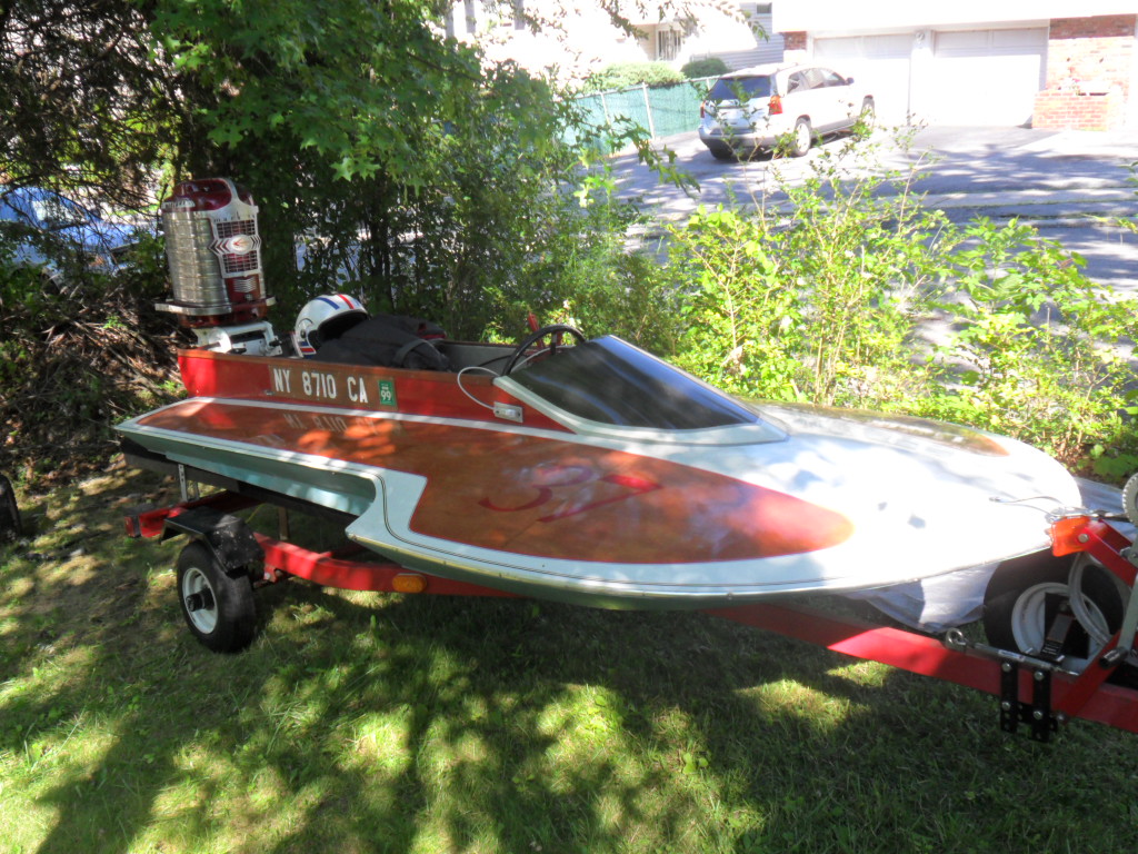

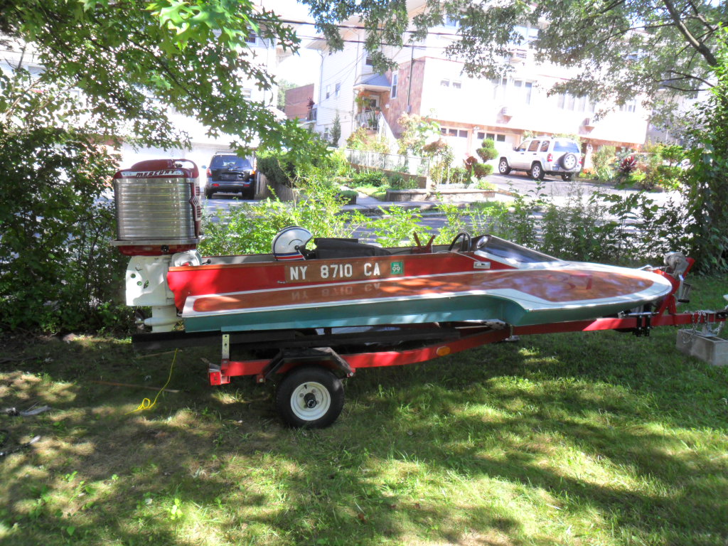

Mocking everything up for the first time.
Still need to get the front seat recut, then assembled, but man, putting this all together tonight just put a big ole grin on my face.I can finally run the steering cables and everything else necessary to knock this out and get it on the water. I also need to find longer control cables for the throttle and shifting box.
August 13, 2016 at 1:39 am #41988Looks great Evan!
August 13, 2016 at 2:38 am #41994Looks good, I need pics of my Feather Craft transom after I beefed it up to hold the 40/50hp. It’s stout with the 3/16" tempered aluminum addition.
August 13, 2016 at 2:43 am #41995That green panel on the back isn’t going to stay, I’m going to see if I can get a 1/8" plate lasercut that covers most of the bolt holes in the back. Try and tie the entire transom together.
August 13, 2016 at 2:50 am #41996fantastic job on the fabrication and assembly. I enjoy the process too. Also, I find it comforting to know everything is ship shape and safe ’cause you’ve gone through it all. Rigging the steering is fun, and kind of challenging the first time .Could have used three hands. On my 16 foot Crestliner,I agonized about the geometry and mounting location of the pulleys for hours in fear of drilling extra holes. The boat steers pretty good, so it was time well spent.

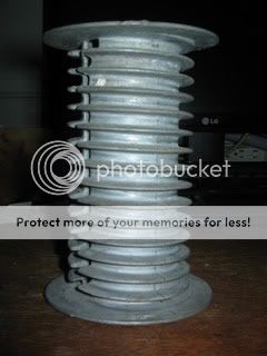

Hope your spool is in good shape,
http://vid635.photobucket.com/albums/uu … 586b22.mp4
August 13, 2016 at 3:42 am #41998Wedgie, I’ve got two spools, actually. One similar to that one (although maybe 2/3 the height? I haven’t counted the twists on it and don’t have the diameter) the other is more like a pulley’s sheave in that there are no grooves on it. I’ve posted pictures of the second one in my other Herter’s thread. The one that’s like yours has a little hump in it where it looks like someone tried to pry it with a screw driver for some reason. No clue which I should use, or why.
