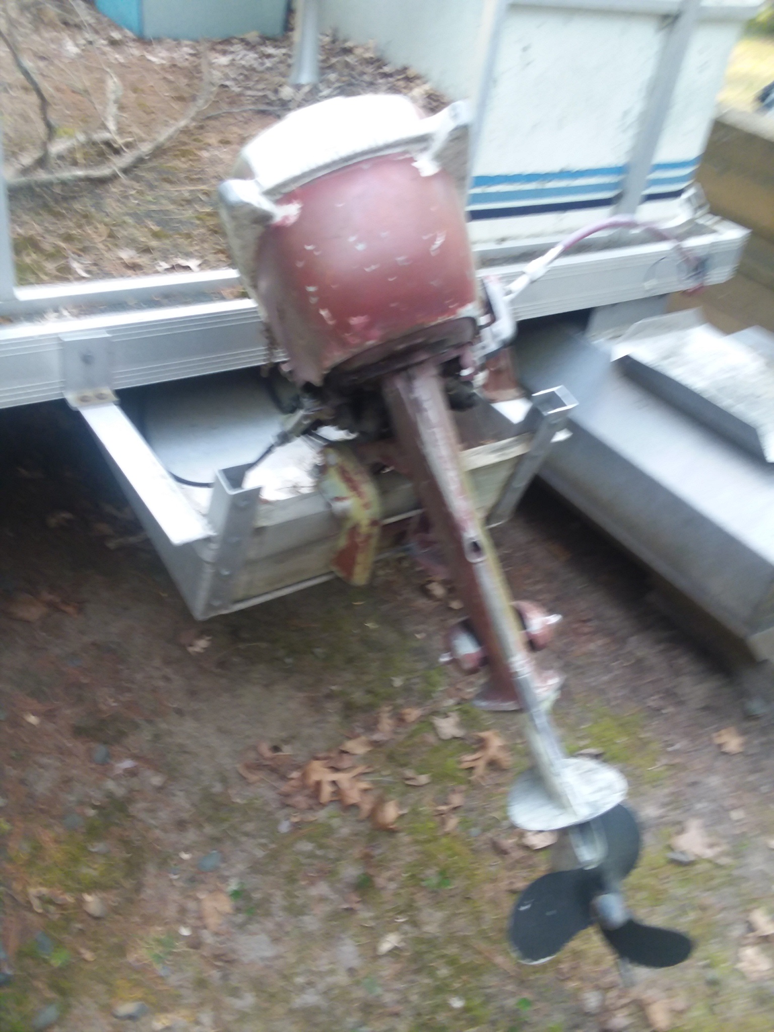

      What would be acceptable compression on a circa 1958
      Johnson 18 hp? Some kid wants to use it as a partial trade
      on a motor I have. It looks like it’s been on that pontoon
      boat since water was invented.
      Thanks,
      P.S.- in looking at the photos I’m wondering if it’s older yet?
      Almost looks like a green Johnson under that maroon!
      #76264
        It’s hard to tell from this angle but I think it’s a ’57 hood sitting on it with an Evinrude gearcase.
        #76265
        chris-p
          Its a ’57 Johnson. Like Mumbles pointed out, looks like the gearcase MIGHT be different. If I had to bet I would bet on Evinrude due to the prop on it.
          That green that you see is the chromate primer.
          #76270
            Thank you knowledgeable gentlemen!
            Don’t think I’d credit him a whole lot
            on the trade, but I suppose it has potential!
            #76282
              Yeah, looking to be a 1957 model. Sure looks like it has had a hard life indeed, especially on that stupid pontoon rig. I’m guessing you should see around 100PSI for compression. I would check/drain the gear lube also, look for water. Pontoon duty may have really messed up the clutch dog/forward gear as well….
              #76284
              chris-p
                Forgot about your main question!
                Definitely the 18s are over 100 psi on a good motor. I have literally had hundreds of the 18s. Not uncommon for good ones to have over 120 psi.
                My GUESS is new they have around 140 psi. I have one motor that is almost NOS. Ran very little. It is a 1957 Evinrude 18hp. The bores still had original cross hatch. All I did was install new rings, at it was sitting at 140psi.

                  #76301
                  theodore
                    A young man taking an interest in old outboards? I would go out of my way to help him. Just like someone did for me long ago……
                    #76341
                    hdted
                      I had a 1974 25hp NOS motor still in the box. It had 140 psi cranking pressure. I don’t know if there was a difference between the 18 and 25, but they were both 22 Cubic inch motors.
                      #76493
                      David Stanton
                        That green peeking through could be an old camoflage paint job for duck hunting that was later painted over. Hard to tell from the photos.
