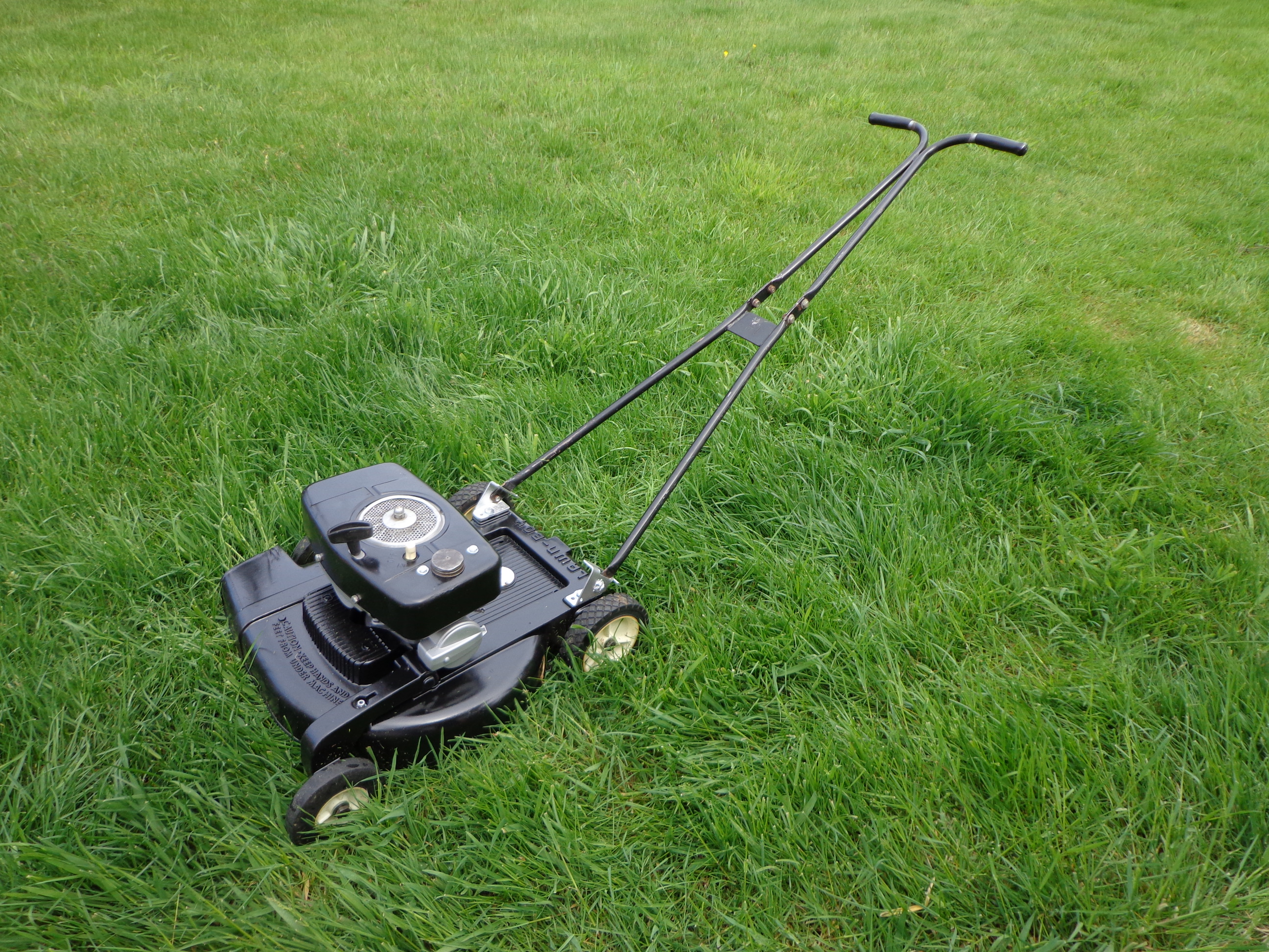

                        Lawn Boys rule!
                        This ’59 deck with a later D series motor on it uses 16/1 fuel mix and is virtually smoke free!
