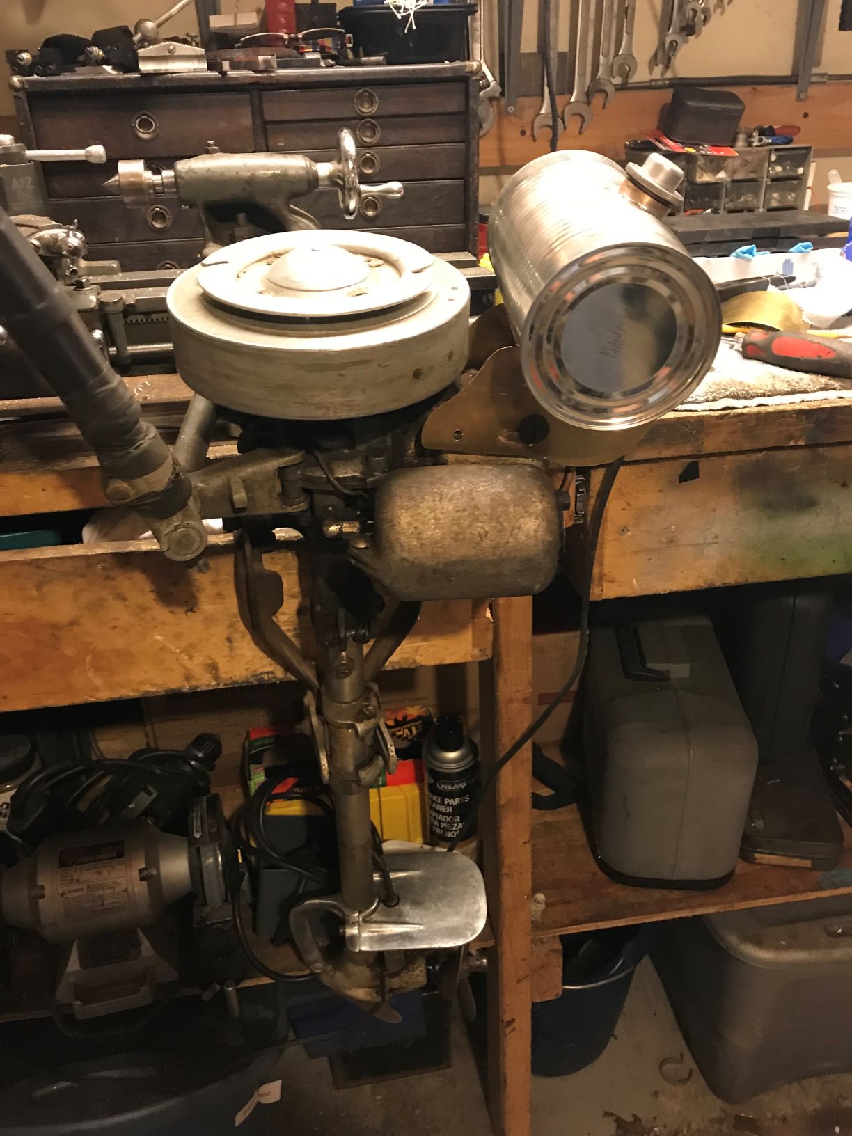

                    You might be amazed how easy it is to solder to a pineapple juice can.
                    Just for reference, I’ve had several of these J motors, and none of them ever had a decent tank. This one came with one that was completely unusable,including the filler neck. But I wanted to have one to run, and this one runs great. See below for the copy for the intended decal, if I can ever get my printer working correctly. (The tank is currently bright orange.)

                      I love the juice can fuel tank! The decals are pretty great too (OJ-70) lol. Very nice!

                        Nice job on the fuel tank. I’ve seen beer keg gas tanks on motor trikes but never a juice can tank on an outboard! Bet it looks really sweet (pun intended) painted bright orange!
