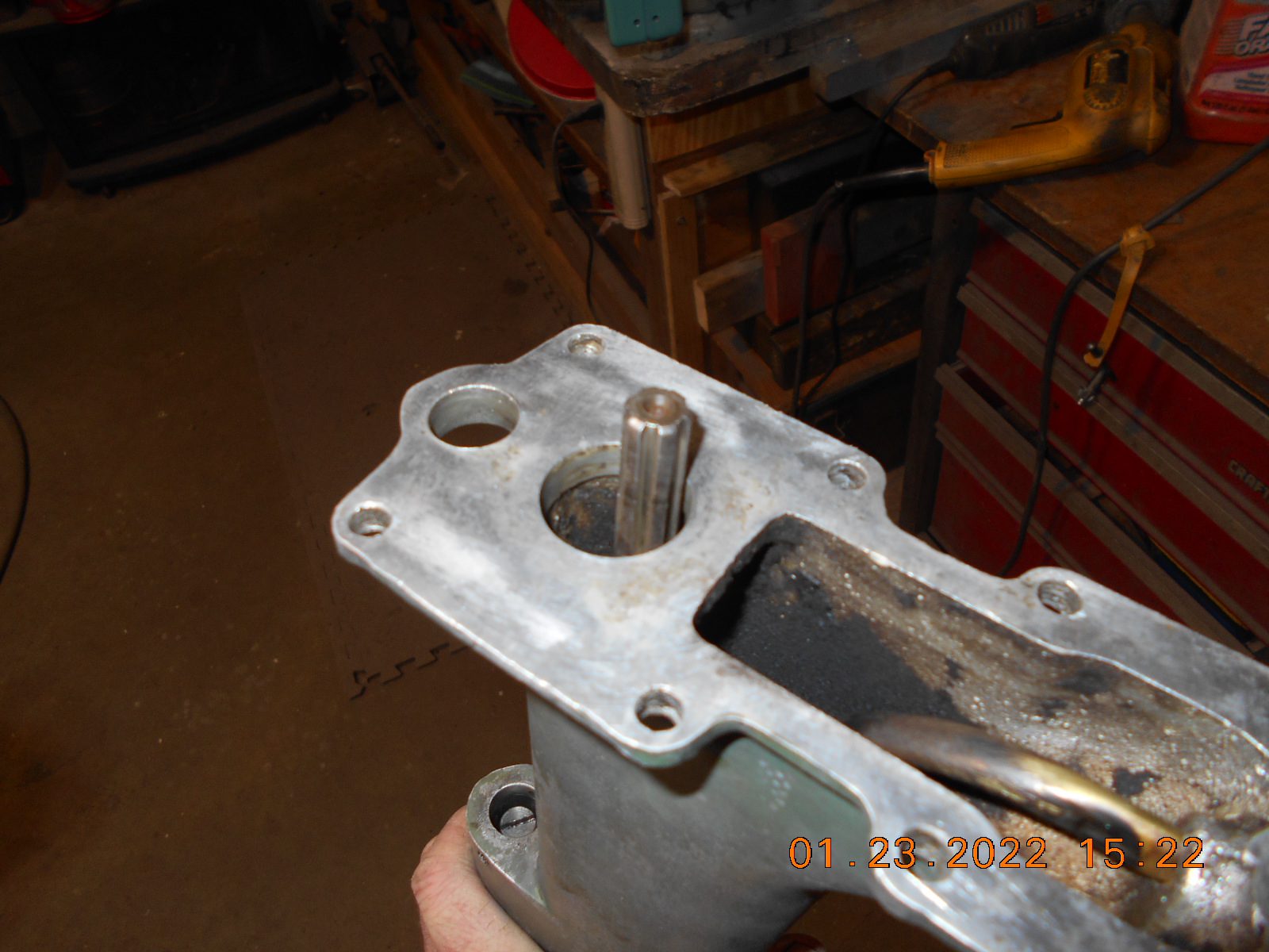

      At the end of the day, after I got it back together, I wanted to put this little Elgin lower unit in
      a bucket of water to see if the sliding vane water pump is going to pump.
      It’s a 7/16″ diameter driveshaft, but for what ever reason, my 1/2″ drill chuck won’t
      clamp down on it. The driveshaft turns relatively easy by hand, so that’s not a problem.
      No socket will engage the splines either.
      Anyone have any good “hacks” for spinning driveshaft with a drill?
      I don’t want to pound anything over the end of the driveshaft, such a piece
      of wood with a hole in it, for fear of damaging the “non metalic” sliding
      vane in the water pump.
      I don’t believe I have a good way to machine an internal spline in round stock
      to make an adapter…… nor a bad way that I can think of right off!

        I’ve used a universal (gator grip) type socket.
        https://www.homedepot.com/p/Gator-Grip-3-8-in-Universal-Socket-with-Power-Drill-Adapter-ETC120A/100351756

          slide a piece of hose on DS then a bolt with head cut off into the hose then drill, if needed use hose clamps.

            That’s a much cheaper hack than mine!

              Thanks, both good ideas. I’ve never seen the Gator Grip, but I have
              odds and ends of hose and clamps, so will probably try that. It only
              has to work for about 20 seconds if all goes well.
