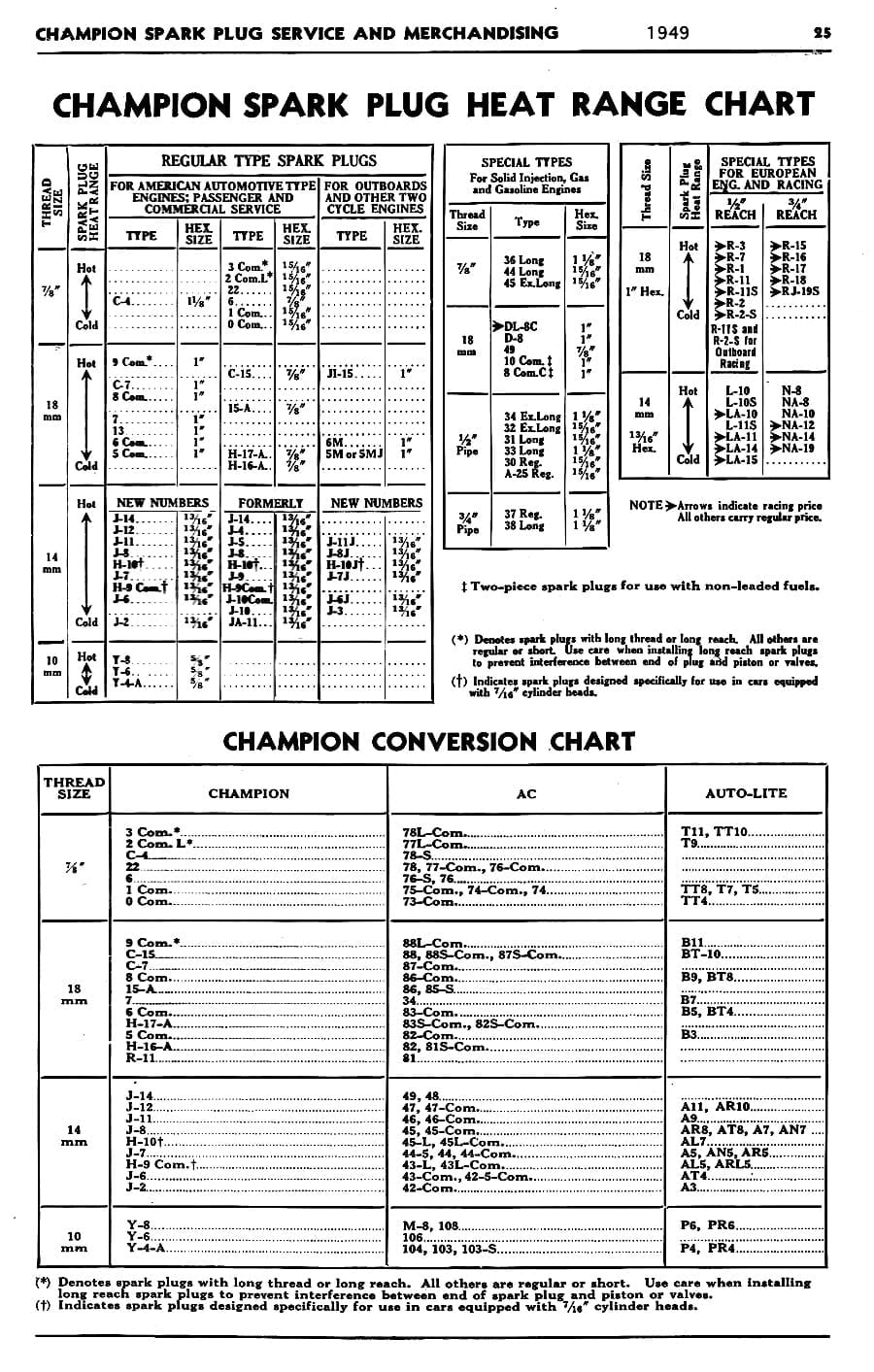

            Are your plugs holes 18 mm?
            According to this chart, a 5M Champion, which I assume
            is the same as a M5, is 18 mm, and is on the cold end
            of the heat range.
            Champion-Spark-Plug-Charts
            #196658
              I see RD16 is 18 mm, but a resister type plug, which I’m told to avoid in magneto
              type outboards.
              This chart say you need a Champion 509 or D9…..
              Champion-Spark-Plug-Replacement-Chart
