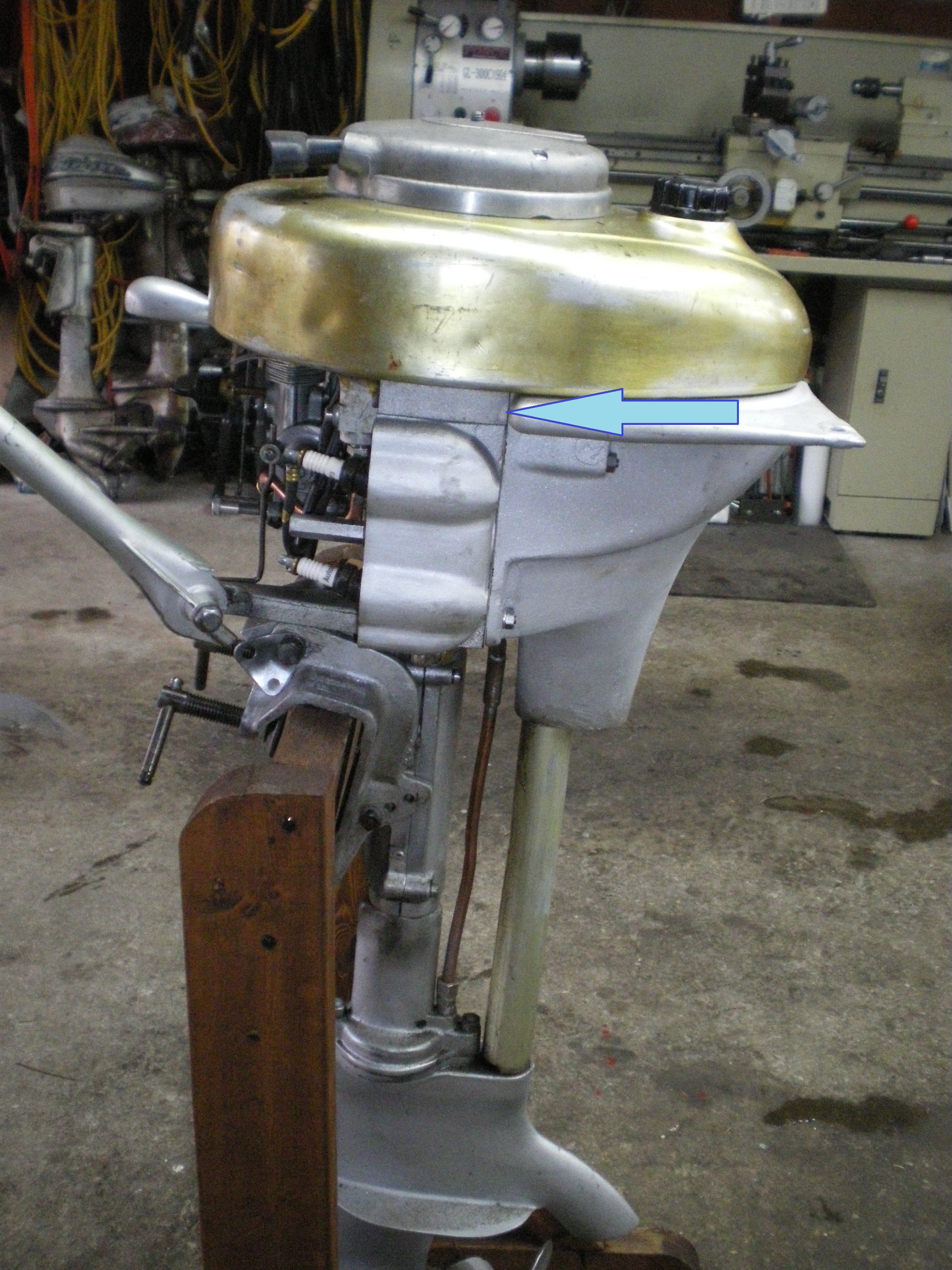

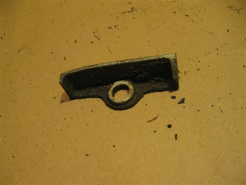

      I’m restoring an old Lightfour. Can anyone tell me where the part in the photo goes?

        I can’t say for sure but I think it’s the little filler piece which bolts onto the top of the port side cylinders. It’s a decorative piece to fill in the gap as this bank of cylinders is lower than the starboard side bank.
        #70524
        chacha53
          Just checked and yes! That’s it!
          Thank you very much.
