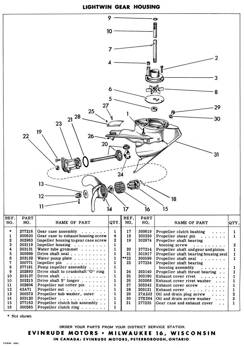

              If someone who didn’t know what they were doing has had it apart and lost, or not installed the thrust bearing properly(#24) in Garry’s picture, it might let the pinion gear drop off the driveshaft and allow things to spin. Just a guess.
