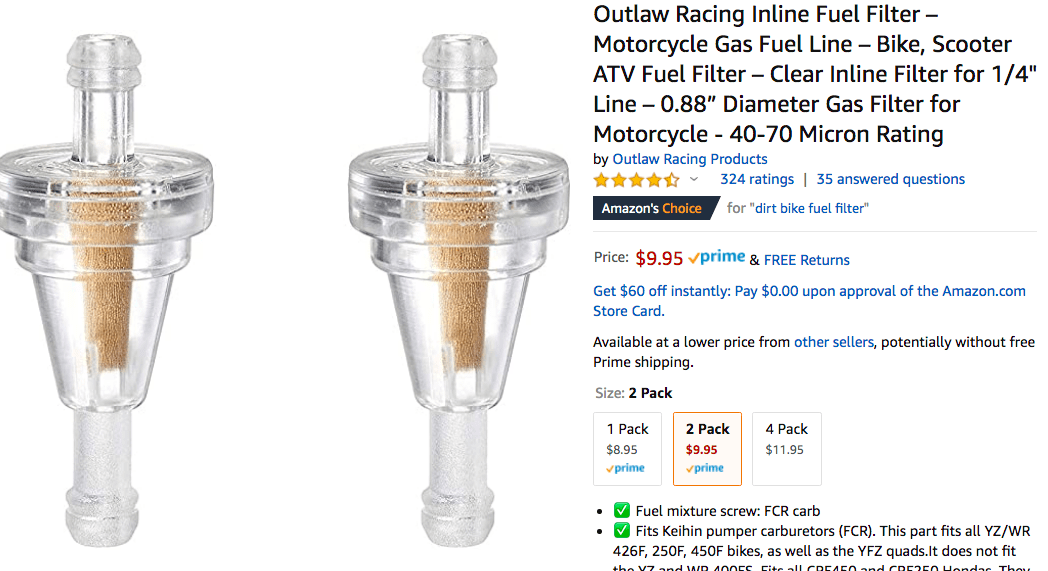

                        If you decide to go the inline filter route, if you search on Amazon for B009E1MWVG, you’ll find a kind that’s worked well for me on other motors.
