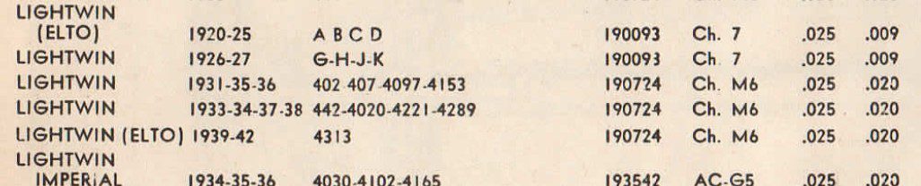

            The 1942 Service manual says a Champion M6 plug gapped at 0.025 and the points at 0.020.
            Screenshot-2022-06-11-212022
            If you are having spark issues even after cleaning and setting the points, there’s a good chance the condenser has gone bad, especially if it is original.
