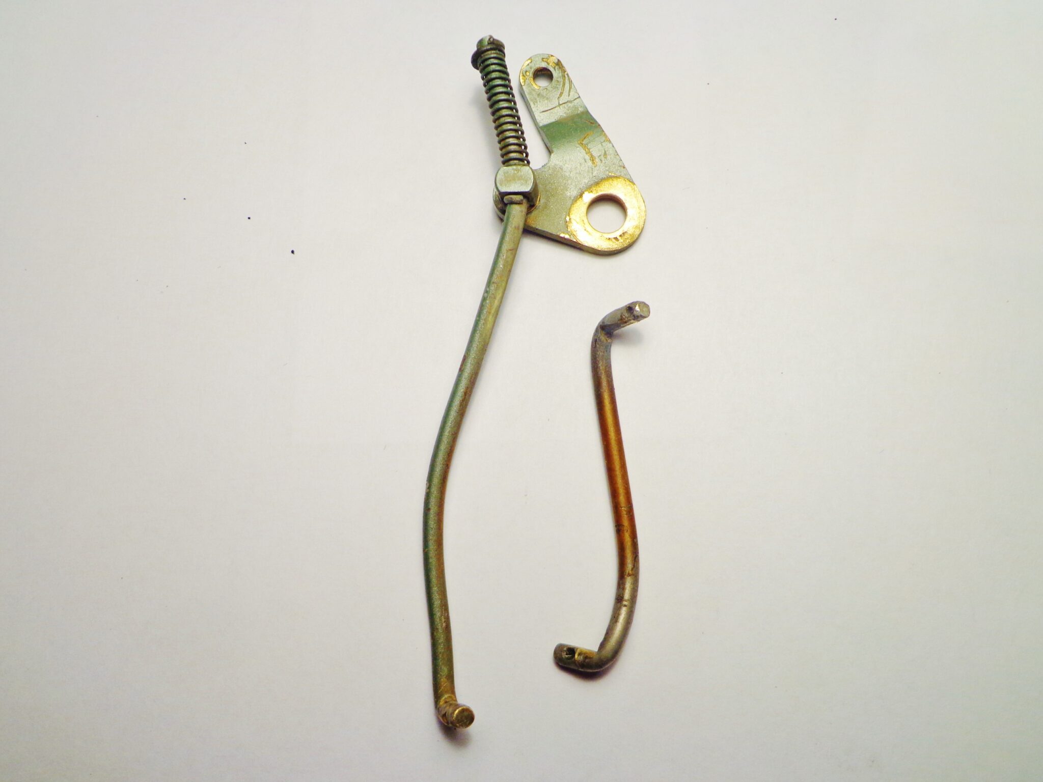

          There should be a small piece of stainless wire bent into an ‘S’ shape at the ends of the brass rod connecting the carb to the mag plate. A small pair of side cutters are your friend here to get it straightened out and removed.
          TN-Mag-Linkage
          #254423
            to re attach   you can use small SS wire  from the hobby store goodies  or   I have used small  fishing swivel snaps .. I just cut-off the  swivel part part and keep the “safety pin” portion of the swivel 🙂      you surely have a few spares  in the tackle box .
