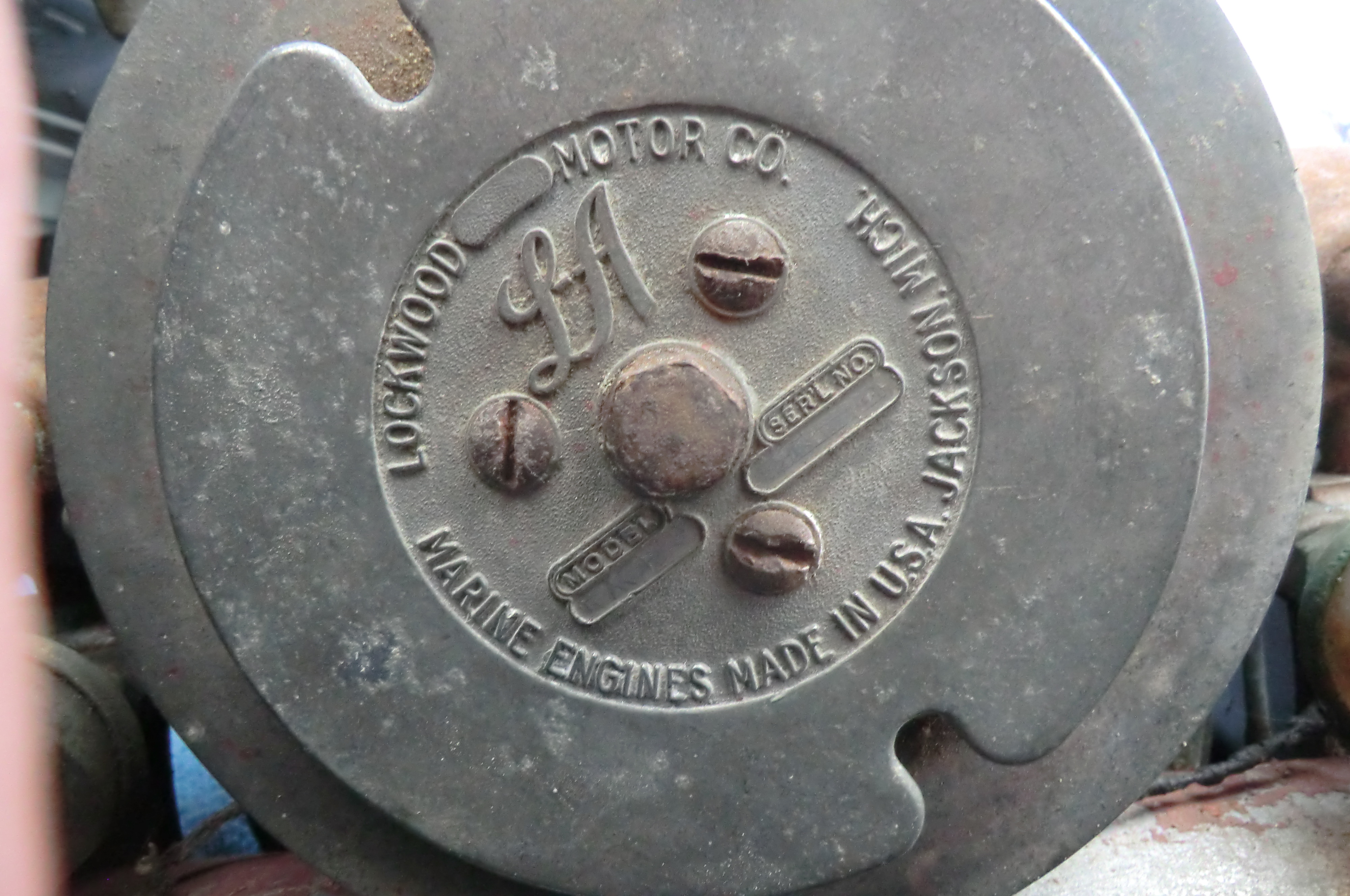

T2March 3, 2016 at 9:50 am #32828Wow, lots of info there T2 thanks! The prop has some build up on it and can’t really see any markings but may become visible later. It looks to have set awhile so I’ll let the PB blaster do its job before I start wrenching on anything. Good news it’s not locked up. Hard for me to get started on it with another project going but you all know how that is. It does have the Lunkenheimer oilers. The flywheel does have LA stamped on it. I can get some better pictures as soon as I get this new computer figured out.

If you provide the outside diameter of your flywheel I can solve the riddle of whether it s a service flywheel or not. The picture makes it look like its an Ace wheel, but measurements will settle that. Do you have a link for the pictured motor you’re referring to on the Ashland site?
The rope sheave should not have a model designation on it, it should just have the manufacturer name and location on it. That’s because on the Ace rope sheaves, Lockwood did not indicate the model designation there, it was only on the crankcase just above the carburetor mounting collar.

T2March 3, 2016 at 4:33 pm #32843The flywheel measured at 8” and does have a place for model and serial number on the rope sheave like the ’28 chief sheave at this site http://www.ahlstrand-marine.com/ under outboard museum then antique motors for sale. The motor is in a bad place and pretty dirty right now. I’ll have to try and find the numbers later. I did see the number 520 at the front bottom of the crankcase.

Ace flywheel = 8 inches in diameter
Chief flywheel = 9 1/2 inches in diameter
So you have an Ace flywheel with a Chief rope sheave. You just need to swap rope sheaves to make it correct for the BR.
Number 520 at the base of the crankcase is consistent with how the 92BR’s were marked from the factory. Mine is #550
