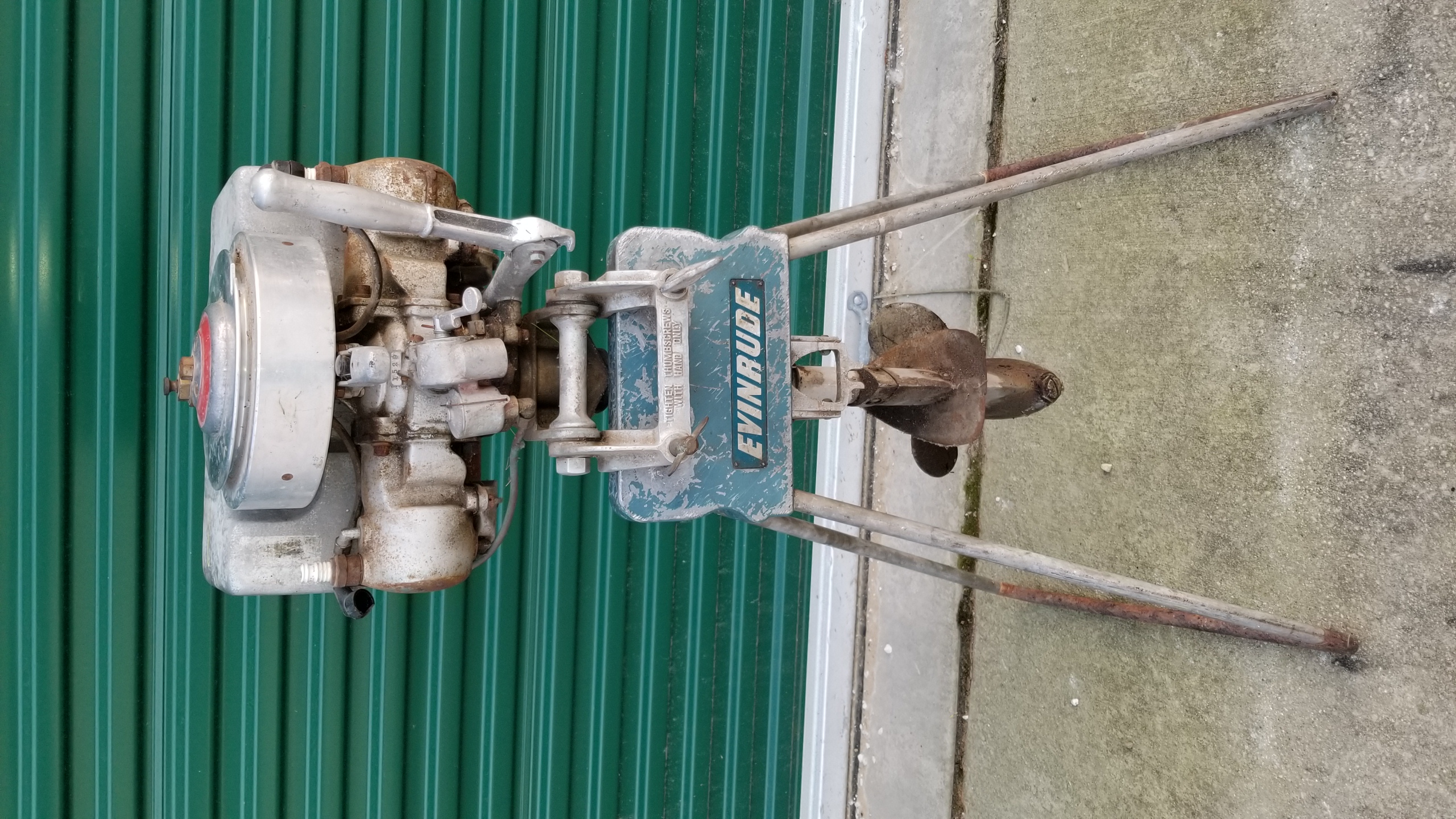

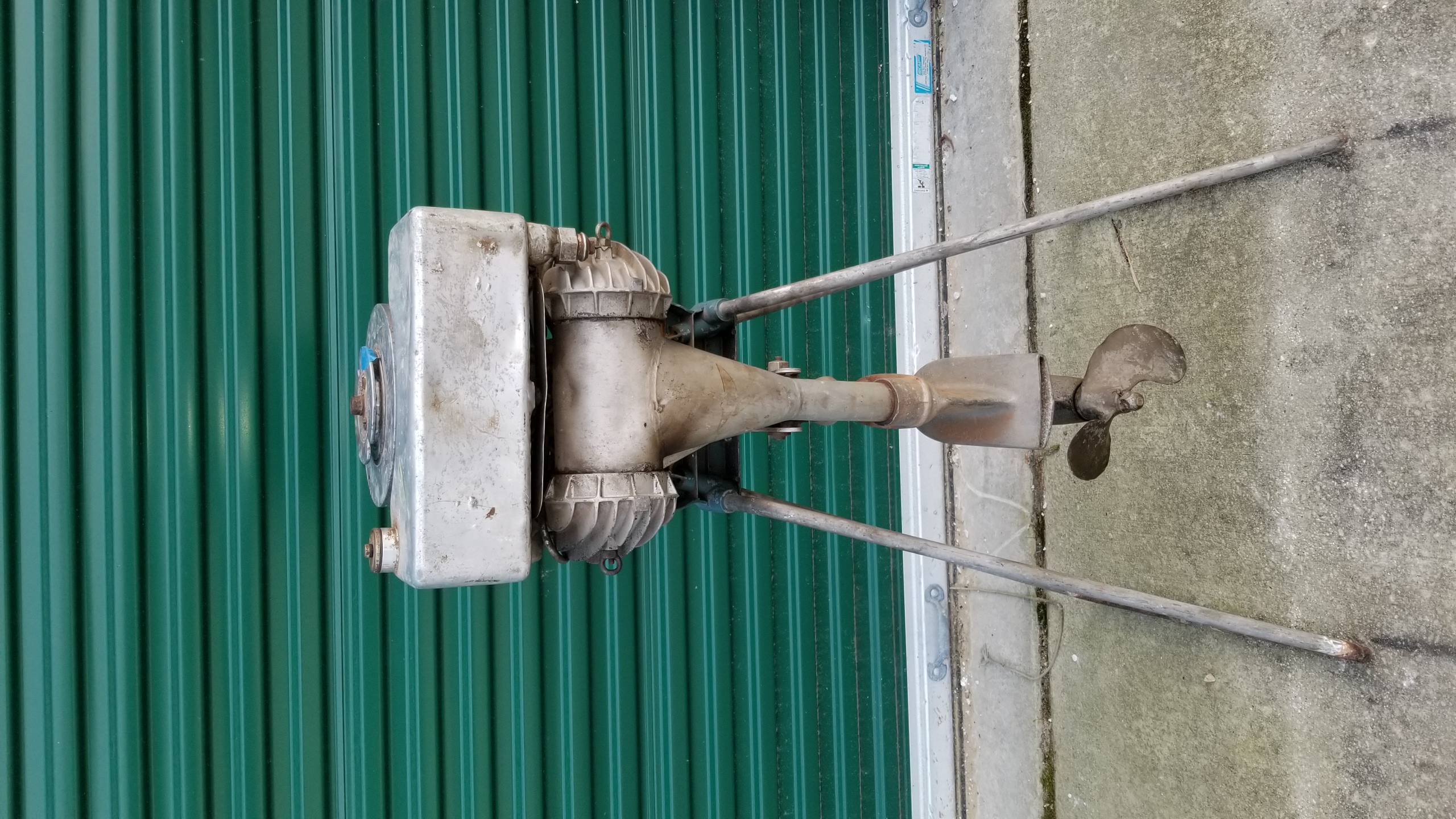

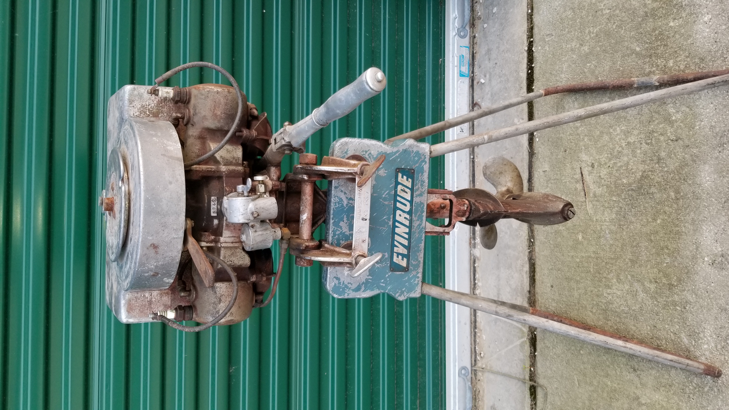

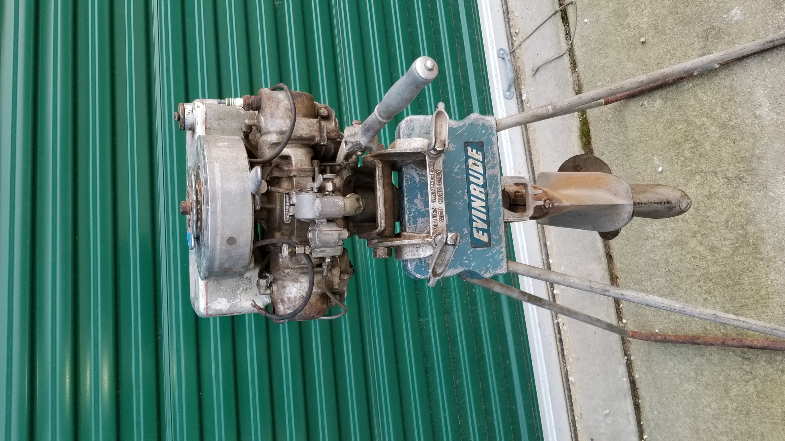

      I picked up three Lockwood outboards at an auction yesterday. Each one has its issues. I believe them to be a 1930 Ace, 1927 27T, and the third is a mystery to me.

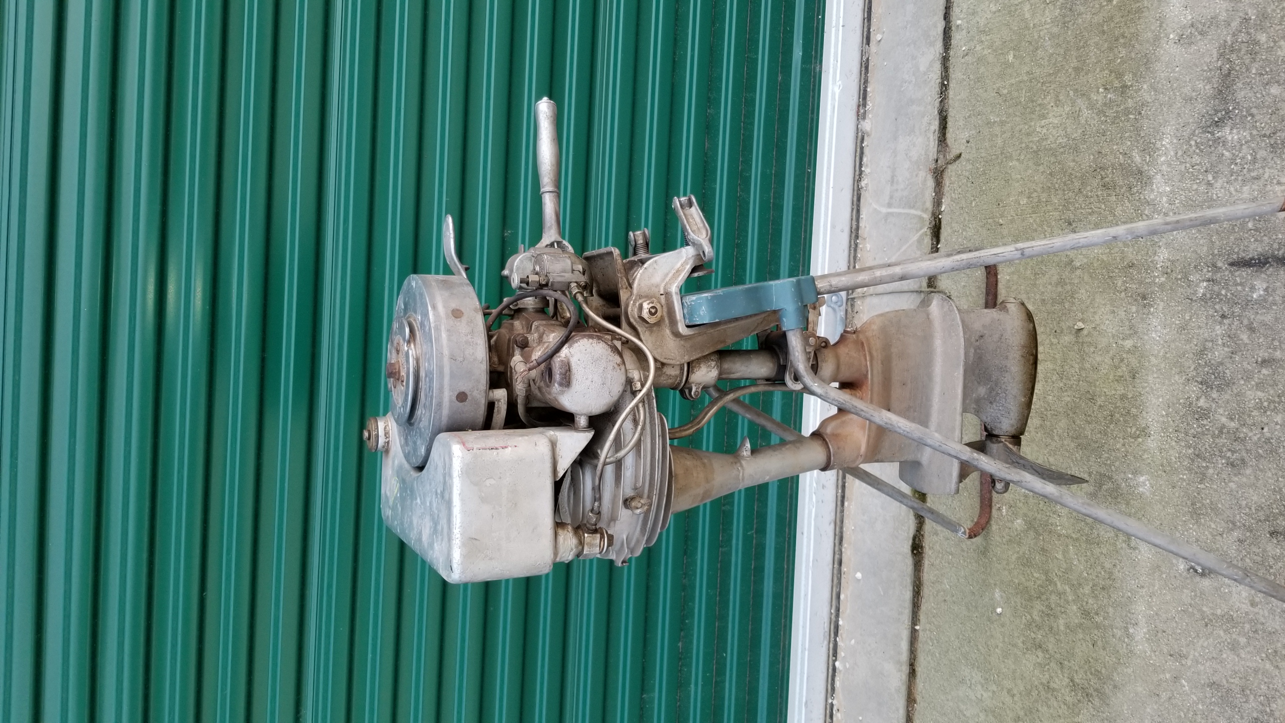

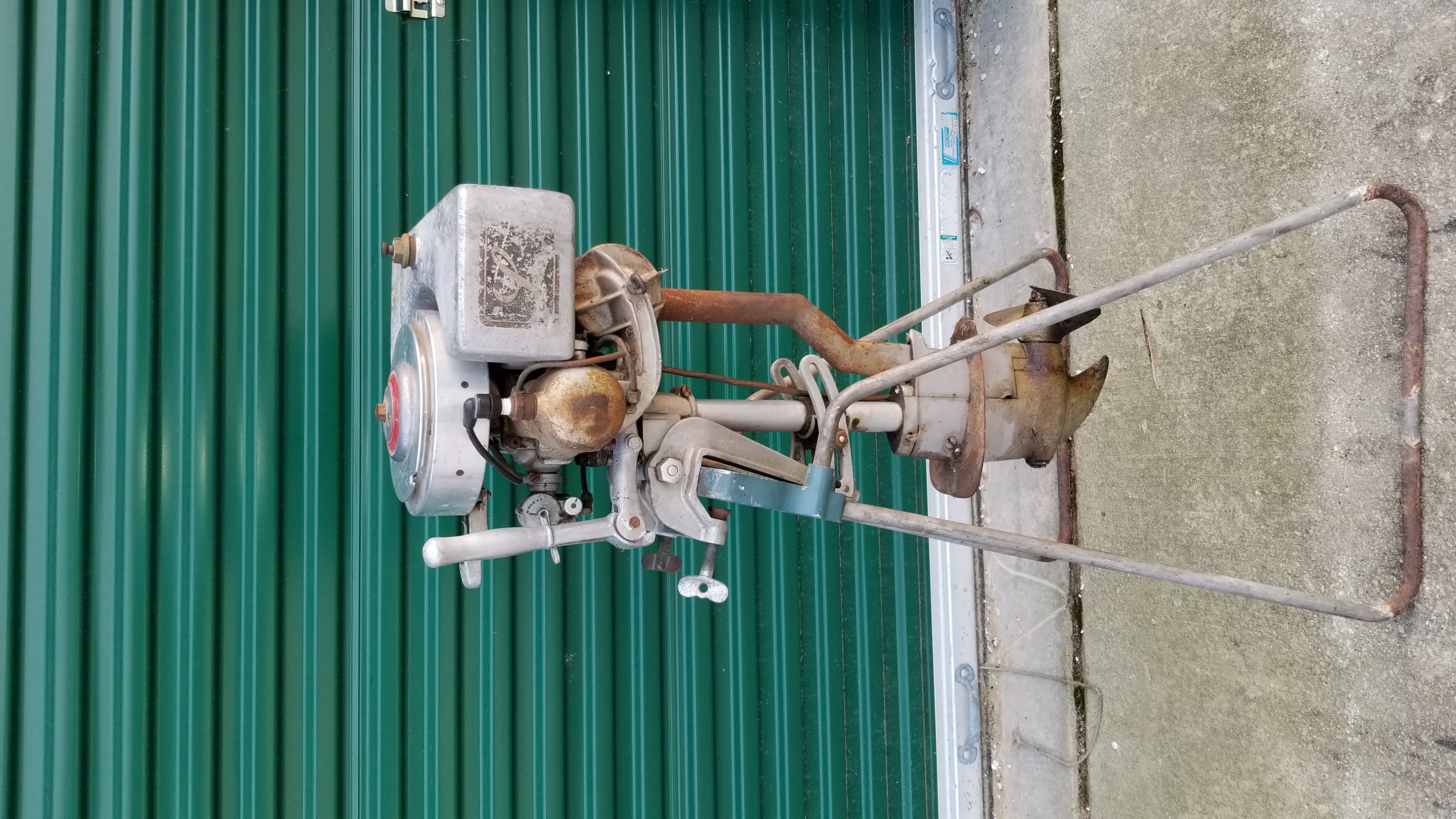

        Third Lockwood I can’t identify. Thanks.
        #81171
        PM T2
          I think you will find that the third one is a 62T that has had a Caille/Motorgo ignition transplanted onto it.
          Also has underwater exhaust grafted on as well. I’m not aware of Lockwood offering an exhaust conversion kit for that model.

              Thanks for the info PM T2. I had no idea that the one oddball was wearing a Caille flywheel.
              #81233
              PM T2
                Right, it is a motorgo rope sheave with the band painted red, and also looks like an American Bosch magneto lever, which Lockwood never used.
