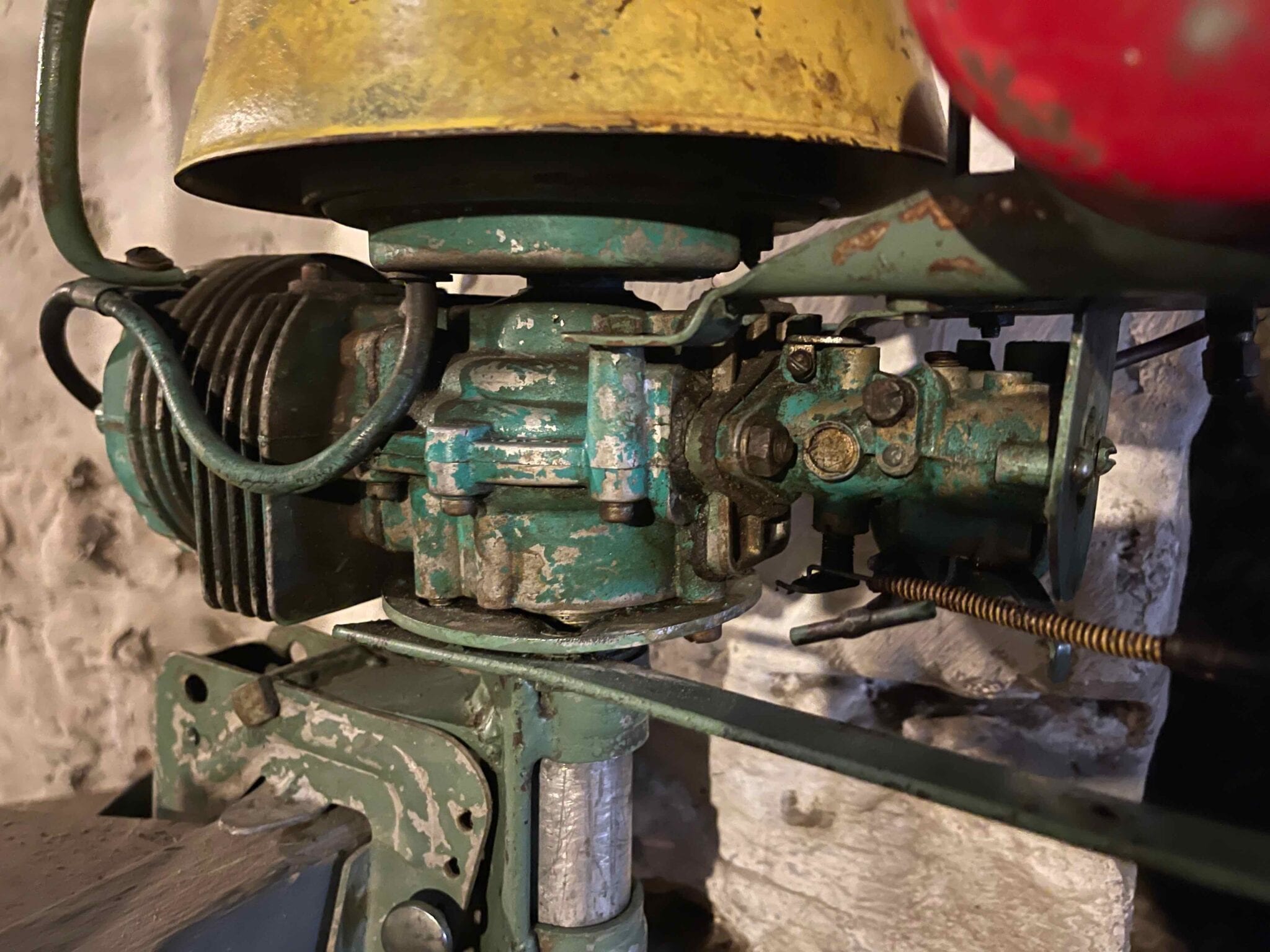

            I have a few concerns maybe you guys could help me out with. I’d really like to run this thing but I noticed a few quirks.
            1. The steering and throttle seem to be pointed in the wrong direction towards the propeller side. Maybe this was mounted at a front of a boat or in another strange configuration? This seems to mean you would have to reach over and behind the motor to try to control it. This also means the spark plug and exhaust are pointed in towards the inside of the boat. Could/should I reconfigure this some way?

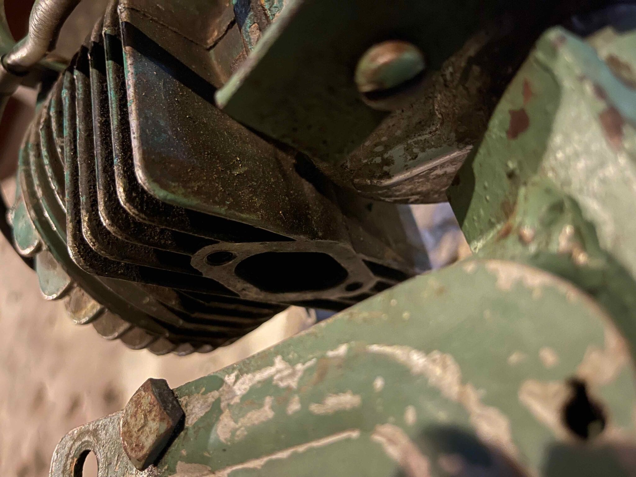

            2. There doesn’t seem to be any muffler attached. The exhaust port is wide open. I see from the lawn mower forums that originally a rectangular exhaust was used with this motor. Is this a problem? Did people run these engines without any sort of exhaust/muffler system in outboard form? Picture attached.
            3. The carb has no filter. That doesn’t seem to be a good thing.
            4. The seller gave me some blue marble oil, but wasn’t sure about the best ratio but thought I should maybe try 24:1. The other motor forums recommend against modern oils due to the type of bearings. Any thoughts on that?
            5. Am I asking for trouble if I try to put this cute motor into service in its current state or is this a bad idea all around for river transport in my city?

              I’m guessing there would have been clearance issues trying to put the original muffler
              on, but perhaps something could be retrofitted?
              Don’t think outboard manufactures worried too much about air filters being
              the motors were run over waterways……not much dust out on the lakes.
              A lot had a silencer cover of sorts though.
              #240731
                If memory serves, I think that motor probably has a brass connecting rod. They are run with sloppy clearances or they will seize. 16:1 or 1/2 pint per gallon.
                #240733
                  A late uncle in Saskatchewan gave me my AH-47 when I was a young teen as it didn’t have enough power to run a grain auger. After returning home from our holiday trip that year, I took the Briggs off our reel mower and adapted the AH-47 to it. This was probably when I lost the air filter as the governor parts were removed to and misplaced (disposed of) around the same time. Growing up near a speedway, I learned early on that an engine needs to breathe and rev high to win races. See the connection? Anyway, when I got the AH-47 mounted on the mower, I had a string hooked to the carb for a throttle control and after filling the tank with gas, I got the motor started and made it about 50 feet before it promptly blew up. I didn’t know they needed oil mixed in with the gas and the aluminum rod grabbed the crankshaft and shattered, something like a 5.5 or 7.5 horse Johnnyrude will do if run hard on anything other than 16:1 mix.
                  A few years ago I found a rough AV-47 at a flea market for five bucks and sure enough, the piston, rod, and reed valve were the same as the ones used in the old broken and archived AH-47. After swapping the parts in, it is now a 16:1 fuel drinking and running motor again sitting on a shelf waiting for a governor and air filter to be complete again.
                  As for the muffler, it’s just an aluminum cast cover which screws onto the cylinder and has a few holes in it. It doesn’t really muffle any sound as there are no baffles in it and you can see the exhaust ports and fire coming out when you look at it while the motor is running.

                    Thanks Buccaneer, That makes sense about the filter. Yeah, mowing lawns would be a much dustier scene compared to the water.
                    #240872
                    tacomancini
                      16:1 it is. Would the Blue Marble be too modern a lubricant. Should I be using straight motor oil of some particular type? I understand that modern oils are designed for different tolerances and types of newer bearings. Any recommendations?
                      #240878
                      tacomancini
                        I think I hear you loud and clear, more air through the carb, and no restrictions with the exhaust and its gonna rip. What oils do you use for the 16:1 mix?
                        And makes sense that the stock exhaust may not be necessary.
