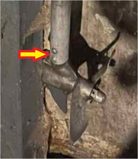

            #240889
              Or, you might be able to undo these screws and spin the gearcase 180°.
              Gearcase
              #240895
              eltoquad
                Check rotation of prop. Maybe the motor runs in a direction with that prop to make it a puller instead of a pusher. That’d be cool!
