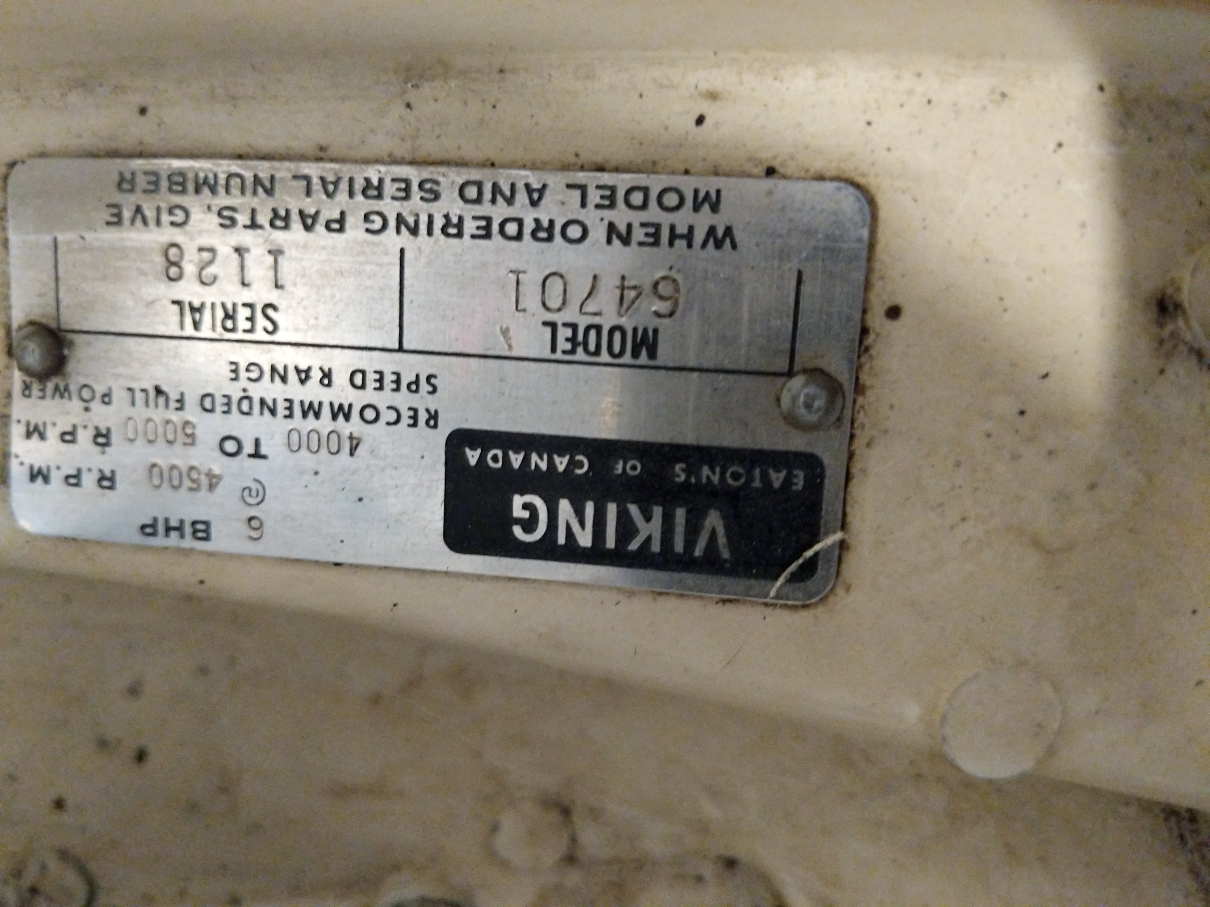

      I got this from a friends father who recently passed away who said it was running a few years ago would like to get it going. I still need the fuel ratio and would like to know the type of sparkplugs and the gaps for them. Basically any information to get it going.
      The model # and serial.
      #76781
        Fuel mix is 24:1 (1/3 pint per gallon.
        Owners manual at http://www.richardlpaquette.ca/Viking%2 … manual.PDF
        #76782
          Recoil starter is missing, but I guess you already know that.
          #76783
          rco
            That is a West bend/Chrysler. 50:1 fuel mix. Plugs should be champion L82C. It would be a good idea to change the impeller while you’re in there.
            #76784
              Your Viking was made by Chrysler’s Marine Devision. They also made Wards Sea King . . . 😎

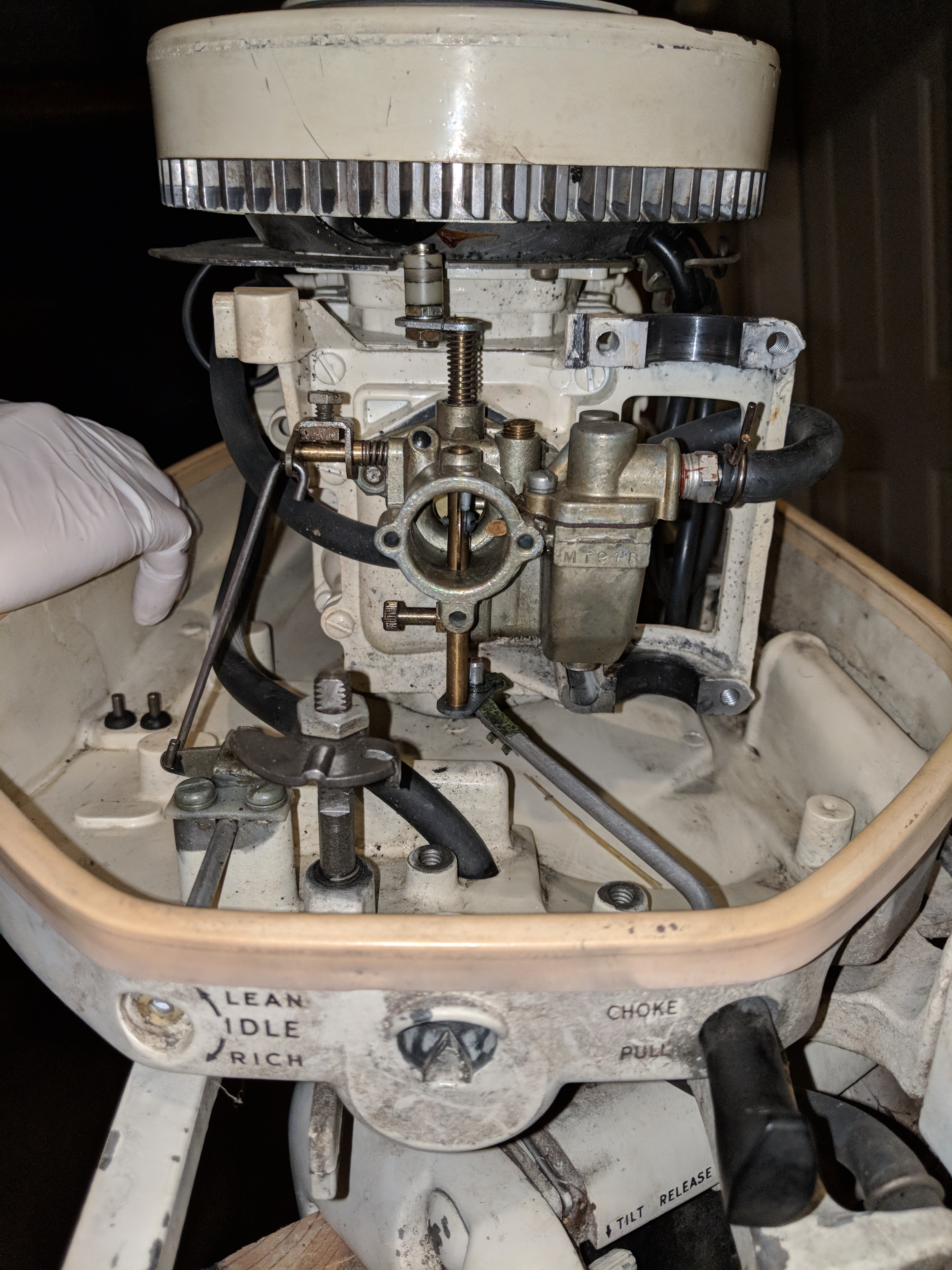

                  #76879
                  madeincanada
                    I have redone the seals on the cylinder heads, the fuel pump and the carburator gasket after cleaning. The motor starts and runs, but when I try and shift the motor shuts off, or if I lower the speed it shuts off. I believe the spark plugs need changing because the fuel does not completely combust.
