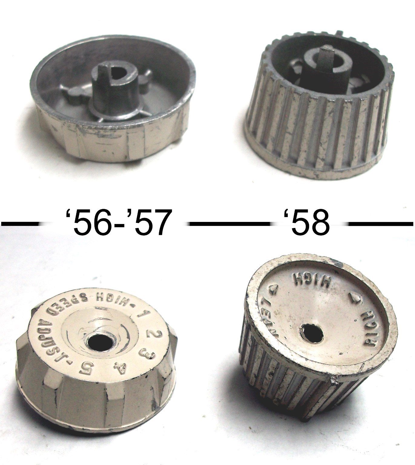

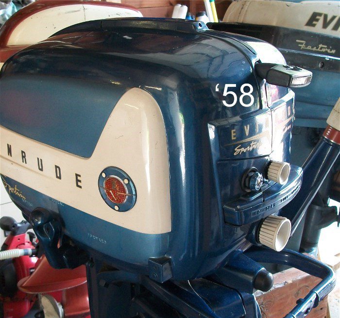

October 11, 2025 at 7:51 am #300533What fleetwin says…and just in case you’re not familiar with what they look like, here’s a picture of a ’58 10 horse just to show you what the ’58 knobs should look like. Same style choke knob, different low and high speed knobs. There might be a slight difference in size between a 10 and a 7.5 but it’s just to show you it’s a different style knob from ’57 and earlier, if you wanted to be original.

October 13, 2025 at 4:22 pm #300576Numbers for the ’58 knobs: Choke 203602 – ebay $20
Low speed – 277873 replaced by 277879 – ebay $15
High speed – Marineengine – 277874 – $10 + shipping bringing it close to $20.As is often the case on ebay, many sellers list items with the wrong part numbers/years/application but at least you have a visual of what they should like and you can compare. If originality isn’t an issue maybe someone has a set from another year for cheaper.

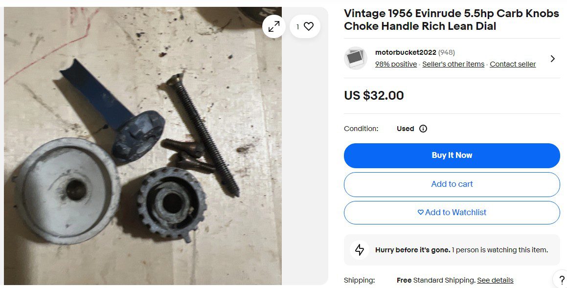

One seller on ebay has the complete set for $32 and free shipping. He has it listed as 1956 but he’s wrong, they’re ’58 style. It also says for 5.5 but they’re the same size for the 7.5. He also only has 98% feedback with comments about slow shipping so buyer beware. eBay item number: 335254242466 – https://tinyurl.com/2hdw6nbw
