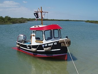

      Here’s a pic of what it will look like completed:

          That’s a cool looking boat! and a great Father-son project! I don’t believe the KF7 has a gearshift, so the Mark 20 would be a better choice. For a boat like that, and an old motor, I’d go with Johnson or Evinrude, maybe a 15 or 18 HP. 10 may not plane it off, maybe a KG7 or a KH7 would, but not a KF7. The old Mercurys were a bit faster back then, but , even when new, required a lot of TLC to keep them runnin’….and they were really noisy compared to the Johnson/Evinrudes. The Mercs also did not have quite the low end torque the johnson/Evinrudes had for planing the boat off. The KF7, with it’s on board gas tank that holds a bit over a gallon, will need filling often. Others can differ with me , but growing up with family and friends having all these old motors around the family lake place back inthe 1950s/60s, Mercurys were noisy and not very reliable until around 1980 (the 40 HP was an exception – that one seemed to hold up well,but was noisy). Dad bought a Mark 25 new in 1958 for boating and skiing on a 14′ aluminum boat and it was the biggest lemon I’ve ever seen, in almost every 2 weeks for warranty repairs. Got rid of it after one year switching to a Johnson. Keep in mind that people who race old Mercurys, or anything else old, rebuild them frequently. The Johnsons and Evinrudes are also easier to work on.

                  Sorry, I didn’t mean to offend anyone by running down Mercurys. I have several of them and will likely accumulate more as time goes by, but for a first time father-son project, I would not recommend them. I love running them on hydroplanes and I think the newer ones (1980’s – on up) are really good motors and helped OMC go bankrupt due to some issues their later motors had. What I said is my one persons "2 hp" on the subject. Whatever motor you end up with for a boat like that, I strongly recommend a gearshift and an external gas tank that holds 4 to 6 gallons.

                    I have a friend who built what appears to be a very similar boat for his grandkids. It is powered by a mid-1980s Johnson 30 (he restores and runs classic Mercurys) and will plane very nicely.
