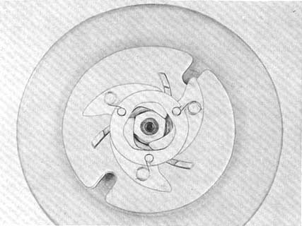

        This kind??

          Yes. I think so. I think I figured out how to post pics. Let’s see. 🙂

                The equalizer ring is also missing. (the round ring on top of the pawls)
                Pawl is part #44-15 (004415), equalizer ring is 42-204 (042204). Somebody here may have some and PM you.
