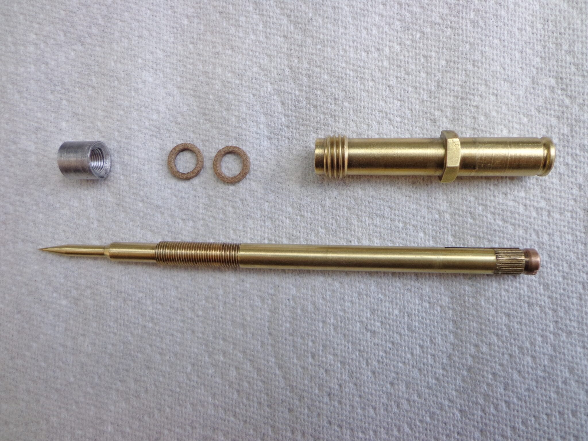

            Also make sure the concave end of the sleeve faces the packing.  It must also spin freely on the needles threads.  If the threads of either need chasing to clean them up, the thread pitch is  usually 1/4 X 40.
            DSC00943
