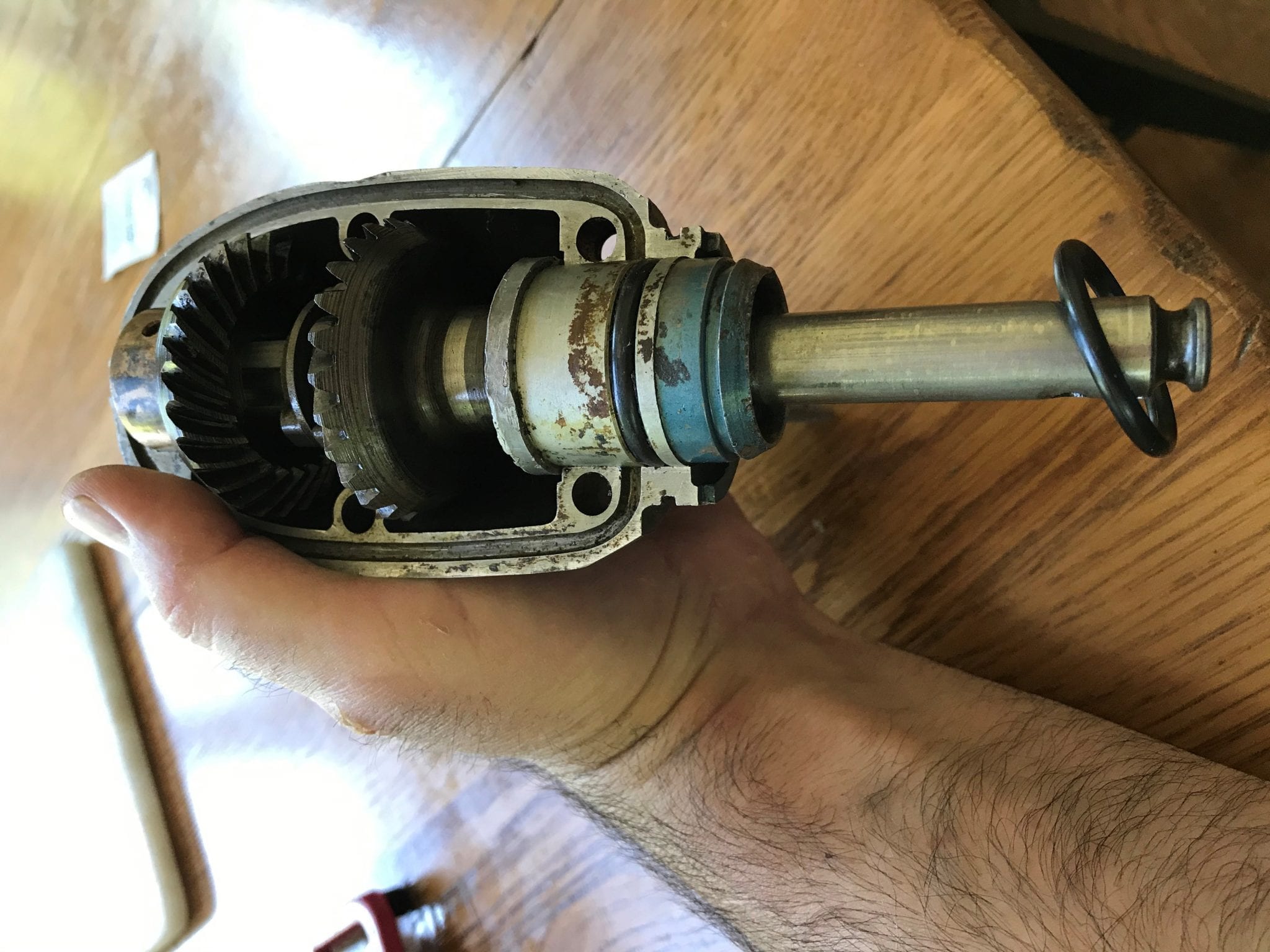

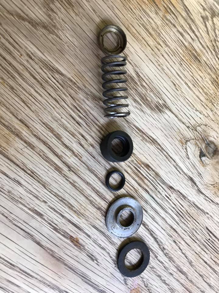

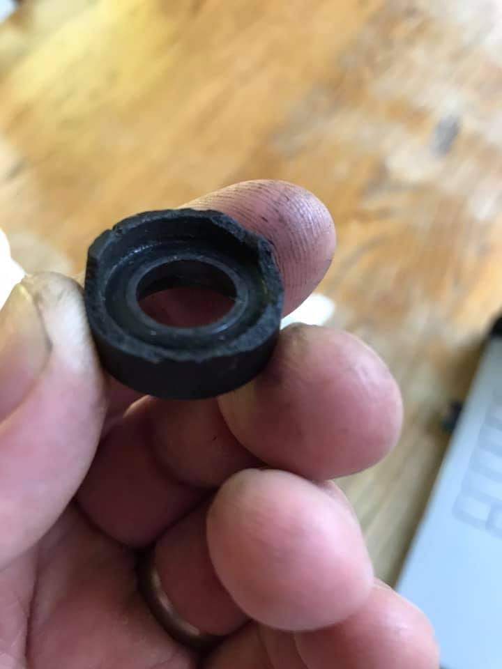

      I am going over all of my parts and working on reassembling my 56, not 57 7.5 Fleetwin, I realized today. I think because Marine Engine only had diagrams for a 57 and I studied them so much, I thought it was a 57 for a bit before I recalled. Anyway, I’ve replaced or rebuilt the carb, ignition, and am finishing up on the gear case (water pump, seals, etc.) and putting that back together to pressure test. But I was looking at what should ride on top of the crank shaft and it appears that my lower bearing seal is damaged or at least part of the ring. Is this superficial damage or will it impact performance? I’m leaning toward paying the $25 plus a few bucks shipping I found one online. But I’m always impressed by those who’ve done this for awhile’s ingenuity in “making parts” or substitutions when appropriate. I know from the first few motors not to do things half butt. But when you can save $25 here and there, why not. Thanks for any thoughts.

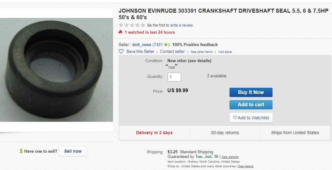

        Yellowstone, New one on ebay for about 1/2 that or someone here might have one for less. Should be replaced as well as the o-ring and gasket.
        https://rb.gy/oh5ihc

                  Yes, that lower seal assembly must be in good condition and properly assembled on top of the driveshaft roll pin. Without it, the powerhead will slowly suck in water over time, and most likely throw a rod eventually….
