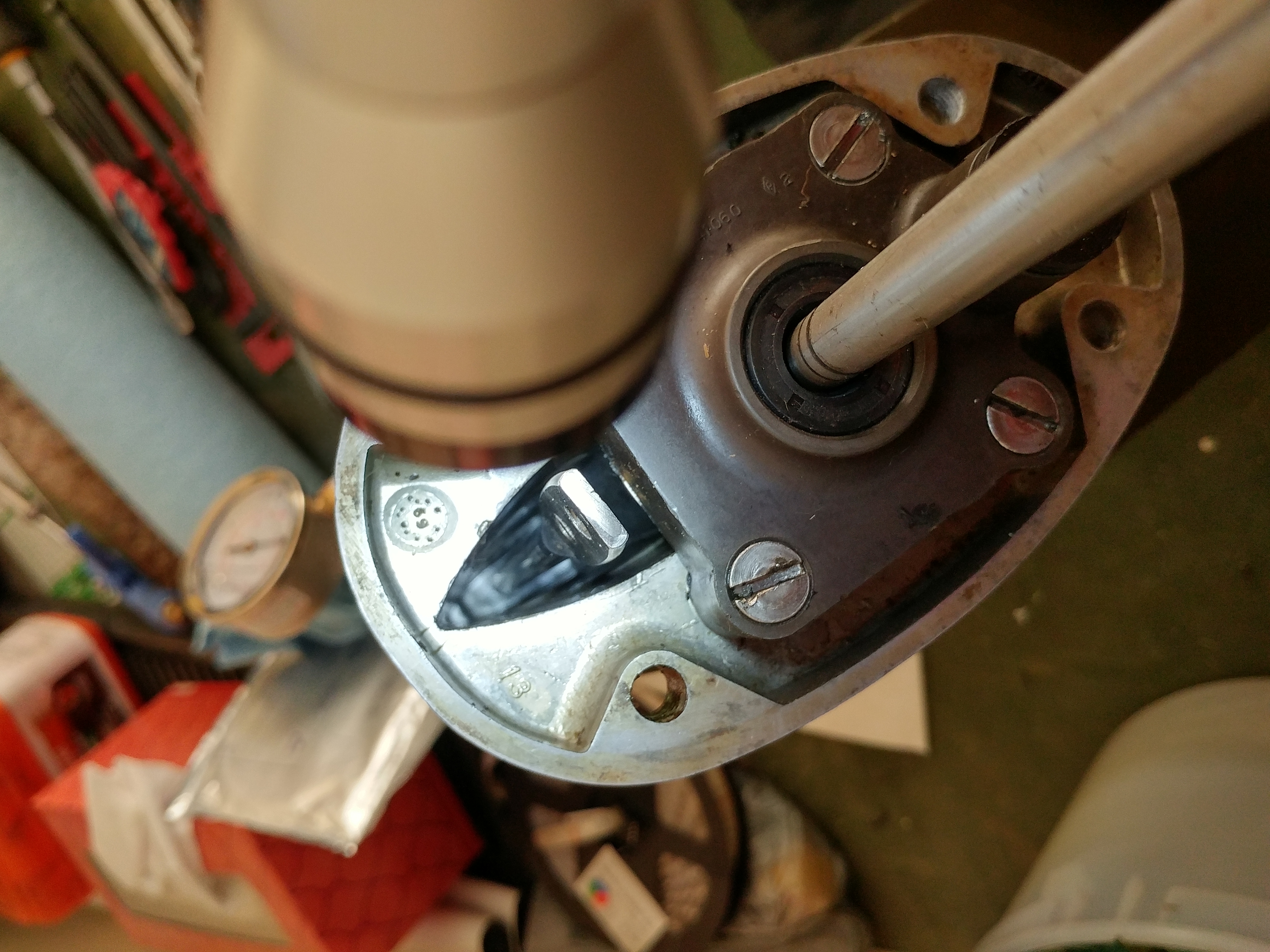

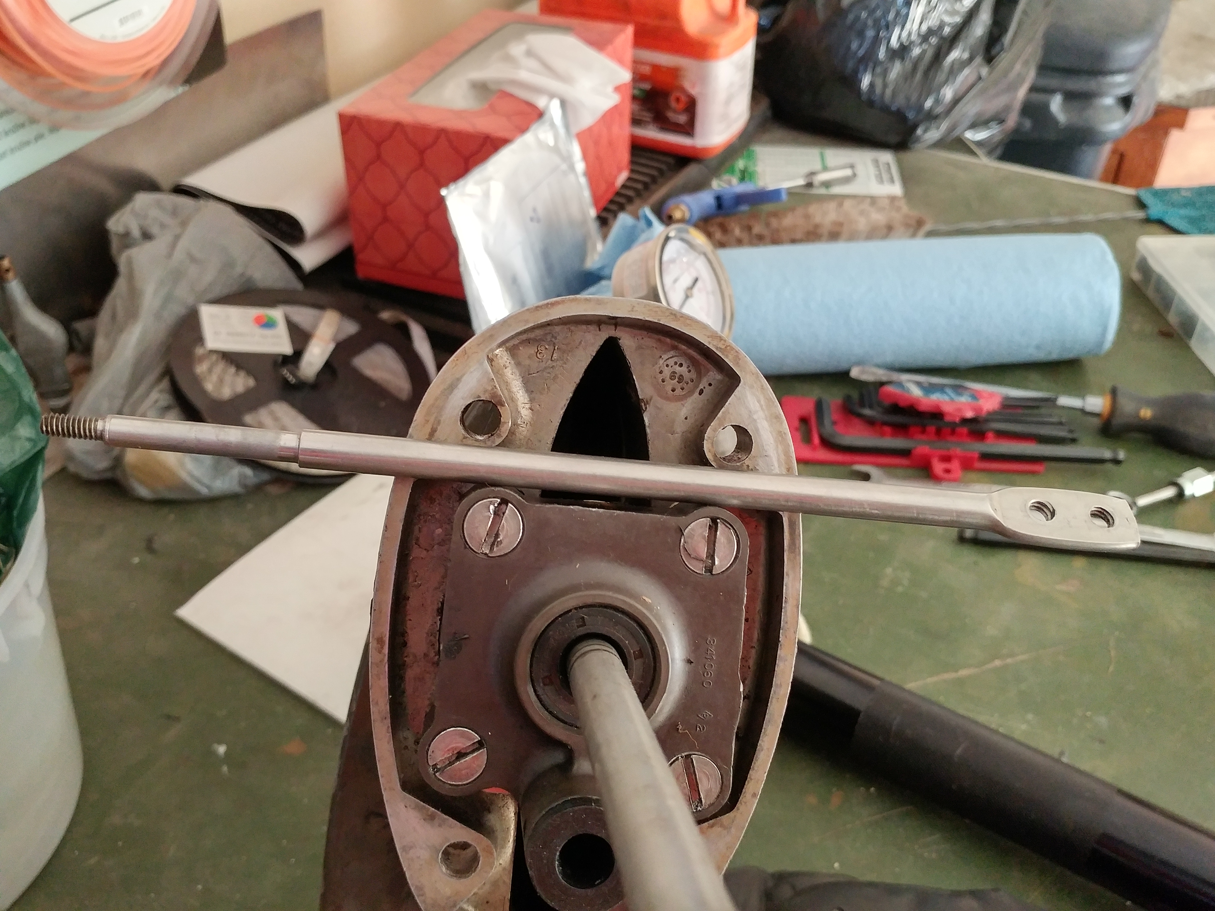

I have older 6 hp Viking eatons of canada. Model 64021 serial 1479. I have done some work to bottom end. Thought should pressure test bottom end before final assembly. When preforming pressure test of 10psi noticed very bad leak down around shifter rod in the area it enters bottom housing. I do not seem to see any sort of means for sealing that area? I do not have manual and have not been able to locate one online. Just wondering if something is missing. Wondering when i bolt bottom end back to motor does it rely on splitline to keep water out?
