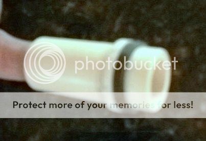

                    jw-in-dixie
                      Fine if you can buy the part new. If not, try a bearing house for equal or similar that you can modify. For Mercs, I have found PVC pipe sections or couplings that I can fit. Here’s another plumbing part that works with some mods. Good luck.
