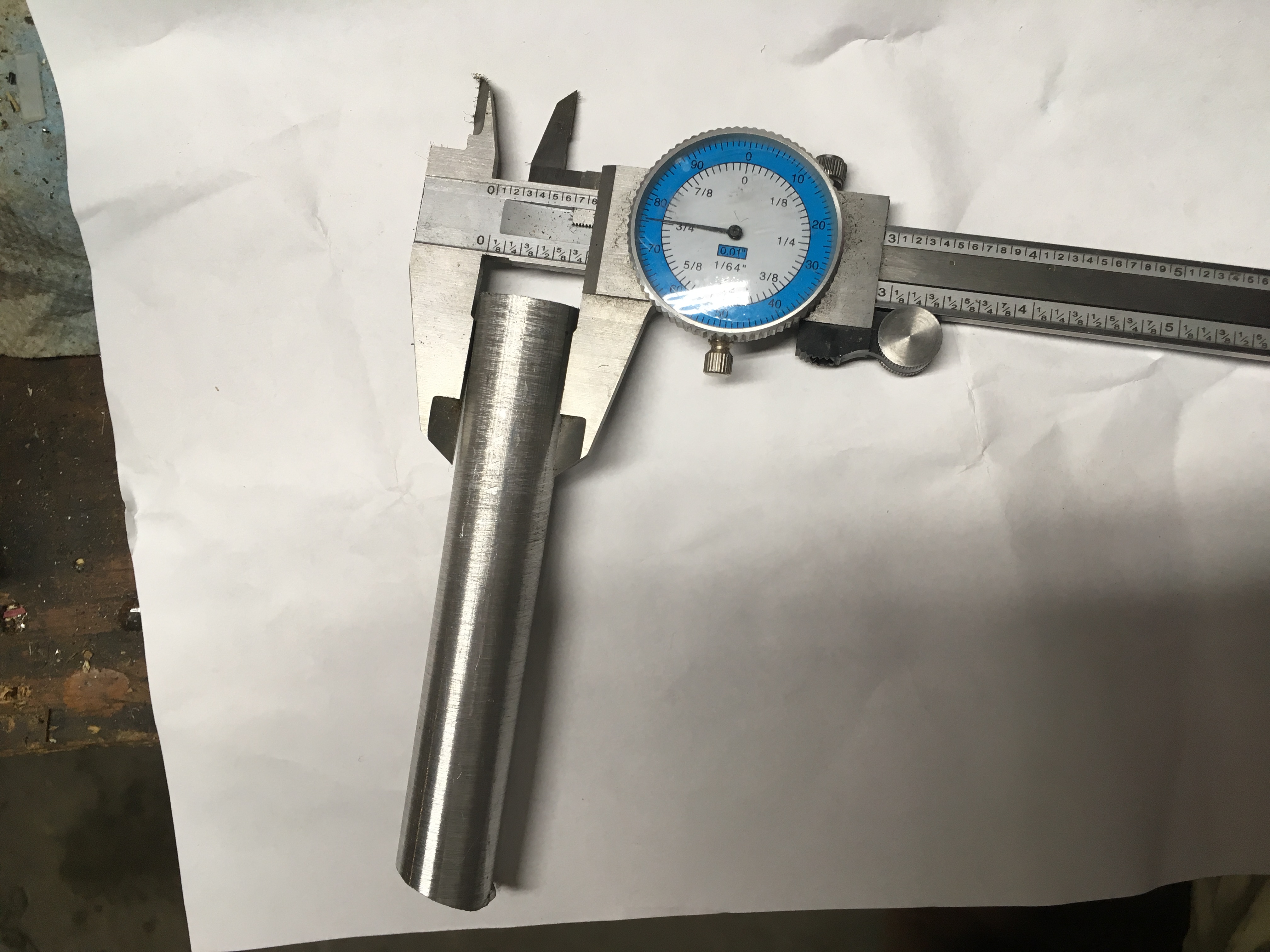

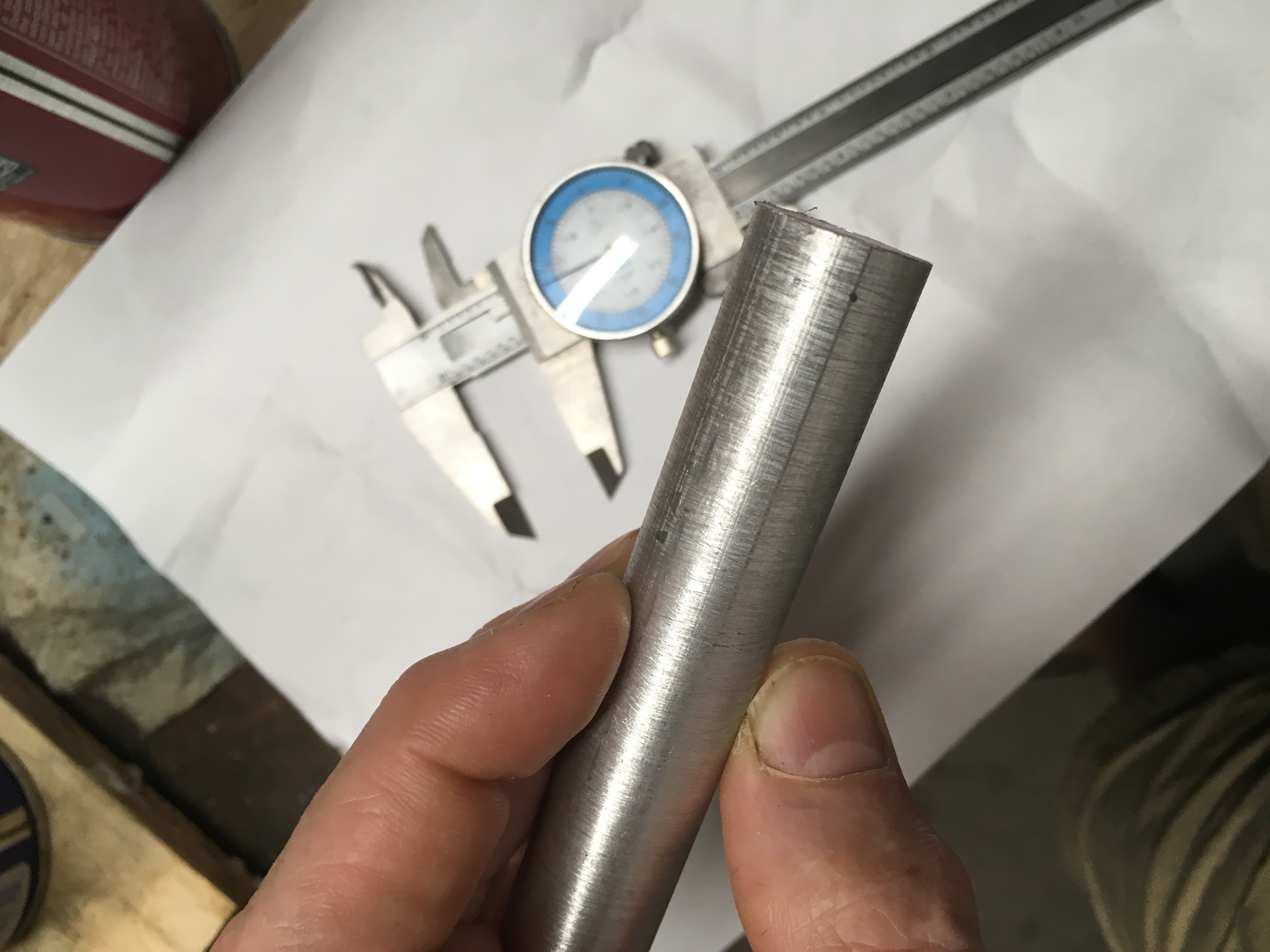

        There is a “plug” that goes in that hole. I had a SpeediTwin that was missing one also and made one from some aluminum round stock. Had to file it down to fit tight then hammer it in and cut off the excess. I got the round stock from McMaster Carr I believe.

            I appreciate the fast replies, and the information. I was leaning towards a plug, but I wasn’t for sure. I have access to a lathe, I’ll turn one down and get it installed!

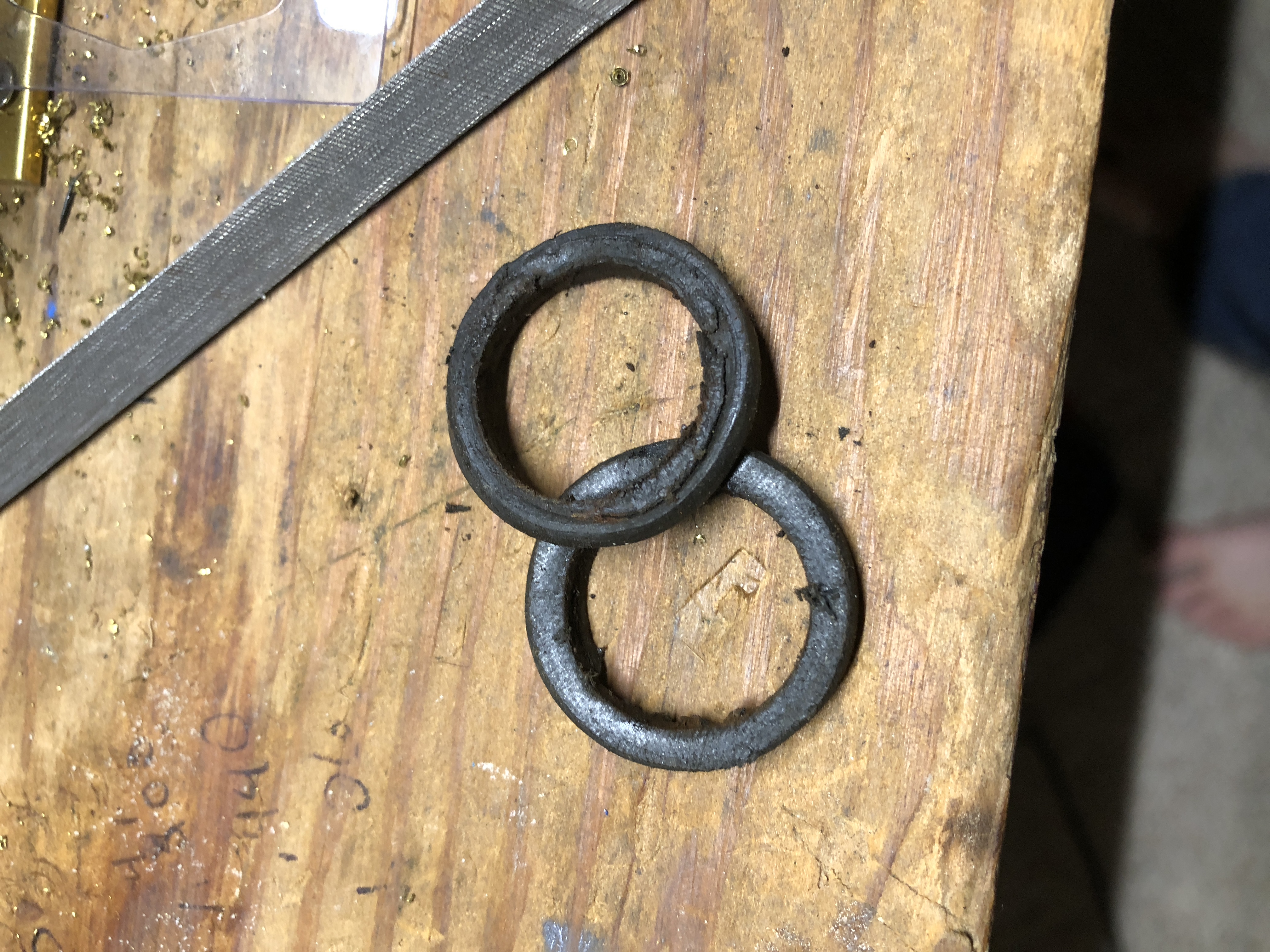

                  These are the two deals that came out of it. At work we use rubber sheet to make gaskets for odd sized flanges, I’m wondering if I can make a couple out of that.
